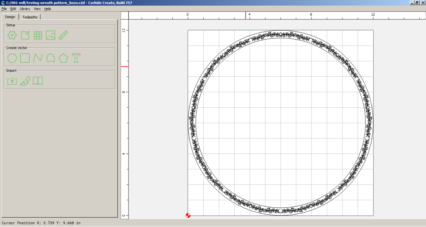

I drew the two circles, took one piece of the wreath and sized it ( did not maintain proportion) to the radius of the track, circular arrayed it with 9 items, select center as the center of the circles. Not sure if this is exactly what you want. Cheers.

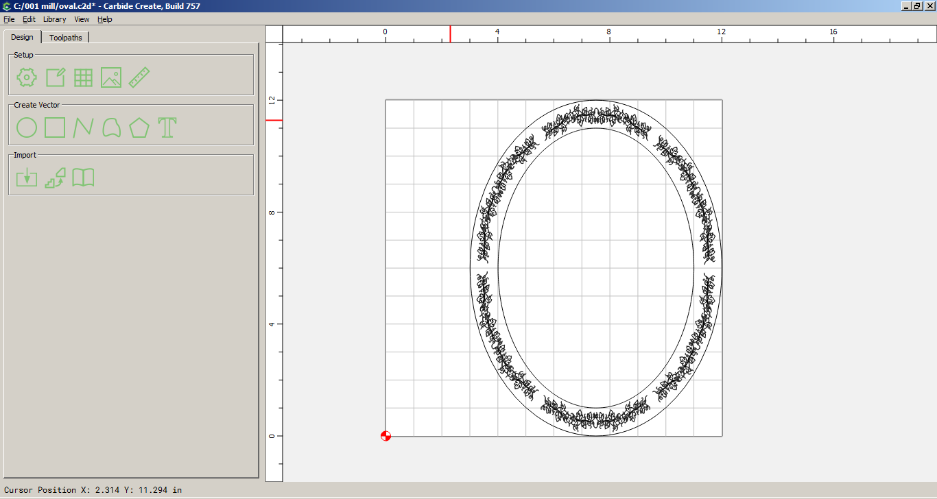

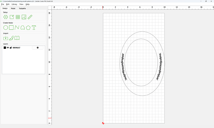

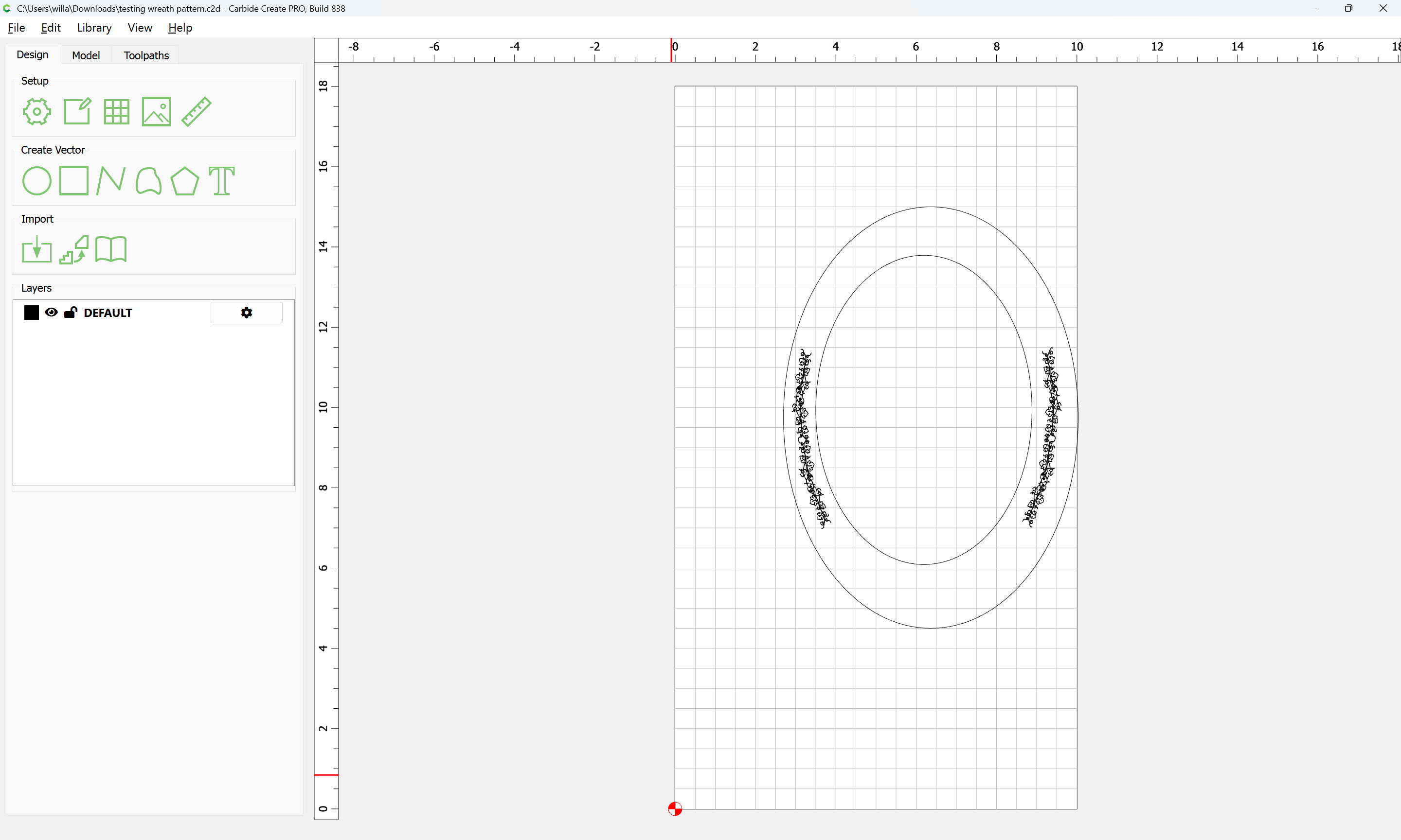

While an arc may be used to create a circle, the provided file indicates an oval:
Oval:

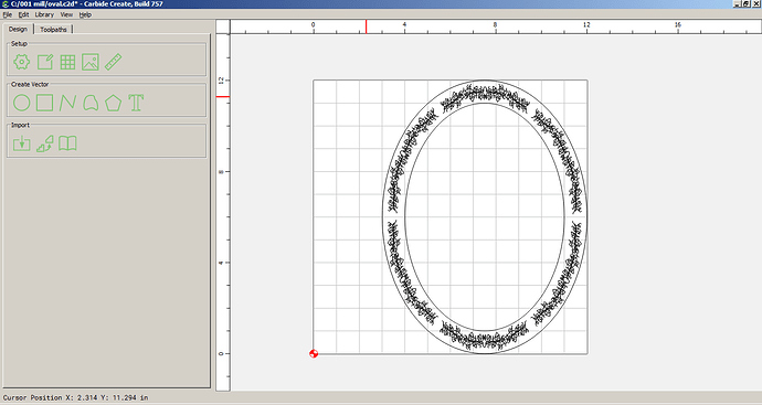

Thank you both for your feedback. I am trying to do an oval for a kids Snow White mirror on the wall type of thing so I will give the suggestions a try.

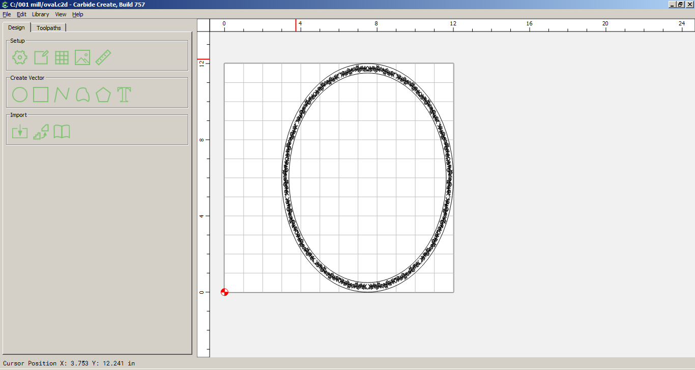

Slightly different version maintaining 1 inch track on the oval.
