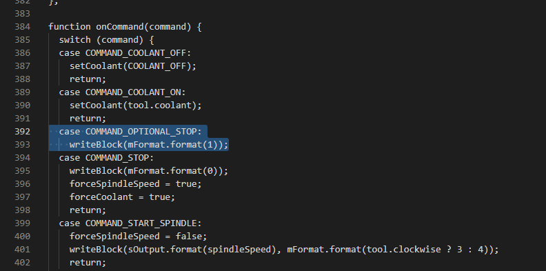

Hey everyone, I thought I’d share something that might help others.
I wanted to pause the program at a certain point and either resume, or cancel it. TLDR I found this was possible in Fusion 360 if I added a Manual NC command of OPTIONAL_STOP. I also had to edit the post processor to output an M1 g code which the shapeoko understands, but which is not in the default carbide 3D grbl post processor. It only took two extra lines of code:
With this in place, the machine will pause when it encounters that Optional Stop command, and can be resumed again using the green “Start” button in Carbide Motion.

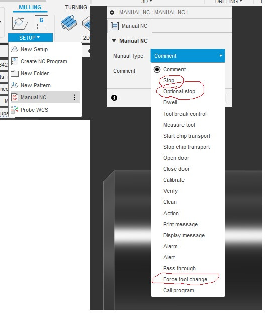

@Tod1d Fusion 360 allows you to add a “Manual NC” command and choose Optional Stop as one of the options. You can just add it into a Setup like you would any other contour toolpath, adaptive toolpath etc.
Ah, ok. Cool. So you program your step-downs as separate paths with a opstop between them?
@Tod1d Yes, that’s right :slight_smile: It can mean a bit of copy and pasting in CAM, but when you get to running the machine it is a much smoother workflow.
