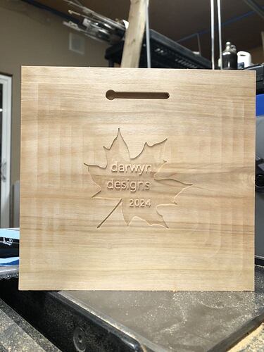

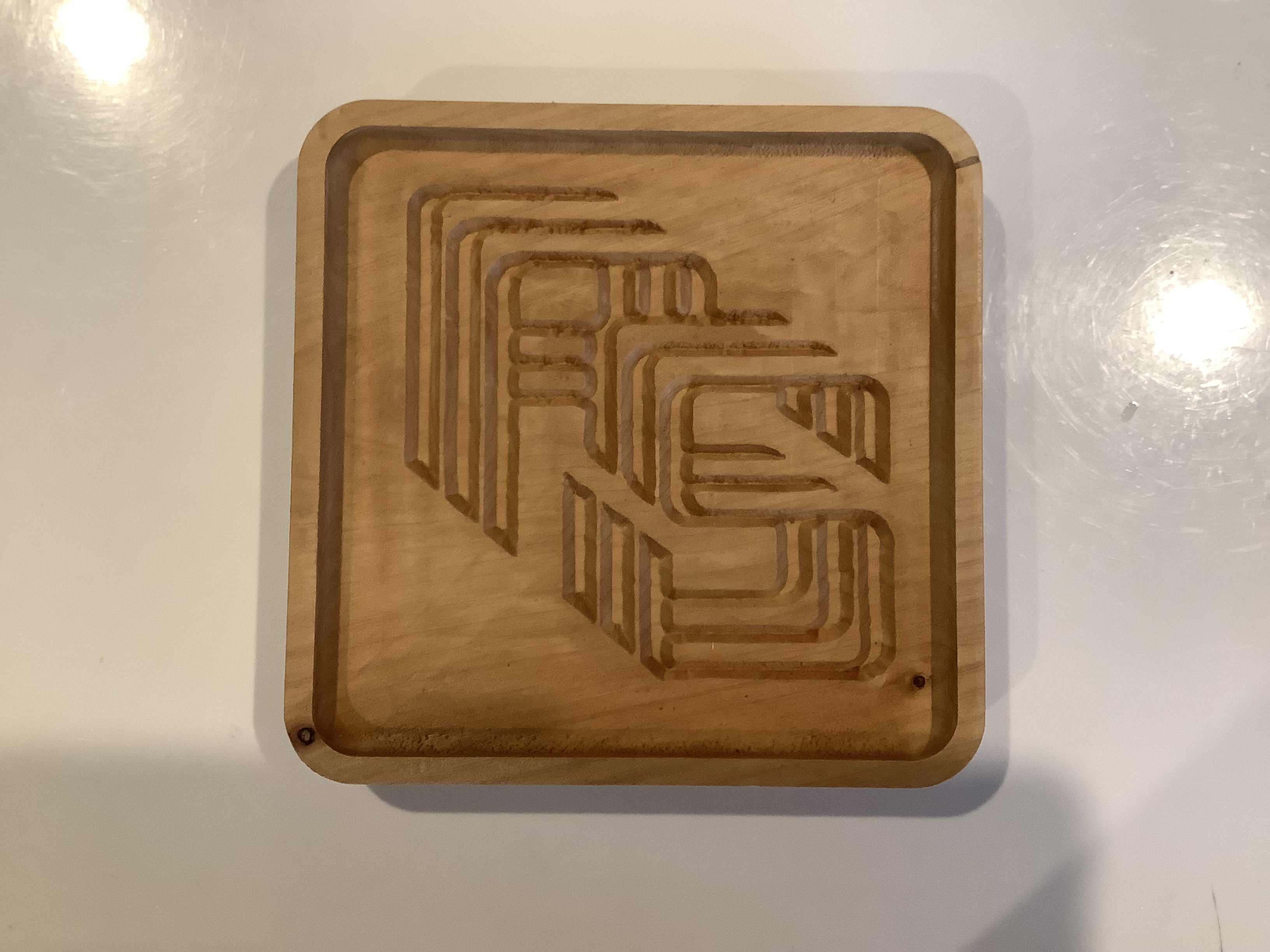

I carve a very shallow pocket (about 0.5mm), using 2mm and 1mm downcut mills. The logo is about 4"x4", takes just a few minutes.

My machine (5 Pro) is relatively new and I have not yet played with 1/16 inch bits. I am surprised as to how nice those raised letters came out! For a generic tag I need to definitely try someone like that out … How does this type of logo look if you stained your wood?

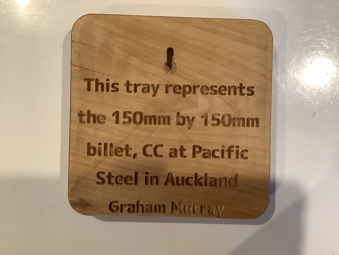

Also for your keyhole hanger, did you first mill the slot with a downcut mill and then plunge in a keyhole bit and following along the slot?
For darker stains, the logo is a bit harder to see, but it’s still legible. Lighter or clear-coat is just fine.
For the keyhole, I just use a keyhole bit by itself, with the ‘Keyhole’ toolpath in Carbide Create. This is the one I am using right now:

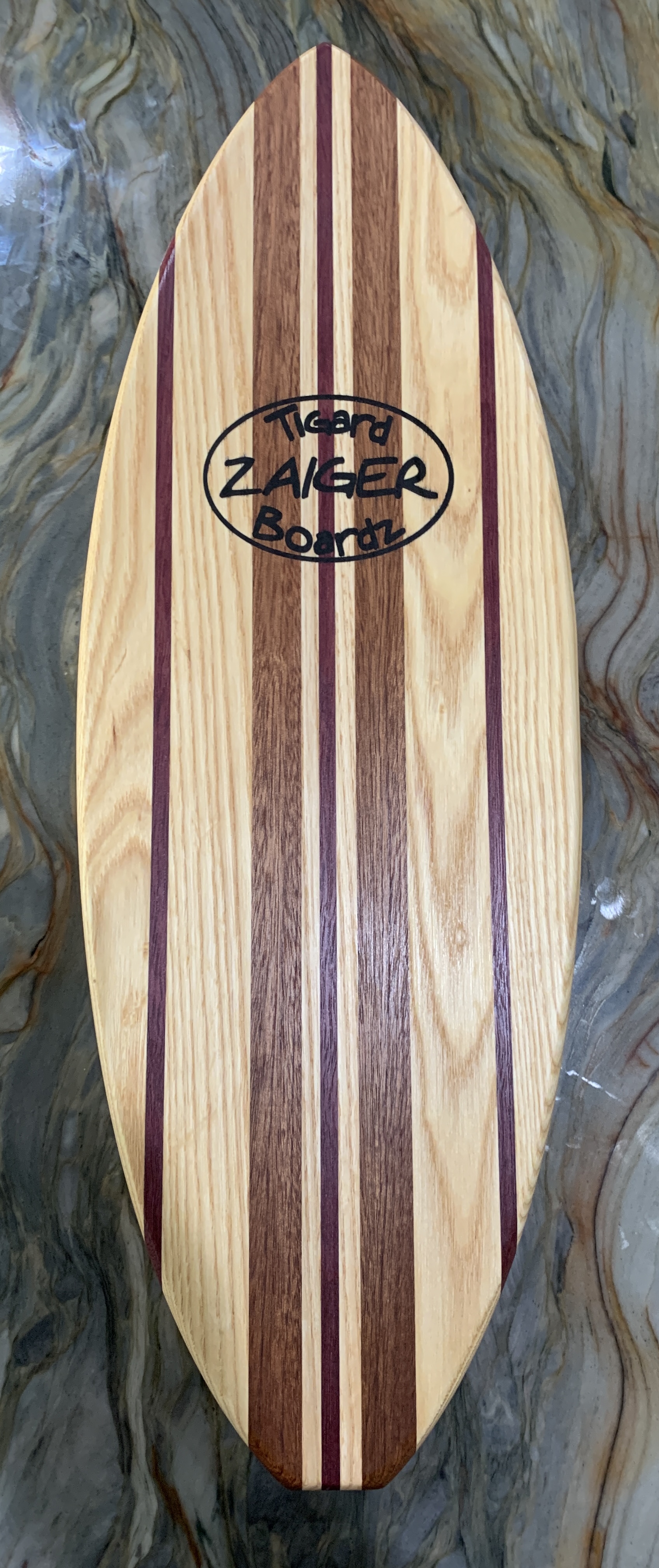

Laser, always the laser. My logo goes on the back and any sentiment that is warranted by me or the customer.

What laser device do you have ?
I have an attachment to a 3D printer with too small a footprint.
How do you seal the sintered area ?
Thanks !
I have a JTech 7 watt laser attached (removeable) to my router bracket. I usually use 60% power, 20 ipm speed and a single pass.
JTech Laser Mounting
I draw laser lines before any finish is put on. They are self-sealing, but whatever I use to finish my project is on top of the laser cut.
