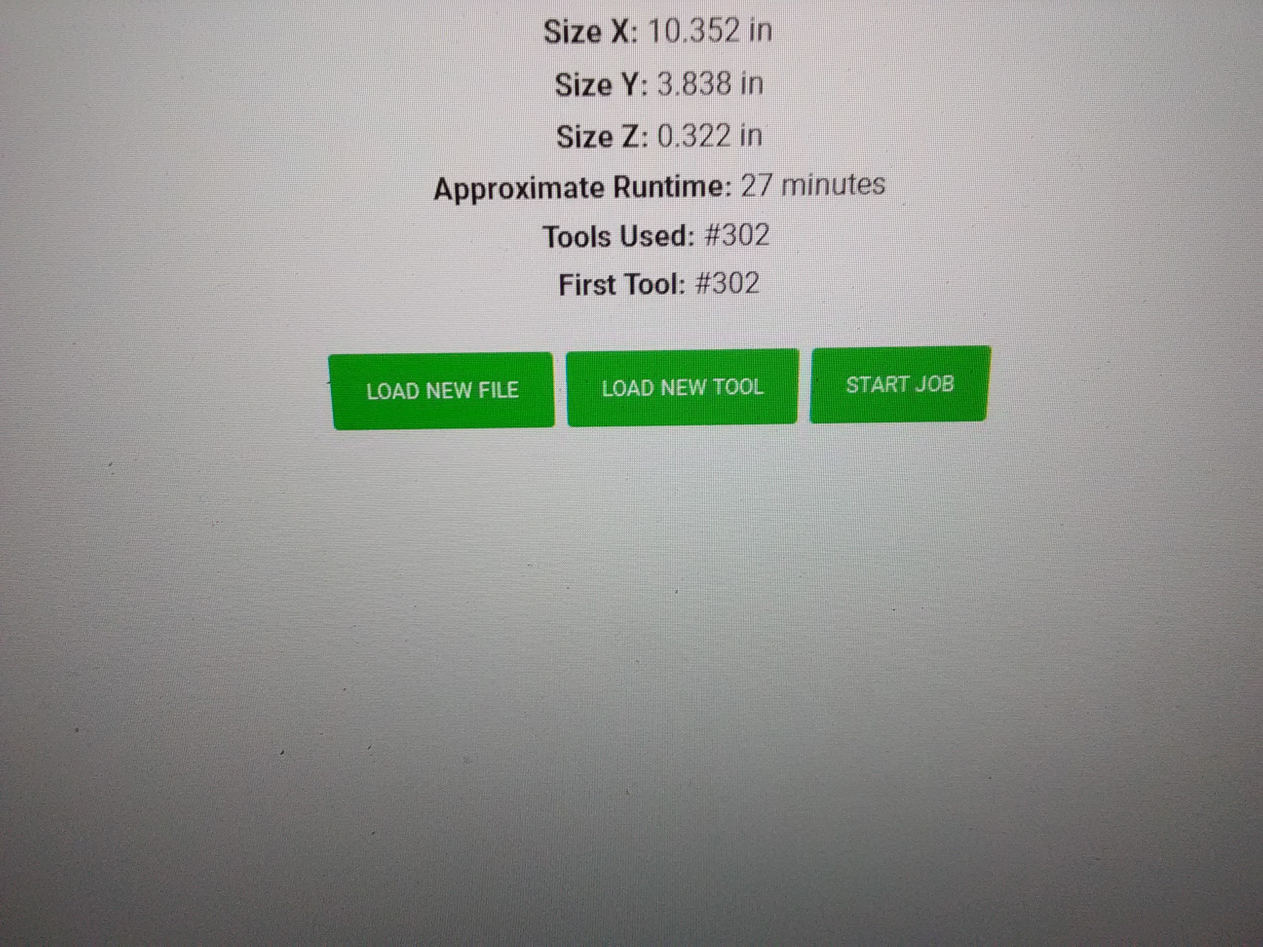

The 2 pictures show projects created in Carbide Create. One in an earlies version which shows multiple tools. The other was created in the latest version of Carbide Create and loaded into Carbide Motion build 521. It has 2 tools but the program shows only one and it wants me to load the second tool in the project. Any ideas?

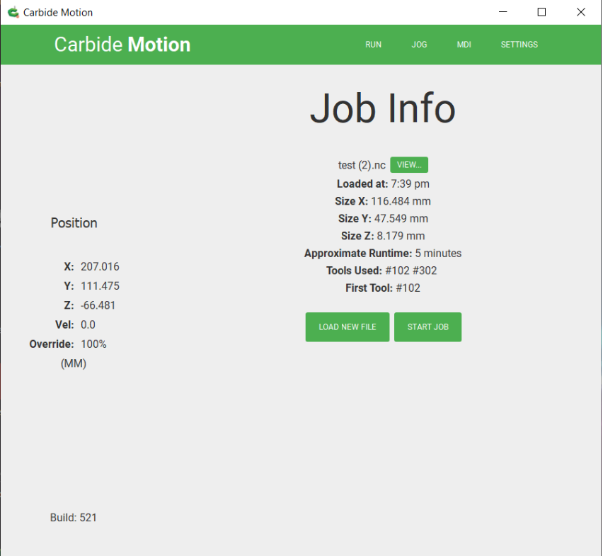

I tried loading the test.nc file you attached above, in CM 521, and it works as expected here:
but also has a different cut time and units. Any chance you might have two files with the same name and used one in CM but uploaded the other here ?

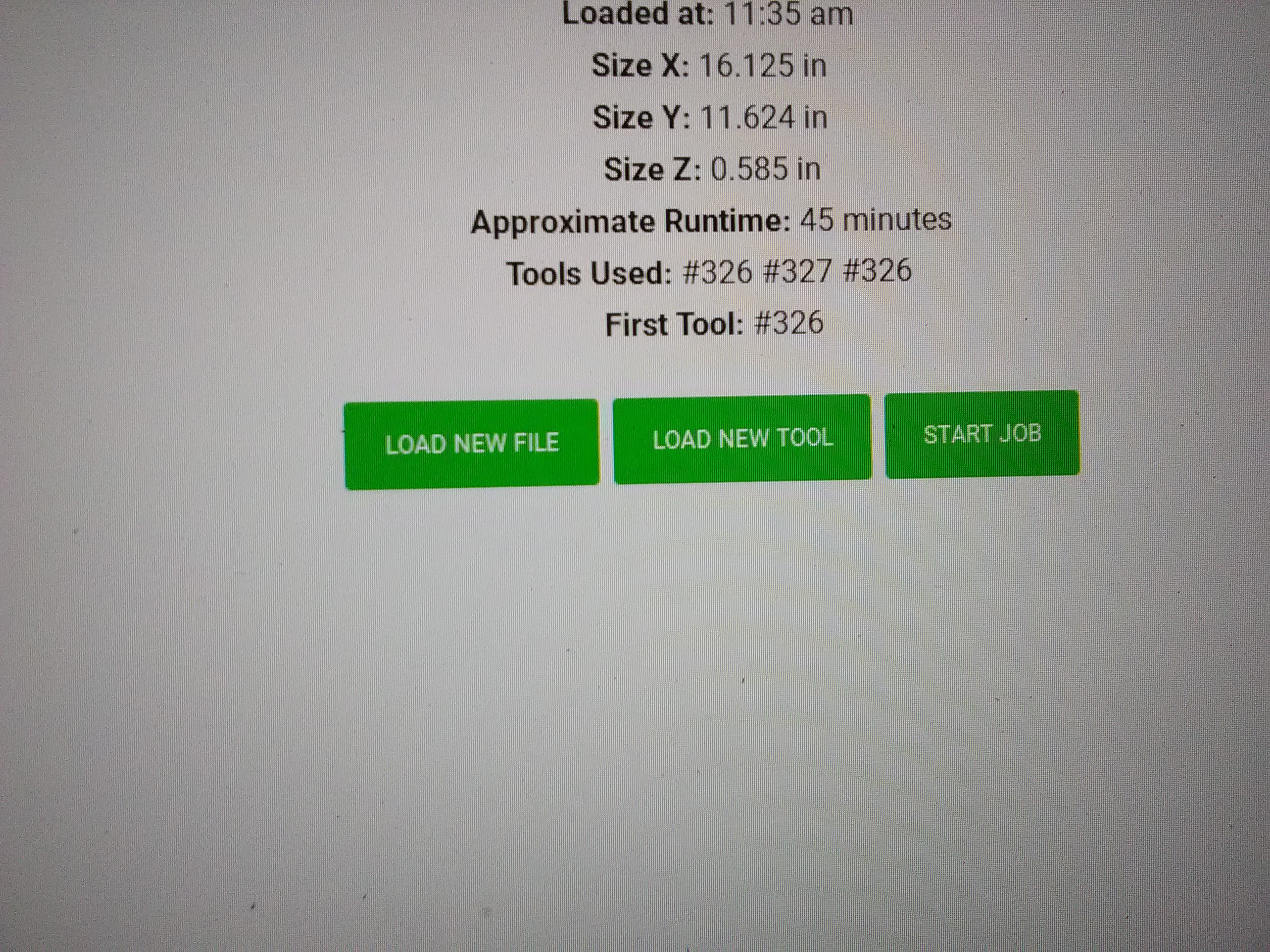

Hi Thomas, I think I’m having the same issue. I’ve tried it a couple of times now but I haven’t yet documented it for this forum. I’m using CC 514 and CM 521. Did you ever get a successful resolution for this?
