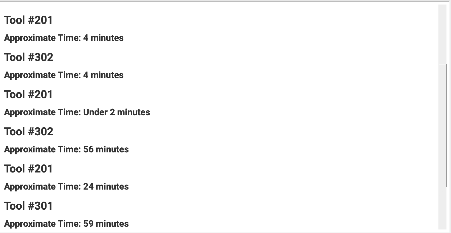

I’m not sure if this belongs in Carbide Motion or Carbide Create. I’m running build 566 of Motion and 757 of CC Pro. I have a large cutout to do that’s all advanced v-carve. Between each step, it’s having me swap tools. Is there any way I can get all my pockets cut and then only have to do one tool change to the v-carving? This will take a long time and it seems like it should be better optimized to reduce tool changes. Thanks for the help!

It should be toggled on every other operation. Looks like you have 3 operations (6 tools) listed above.
Just toggle the 2nd operation. This should reduce from 5 tool changes to 2.

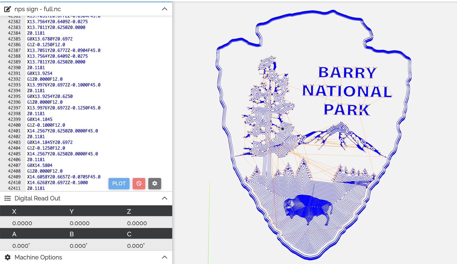

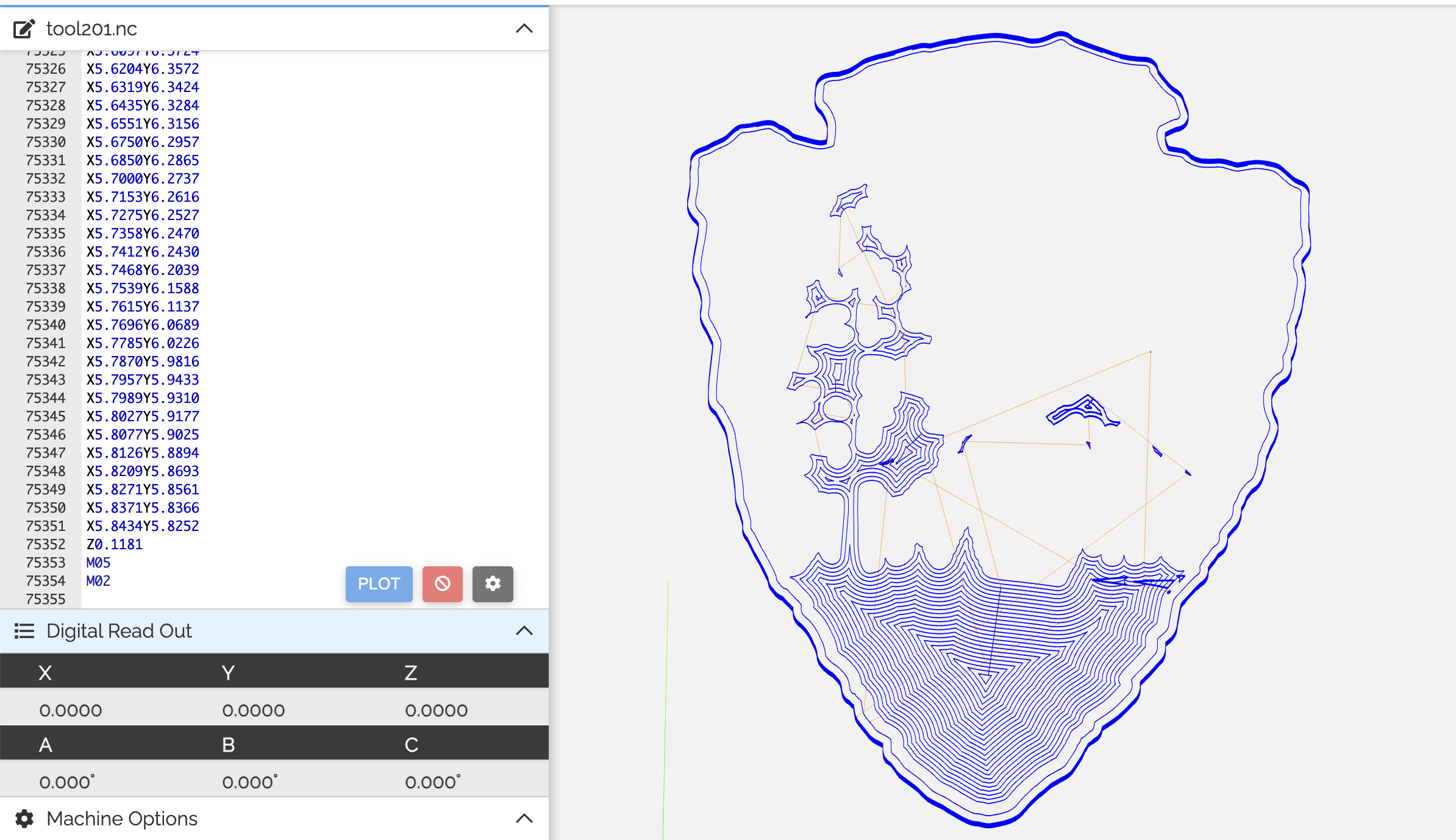

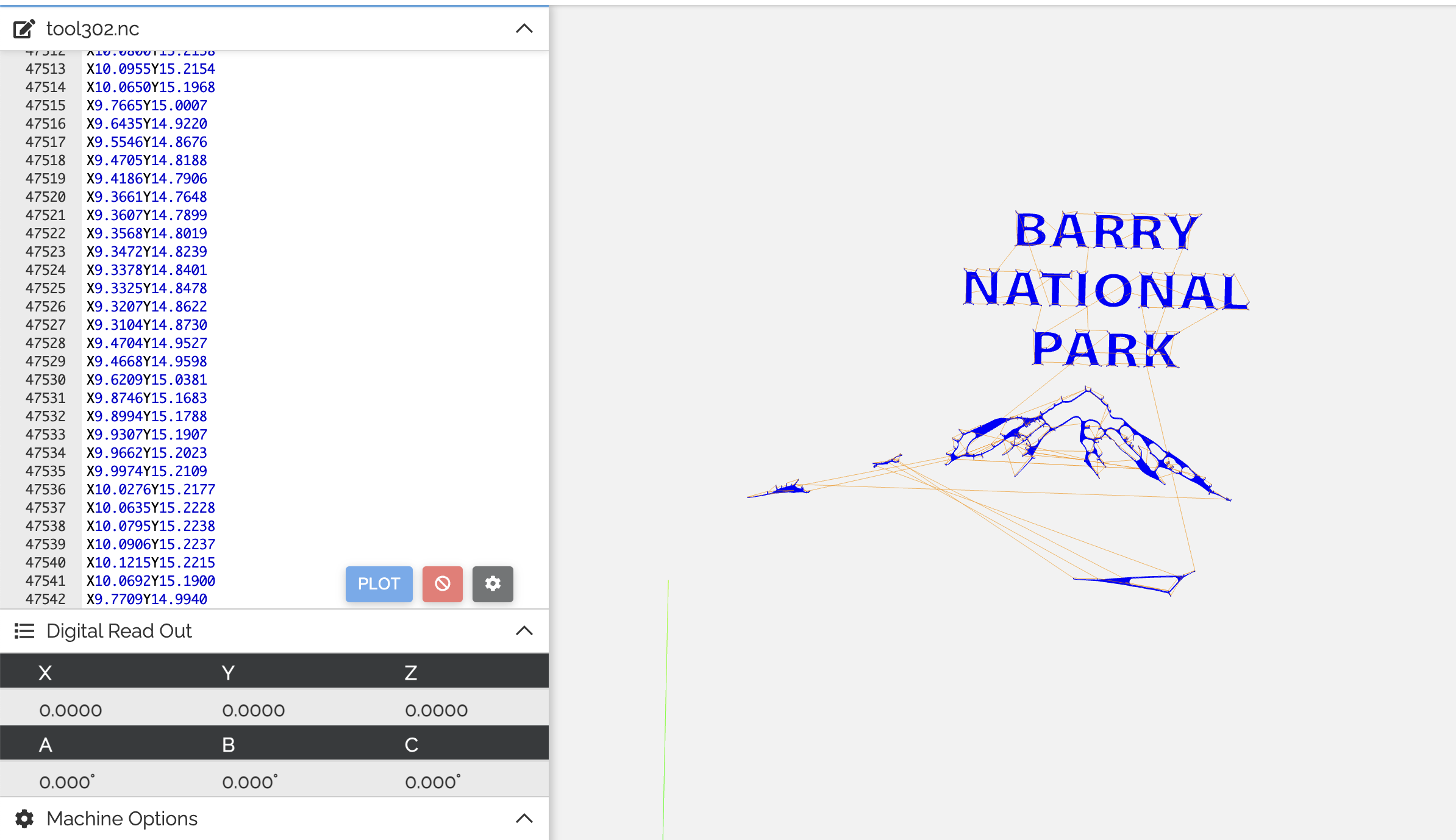

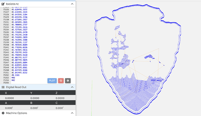

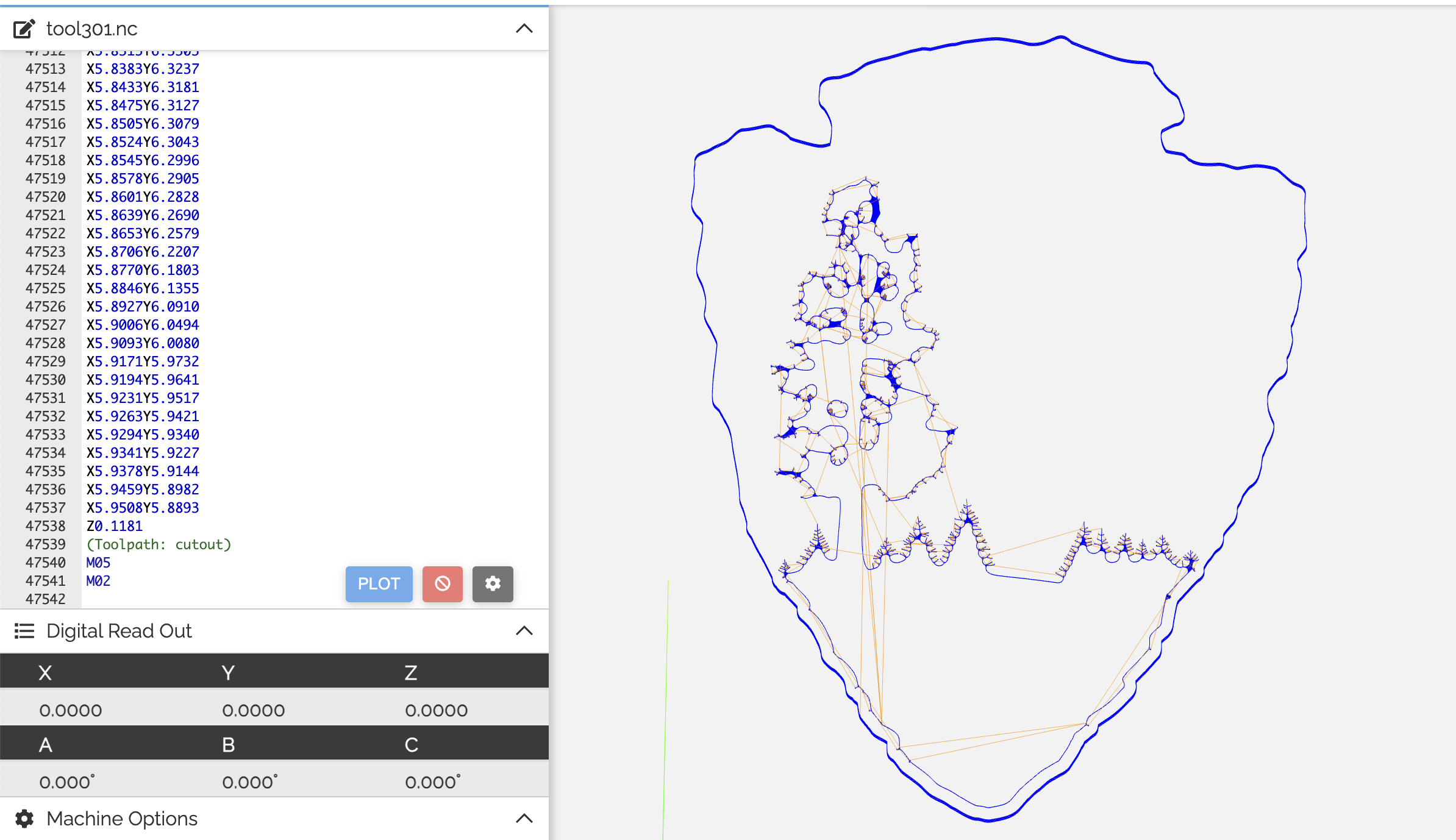

Those links were very helpful. Thank you! I wrote some Python code to identify all the paths (Toolpath: path name) along with associated M05 and M6T lines for tool changes and validated it with the viewer. The GitHub code was still outputting a lot of files. My code is now outputting a file per tool and it looks perfect in the viewer. Now for a test cut!

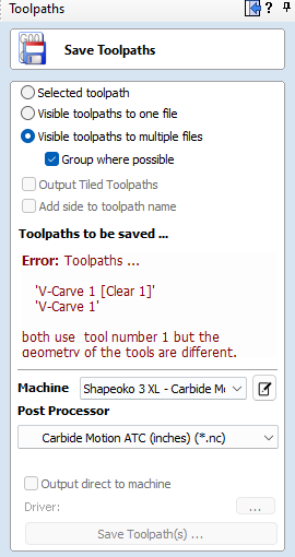

Vectric has the ability to combine toolpaths based on the selected tool.
Odd. I expected it to output 2 files if there were only 2 tools. It still outputs 6.
There is an option at the bottom to " Split the file at each toolpath", but even with that unchecked it still outputs 6 files.

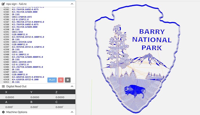

Following up with some promising development… Using the NC visualizer @Tod1d referenced along with some Python coding, I think I was able to split the files up by tool. This gave me 3 files (one per tool). I have to connect it to my machine and see how long it will take to process (at work now so it will have to wait a bit) each file. The paths look correct though, so if it works I’m pretty excited about it.

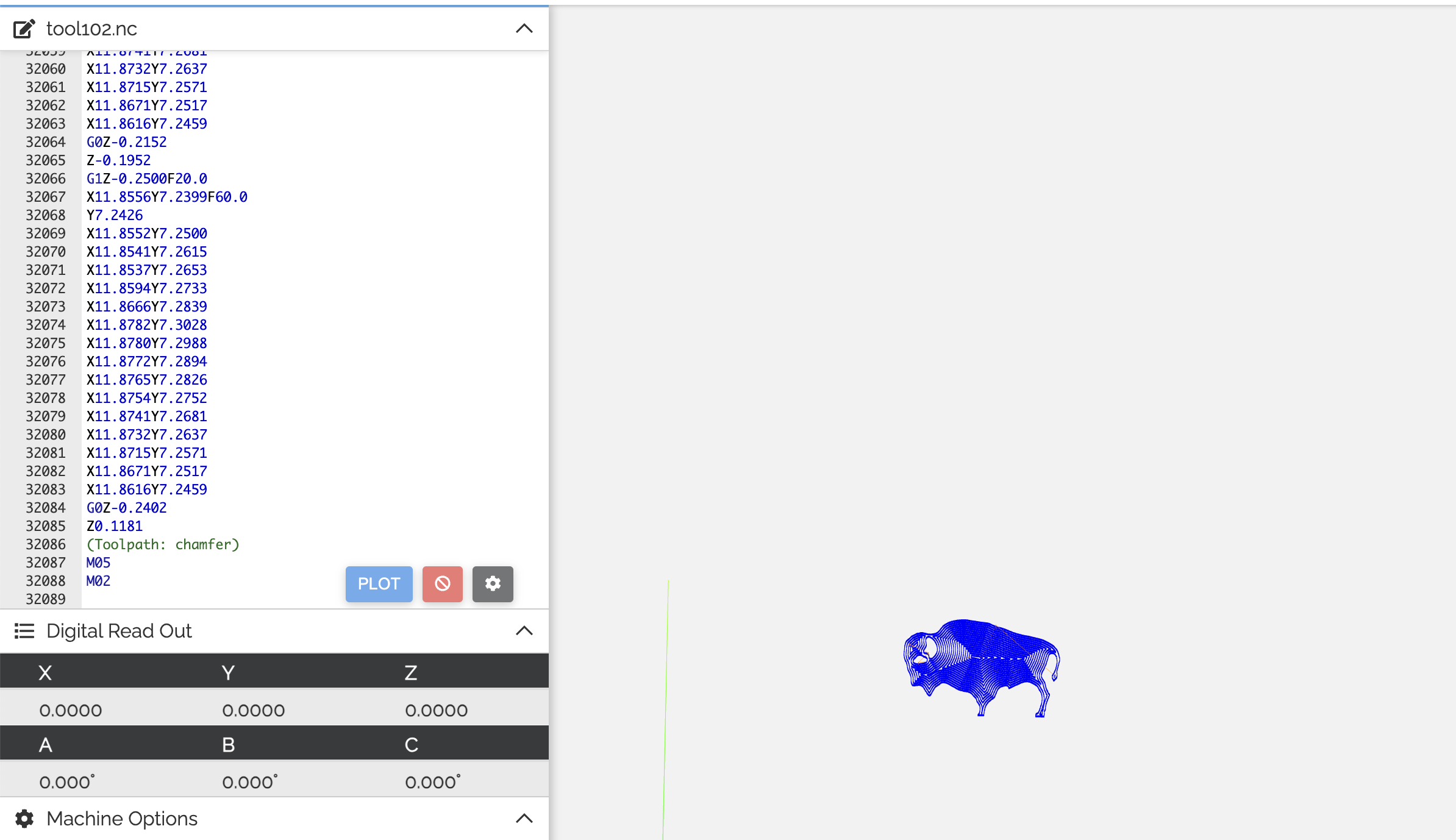

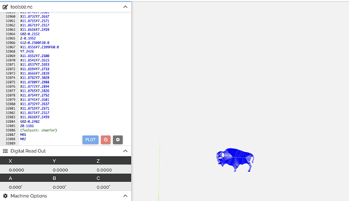

Edit: Just noticed that the buffalo is missing. I left that tool (a #102) off my list of tools to process. Shows that the code will successfully skip tools (it’s a feature, not a bug! :wink:. Adding it now as well.
