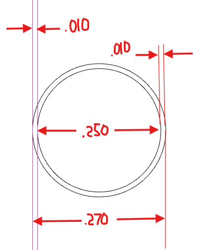

I don’t understand how telling the machine it is using a 0.270" end mill but cutting with a 0.250" end mill results in 0.010" remaining on the wall. The difference between the two sizes is 0.020". How do we get to 0.01"?
Thanks
0.010" on each side. It’s round!!! :wink: :laughing:
Sorry, Tod. I still don’t get it. Is it because the bit has two flutes or something like that?
Regards

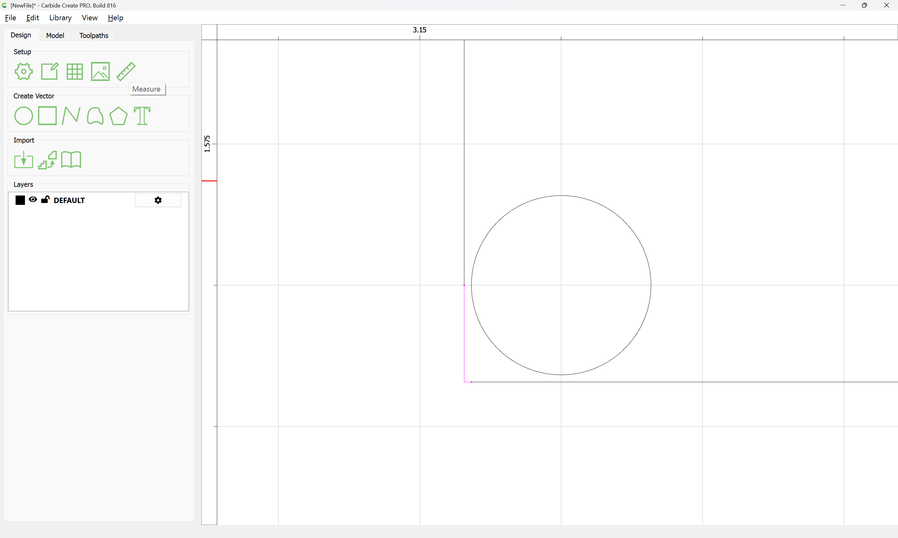

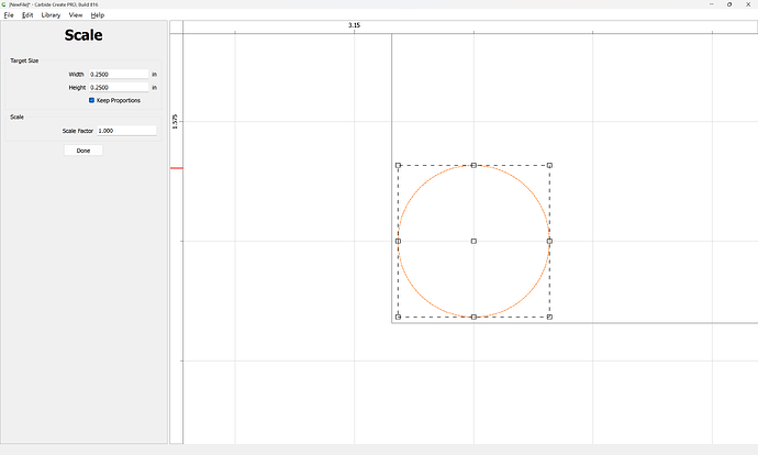

Whenever I have trouble grasping how a cut will work out, I draw it up in profile or as viewed from overhead.

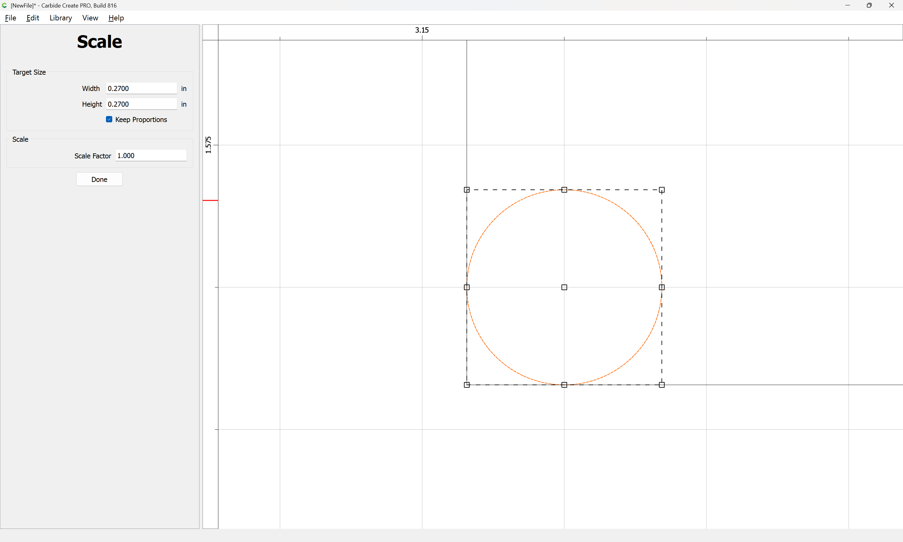

For this case, an 0.27" tool is positioned to cut into a corner:

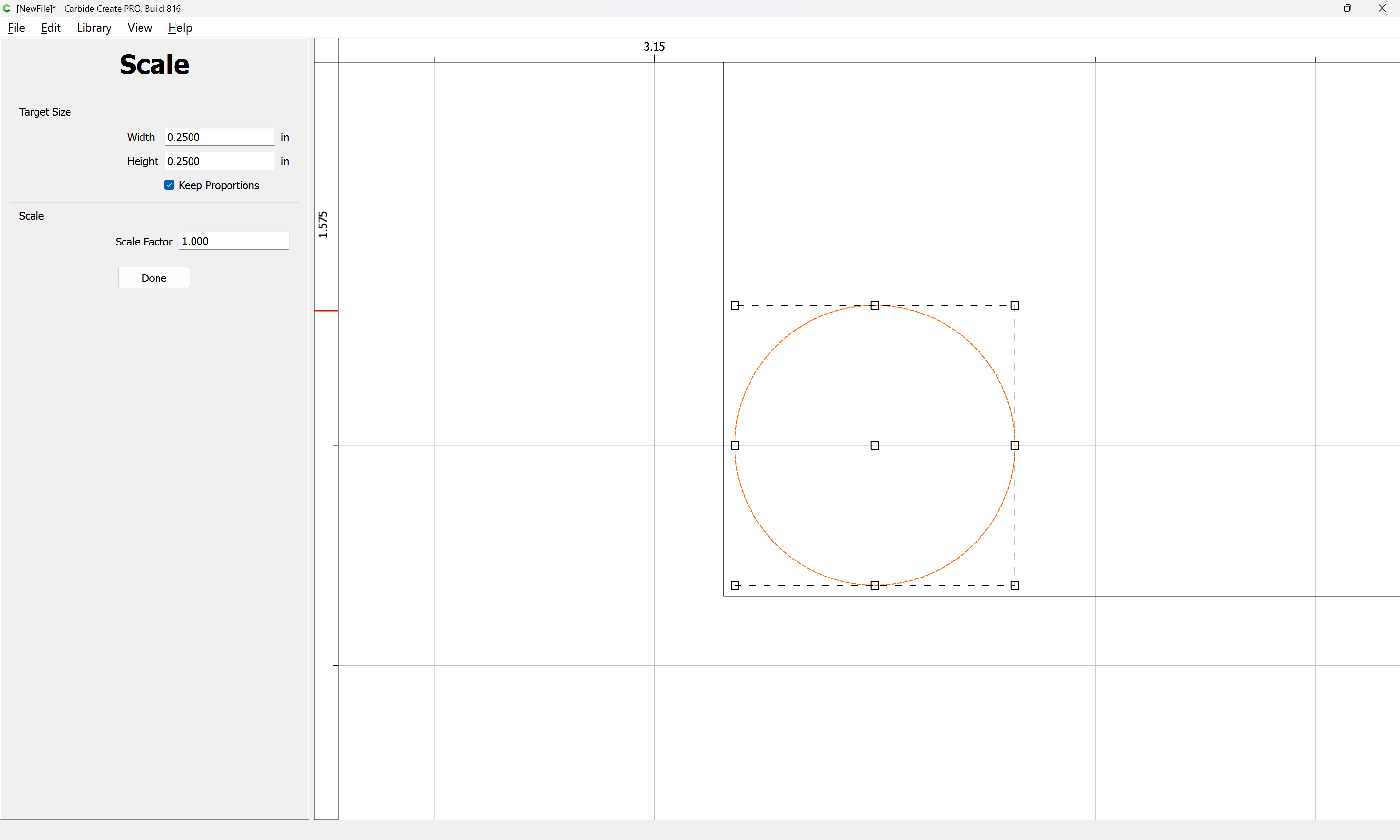

If we then change its diameter to an 0.25" too:

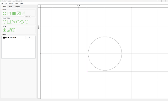

and measure the gap:

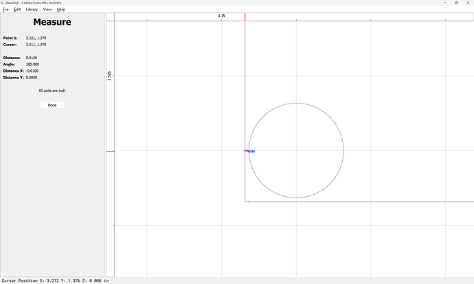

we see that it has opened up to 0.01"

If the diameter is 0.020 bigger, the radius is 0.010 bigger. It only cuts on one side…
AHHH, I did not think about the radius. Got it! Thanks so much.
