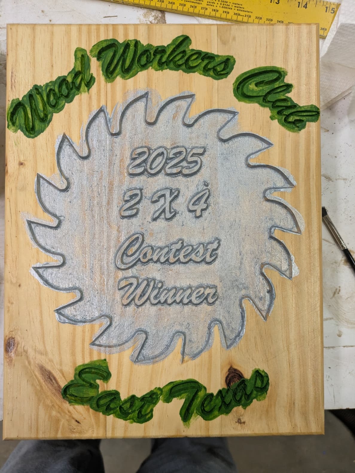

I have a Shapeoko 3 XXL with HDZ. I cut a plaque today and had a smaller version of what you had. Vee bits need to have a sharp point. Some come from the factory with a rounded nose or dropping or the bit rattling around in a drawer can take off that sharp point. If the nose of the vee bit is not pointy the BitSetter thinks the bit hitting a sharp point but is making the vee bit cut deeper because the rounded point is interpreted as a sharp point so the geometry of the bit is off.
Check that your vee bit is really pointed and not rounded. A magnifying glass help.
If you download my photo and look around the edges of the lettering you see a similar problem you have but just not as bad.
