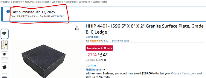

So with a proper surface I was able to get my spindle trammed in to within 0.001" in under 20 minutes. So for those who feel like buying one of this tramming jigs just buy a surface plate. Here is the plate and jig I used:
https://www.amazon.com/dp/B08BXMRRKC
https://www.amazon.com/SST-Mini-Lathe-Adjustable-Tramming/dp/B084GDD7WN
Only real complaint was due to the thickness of the surface plate I had to move the indicators to the inner holes on the jig so they would clear the underside of the Z axis. This reduces the accuracy by a little bit, but like I said I am not chasing Zeros.

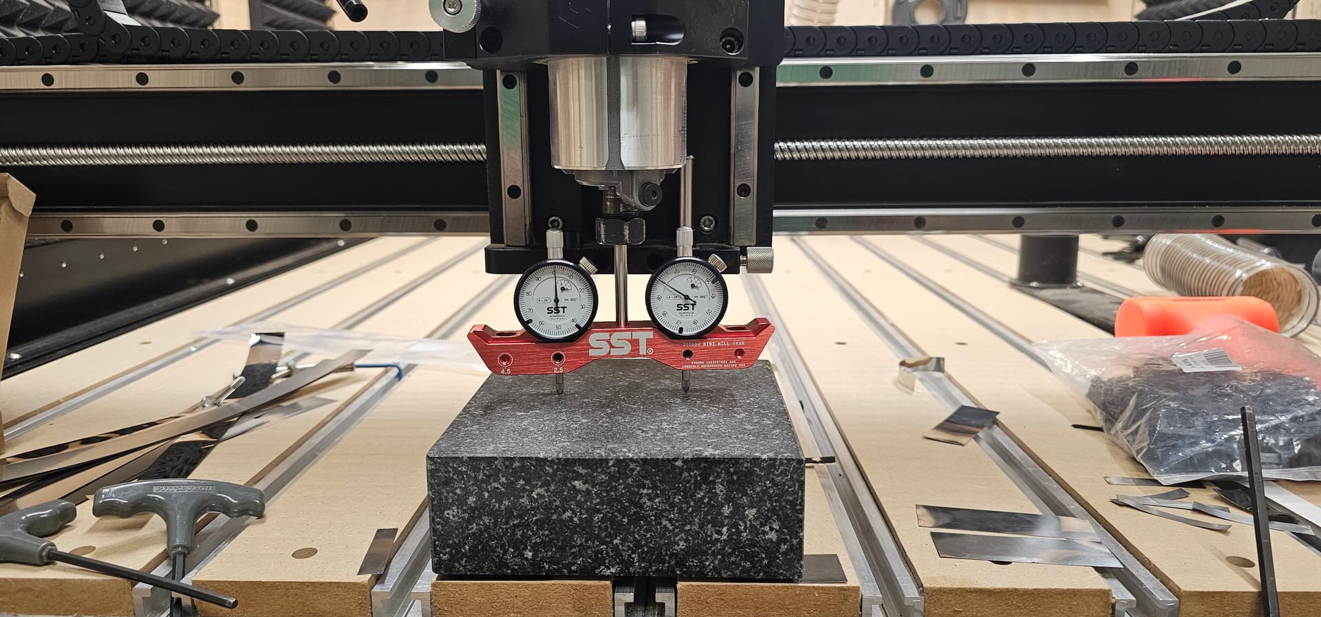

In case you are curious this is what my setup looked like before I broke it down:
Note the very slight clearance issue preventing me from using the 4.5" spacing on the tramming jig. With a shorter reference surface that isnt an issue.
So this may be overkill but after we tram, we resurface the waste board…and the idea is you are truly trying to tram to the frame because the hybrid table is just layers between the frame and the spindle right? What if you removed the 2 mdf slats and the aluminum rail and set the granite block directly on the crossframe member? would that be beneficial and give the clearance needed? My fear with doing 2.5" and being that high up, are you too close to the pivot point to truly capture deviations that matter. I would think you would want to be as far away from the pivot point as possible to get the best tram results. Probably overthinking it and trying to chase zeroes as someone called it.
