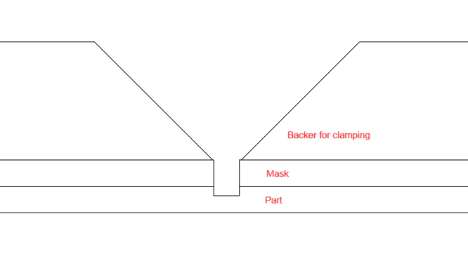

Best bet I can think of is to mask it with a harder material so the burr has nowhere to go.
6061 aluminum, or even acrylic.
Thanks for the idea. I’ll see if I can figure out a way to do that. The part is a little complicated near these slots, so I may have to create a custom mask.

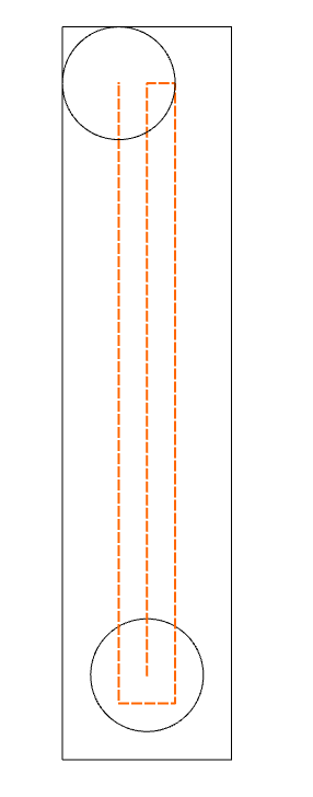

If you have a smaller cutter, or you can make the slot just a bit bigger, you can create your own toolpath & follow it. I would clear out the middle, then contour both sides conventional cutting.
This is exaggerated… The lines will be much closer together. And you’ll want to simulate it at the slowest speed to see which direction it’s going. (The tool will display at the end of the path when it’s done)
