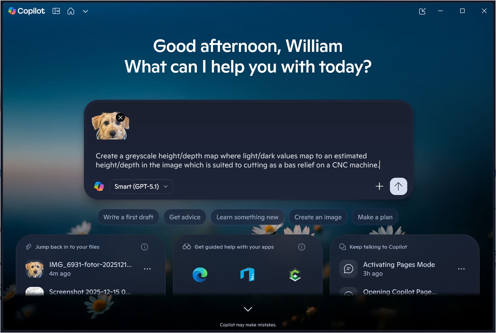

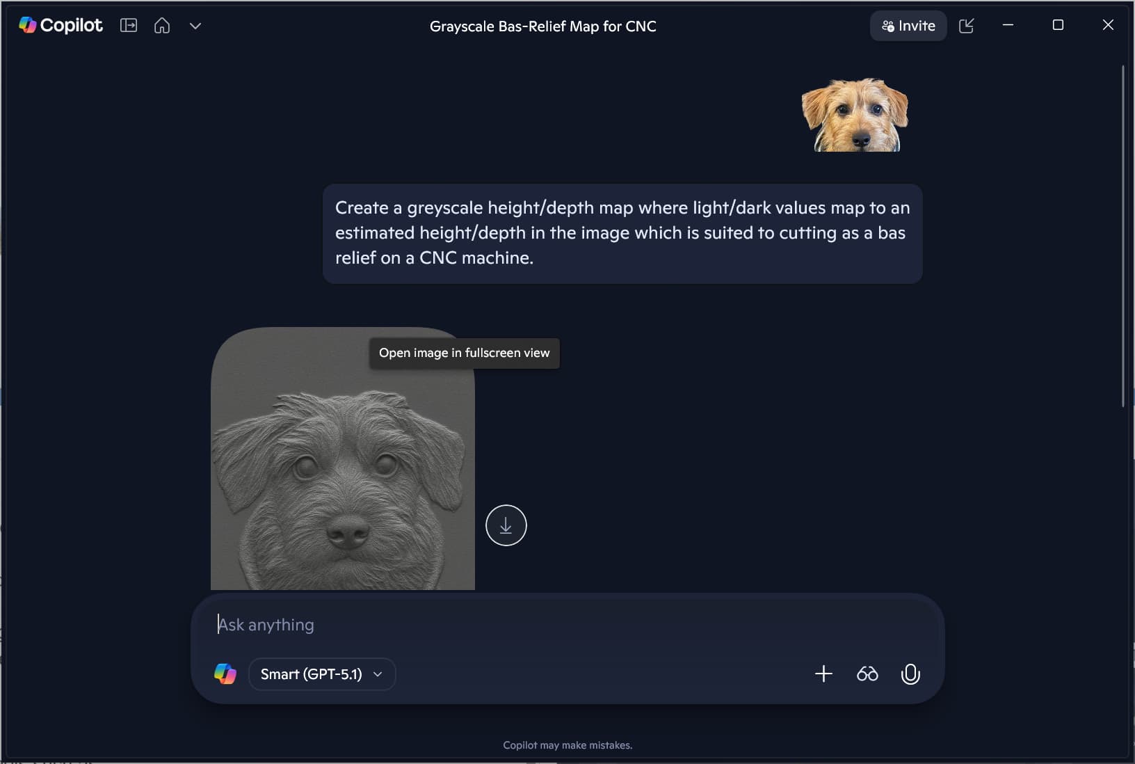

The pixel image was loaded into Copilot, and prompt written:
Create a greyscale height/depth map where light/dark values map to an estimated height/depth in the image which is suited to cutting as a bas relief on a CNC machine.

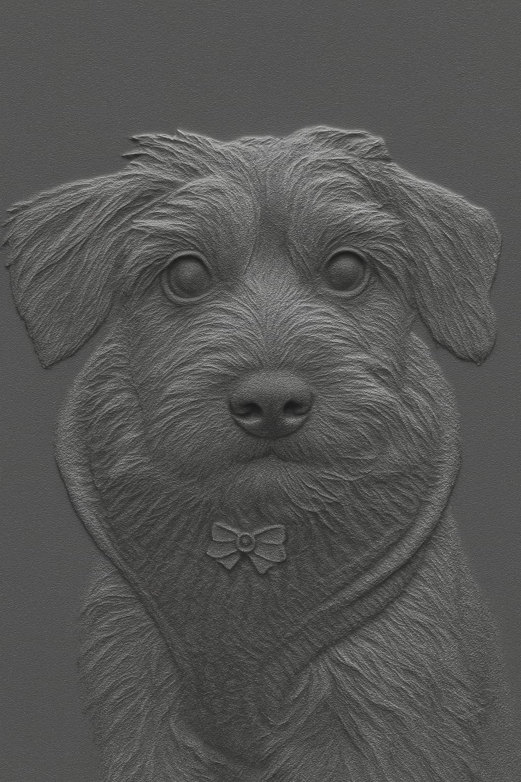

which eventually resulted in:

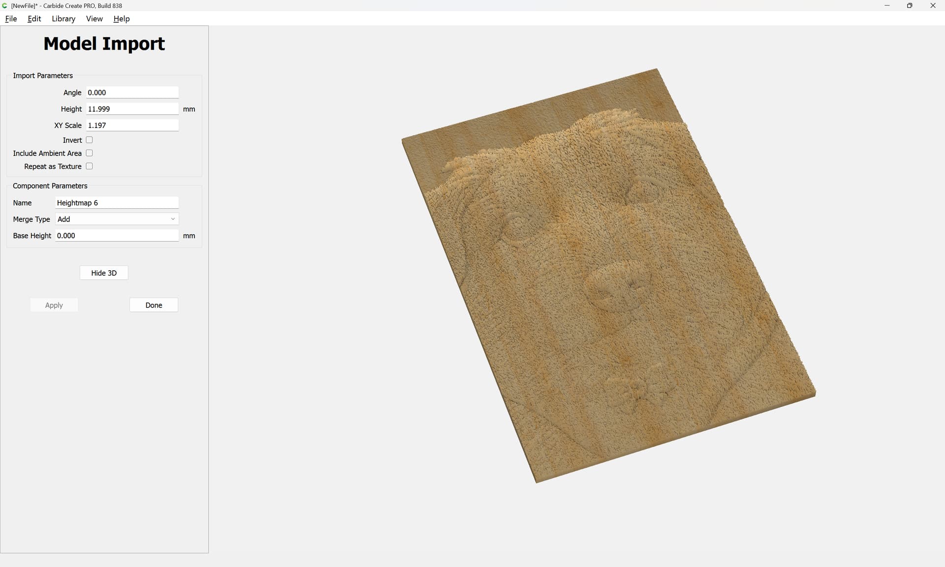

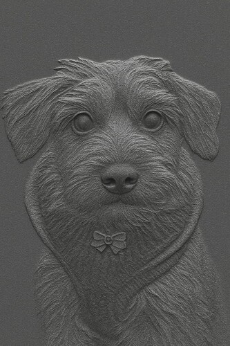

which doesn’t really work:

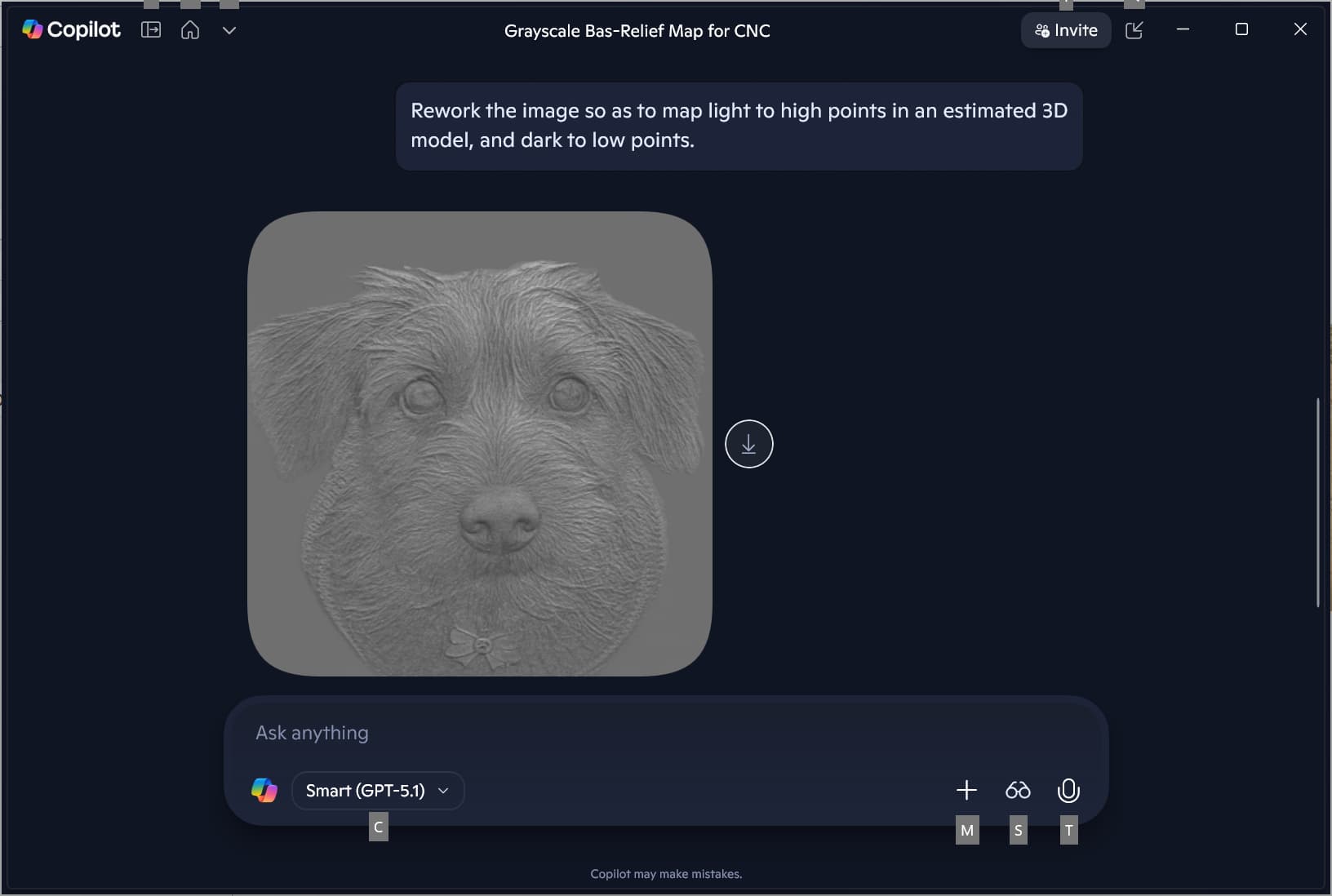

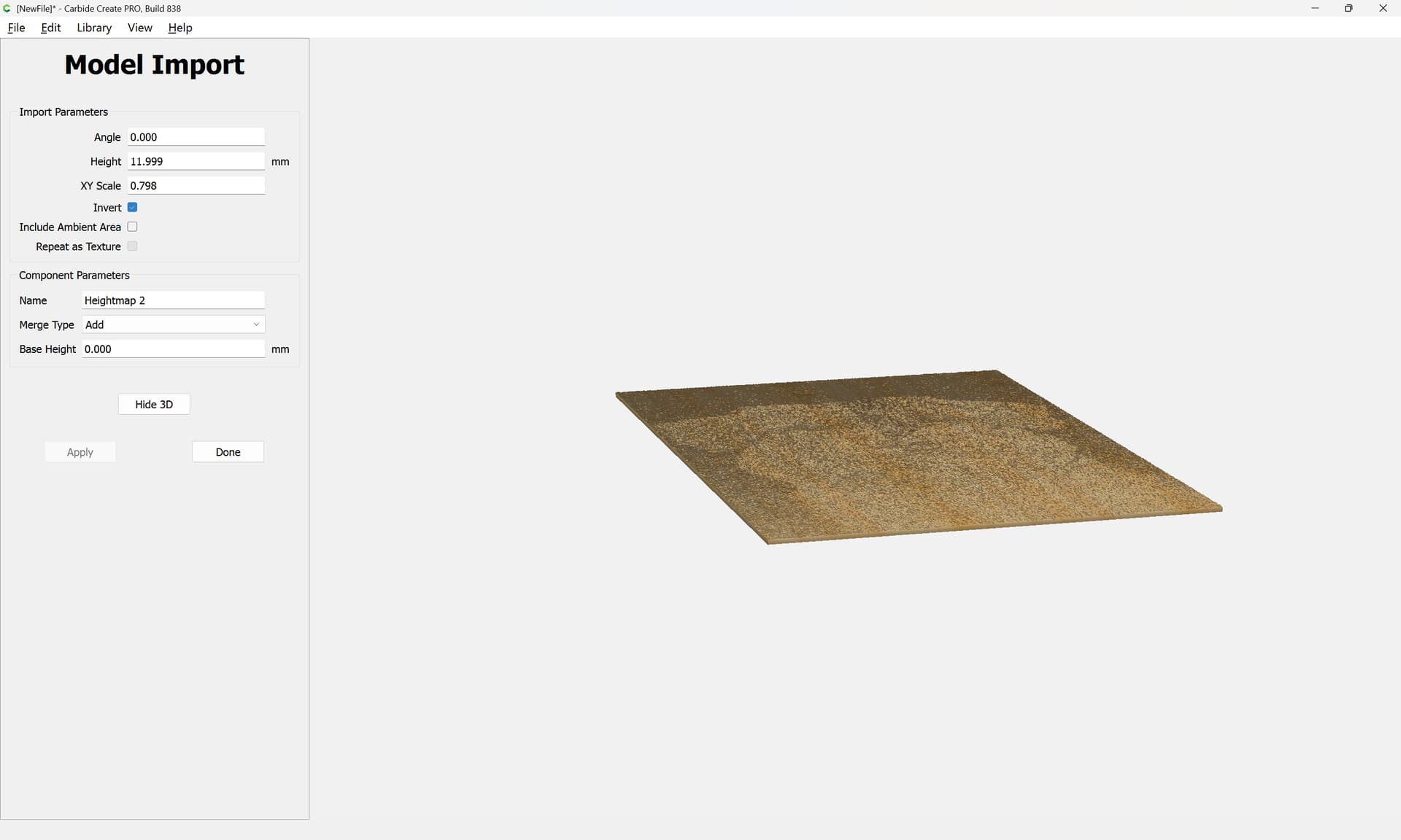

adjusting a bit with:
Rework the image so as to map light to high points in an estimated 3D model, and dark to low points.
gets closer, so we request:

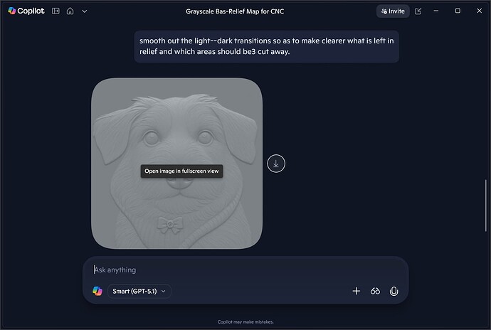

smooth out the light–dark transitions so as to make clearer what is left in relief and which areas should be cut away.
which probably went a bit too far:
