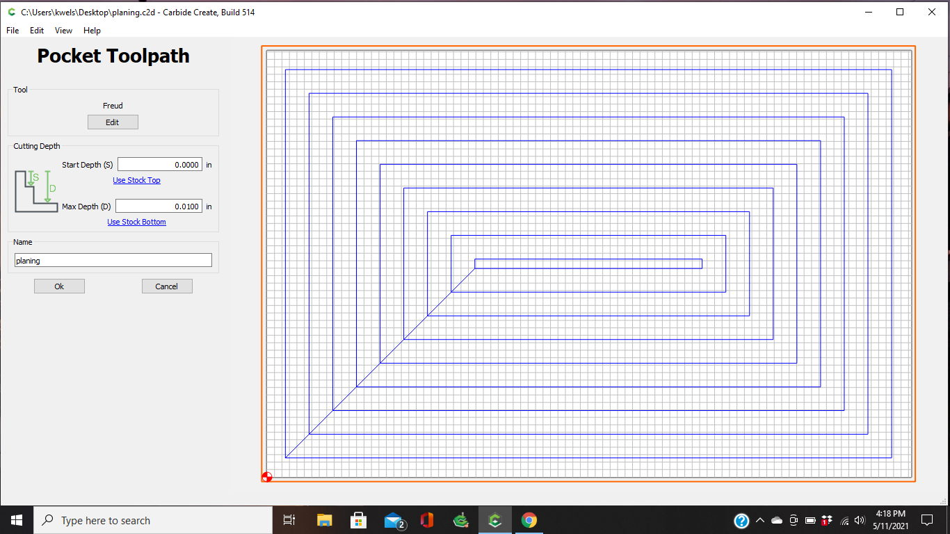

Ran into a Air Cutting problem while using my BitZero V using Myers Shop Clamp CC and G-code, the same thing happened using a simple pocket cut to practice planing a scrap piece of pine.
Placing the BitZero on the lower left corner and making sure it was snug again the work piece I ran the probe.
The bit itself was centered and inside, the magnet attached to the bit. Everything ran fine, once I started CM the spindle retracted when to the center of the work piece and remained well above the piece and was running the cutting.
Setting zero using a piece of paper I had no issues and everything ran fine. Since this happened with 2 projects is it something I did or is the BitZero losing it’s mind?

Please post the .c2d file, generated G-Code, step-by-step notes on how you are securing your stock and setting zero relative to it and managing all tool changes, and a photo showing an attempt at cutting still in place and we’ll do our best to sort this out with you.

planing.c2d (5.9 KB)
planing.nc (466 Bytes)

With respect to securing the stock, on the planing I used cam clamps on all 4 sides, the stock was tight with no movement and flat to waste board. I used 2 business cards on 2 opposite corners to prevent wobble.
With the shop clamp file I used the T-Trak hold down clamps on top of the stock. As above everything applies other than the business cards.
Initially on both separately run projects Zero was lower left. Bit Zero was used to set Zero and the magnet was placed on probe. As a matter of personal practice I hold the Bit Zero snug against the stock. When I clicked on run for either project the router retracted and moved from zero to the start location. The router itself was approximately 1" above the work surface, in that position it proceeded with the cut with the router not plunging down to the stock. Both times I clicked pause and then stop.
I closed CM and then reopened it, the machine went through connect and initialized to the NW corner. Using I manually set Zero using the paper method at the bottom left of the stock, loaded the file, hit run and everything worked fine both times.
The 2 were done hours apart. Both project only involved 1 tool so no changes were involved during the operations.
Hope this helps explains what and how I did things.
