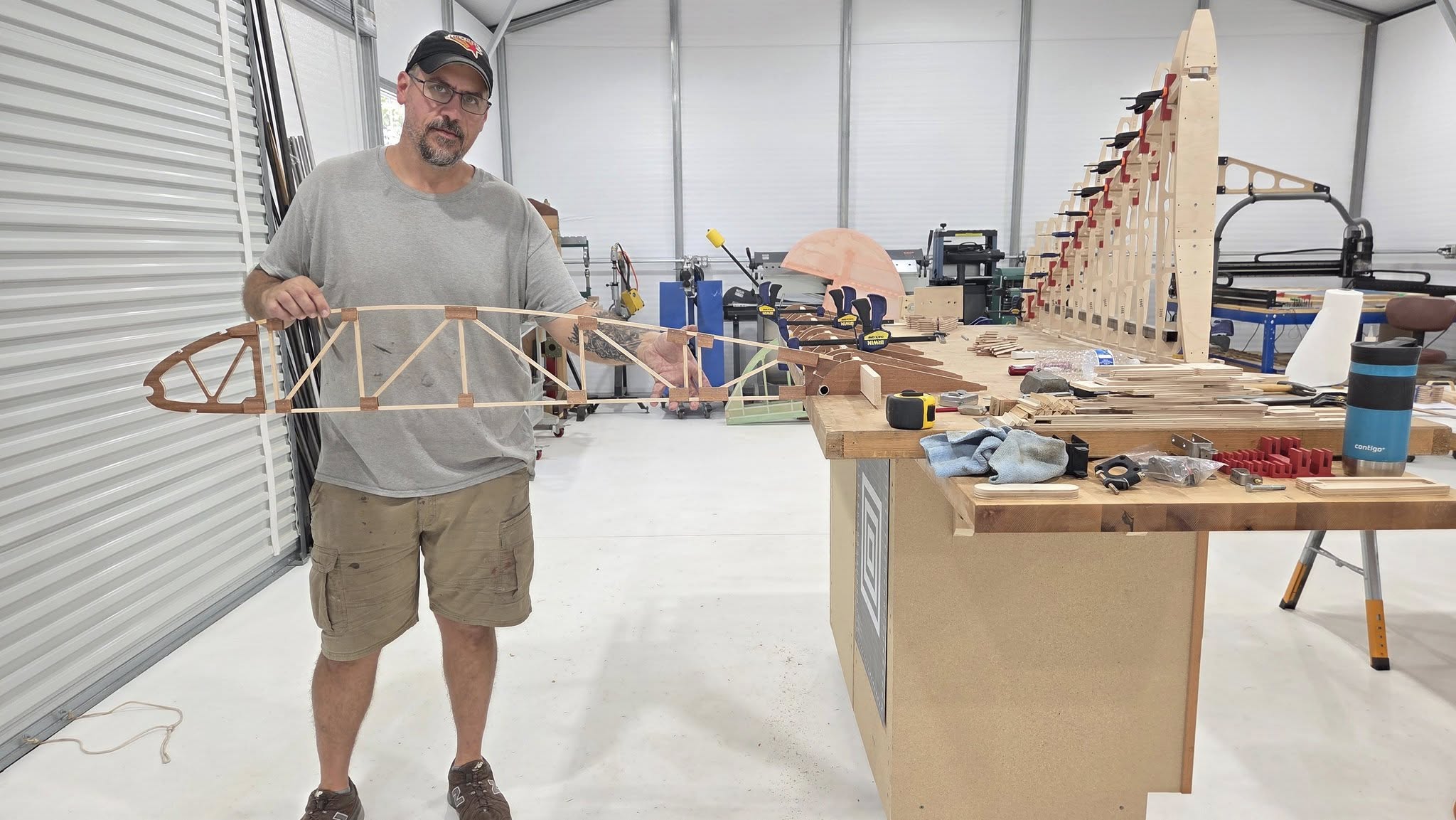

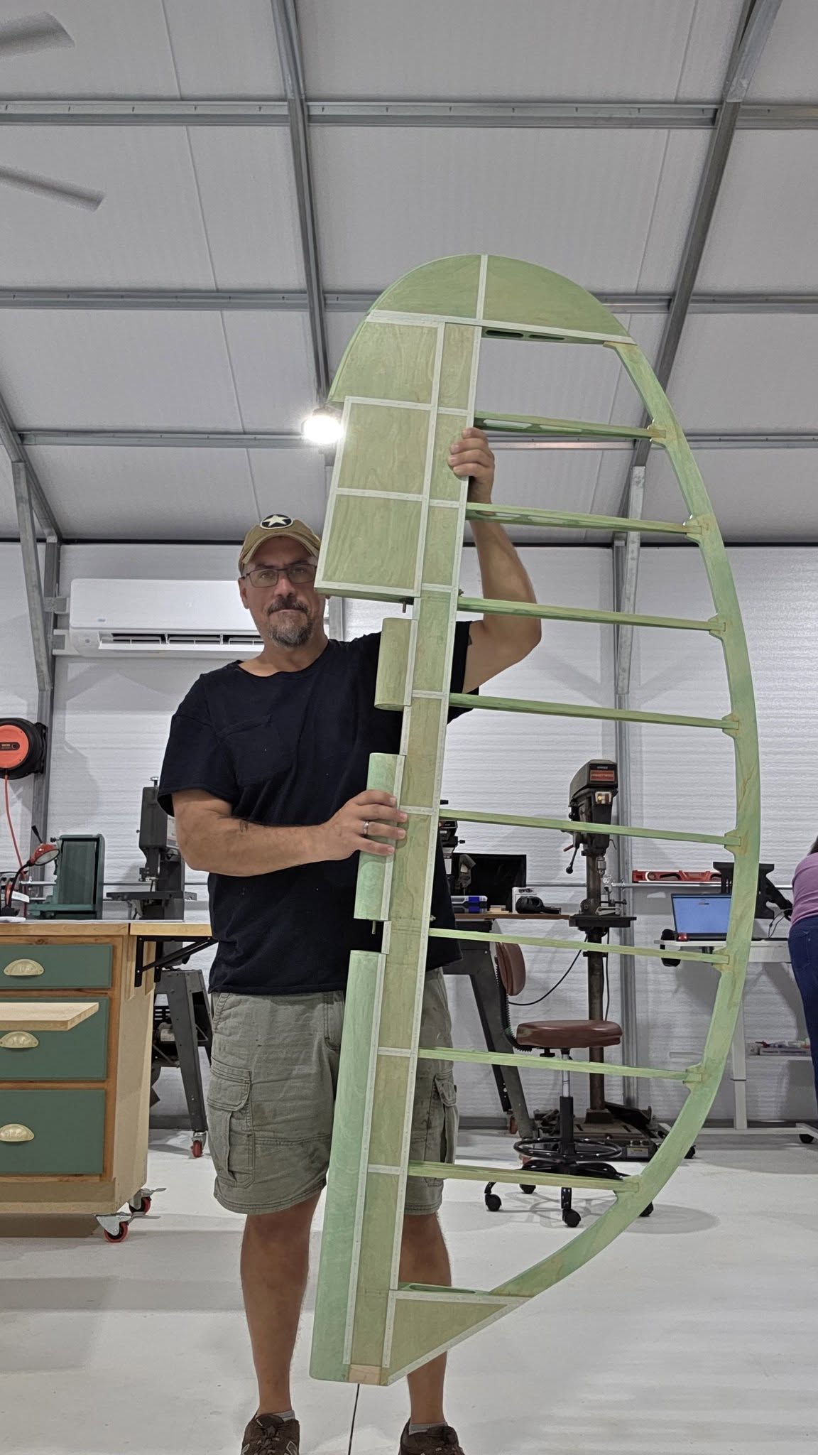

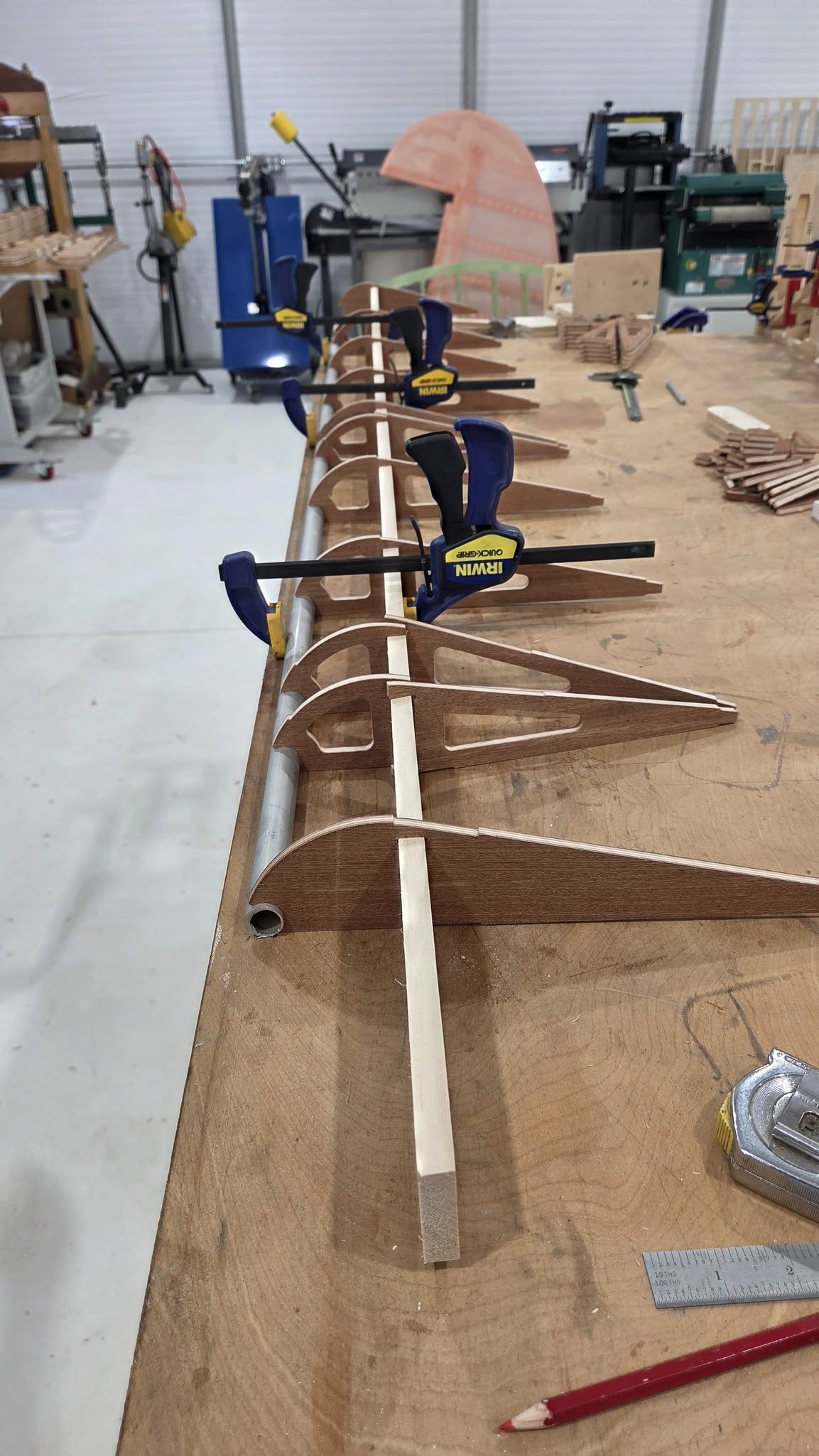

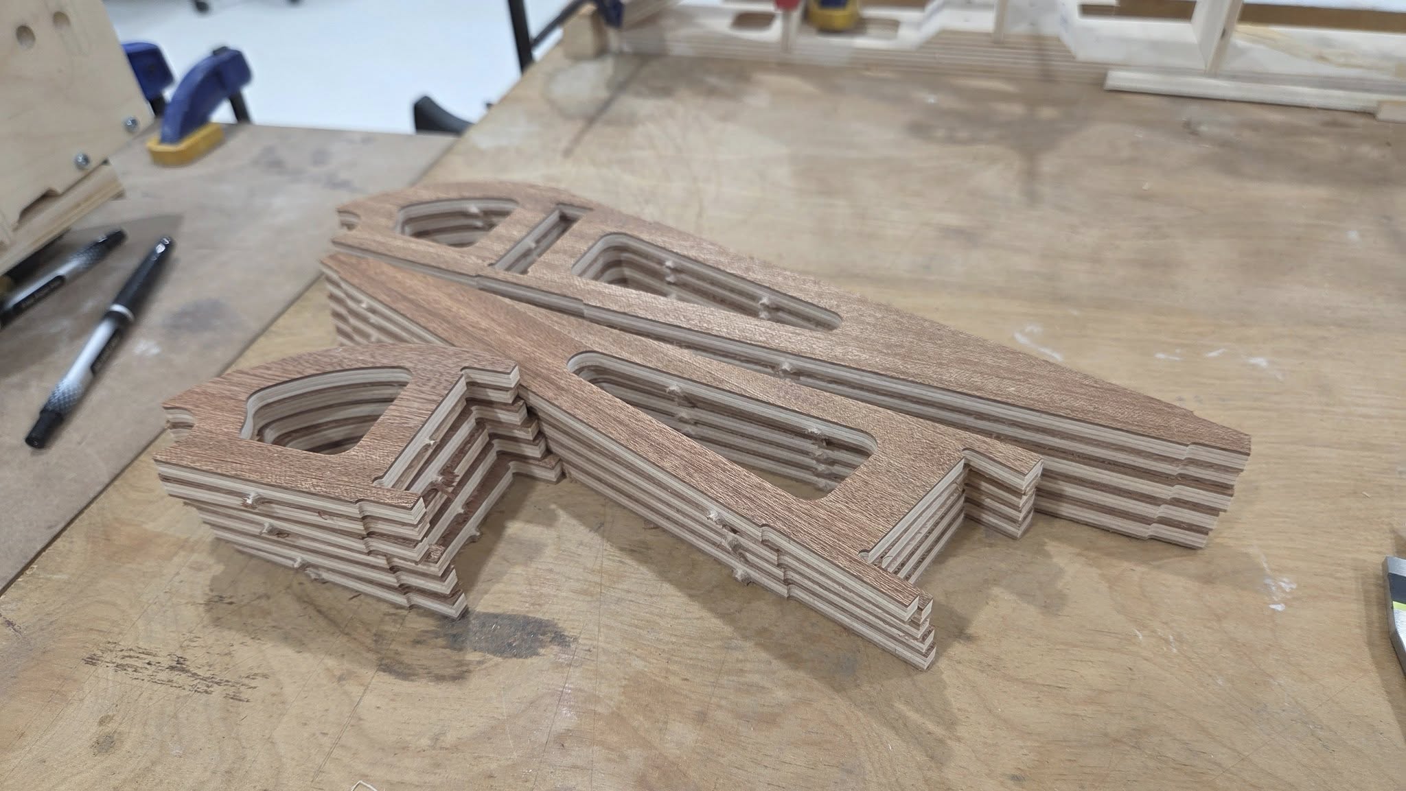

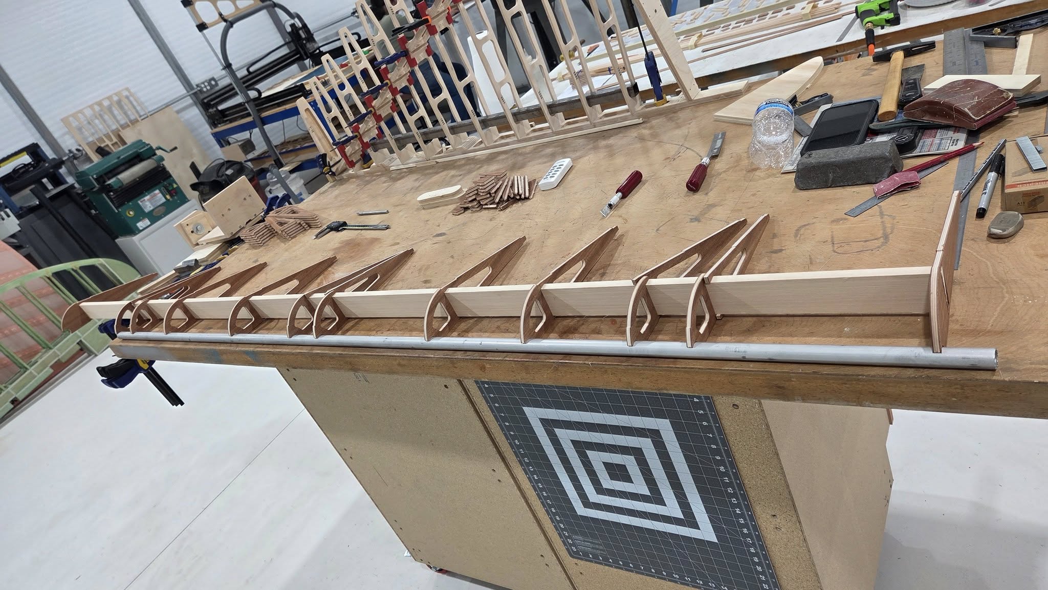

We basically use our Shapeoko Pro-5 for CNC’ing wood aircraft parts for new builds and vintage restoring. We use Birch and Mahogany aircraft grade plywood and Stika Spruce, Pine, Basswood, Mahogany to name a few.
We also CNC 6061-t6, 2024-T3 & 7075 aluminum. We would love to CNC out 4130 Chrome/Moly steel but I think that would be pushing the machine to far.
Attached are some pictures of wood parts we have made, that is my son.
… Enjoy, KAP
BTW, they are for full size aircraft and not models.
