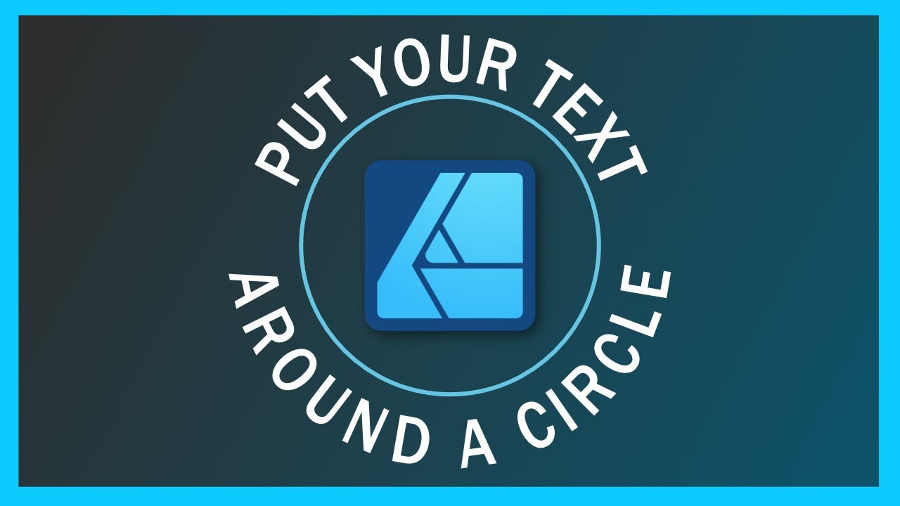

It is trivial to do this in a design software and if you are doing it frequently, you may find it worth investing some time in learning some basic design software. This is the sort of process used for Affinity Designer. It is good software but the principle will apply to all software that can design vector images.
I will note that this can go much faster if you set up the circle center to be at an intersection of a coarse grid.

The Affinity Designer tutorial linked aboved shows the process is entirely trivial. Additionally the user needs to be aware that Carbide Motion expects the saved .svg design to be exported from any design software at 96dpi. Even though this is not a normal requirement for vector images, which are actually resolution independent, the Carbide Motion software will not honour the measurements created in any design package (notwithstanding Carbide Create of course) unless the design is saved at 96dpi.
