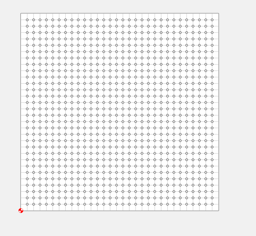

Using the latest update all my old files are blank. They were all created in Carbide Create.
They won’t even open, just says new file.
Waste-Board-1x1.c2d (2.7 MB)

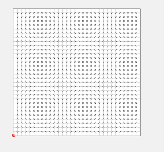

I saved it as CC 757
Waste-Board-1x1.c2d (1008 KB)
