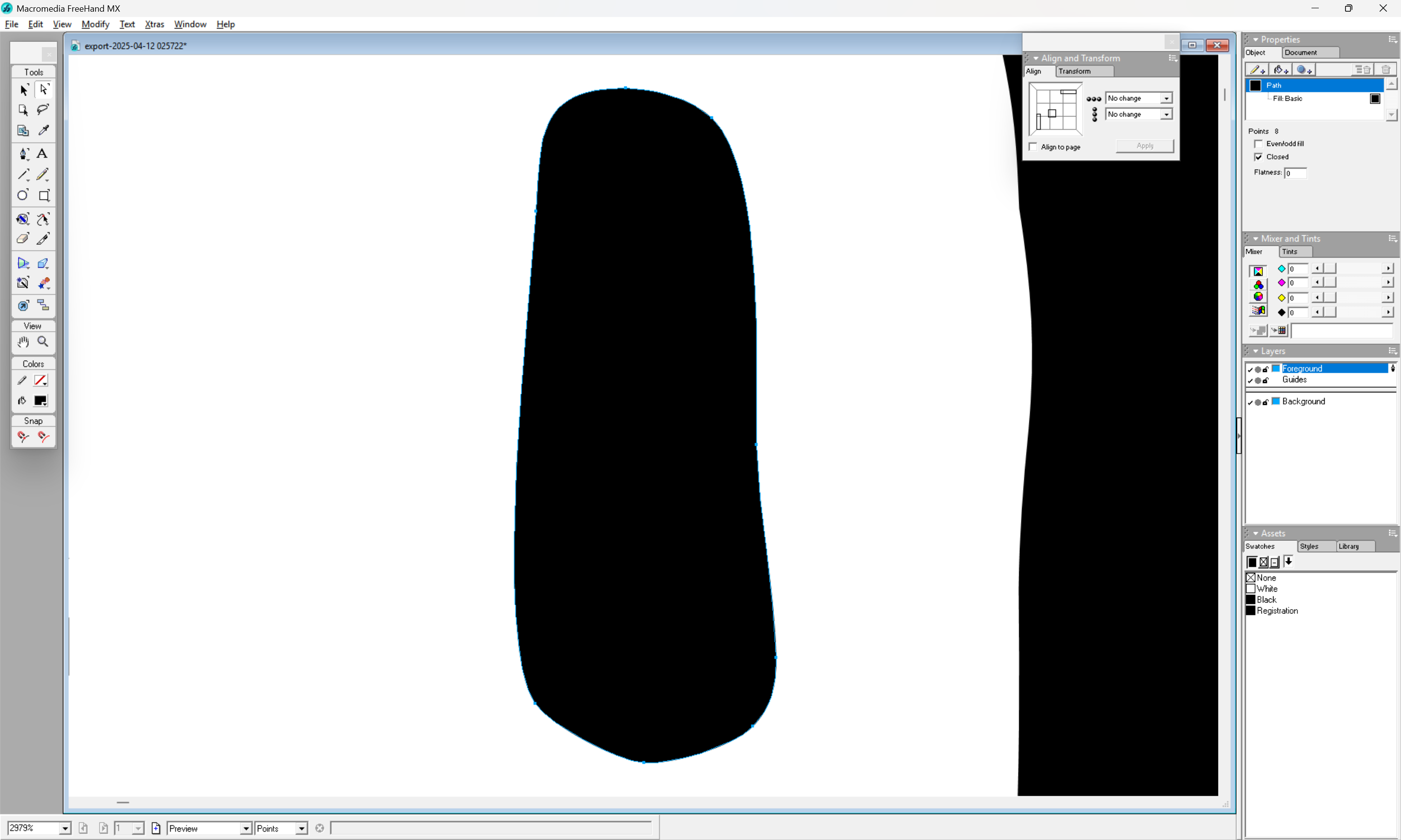

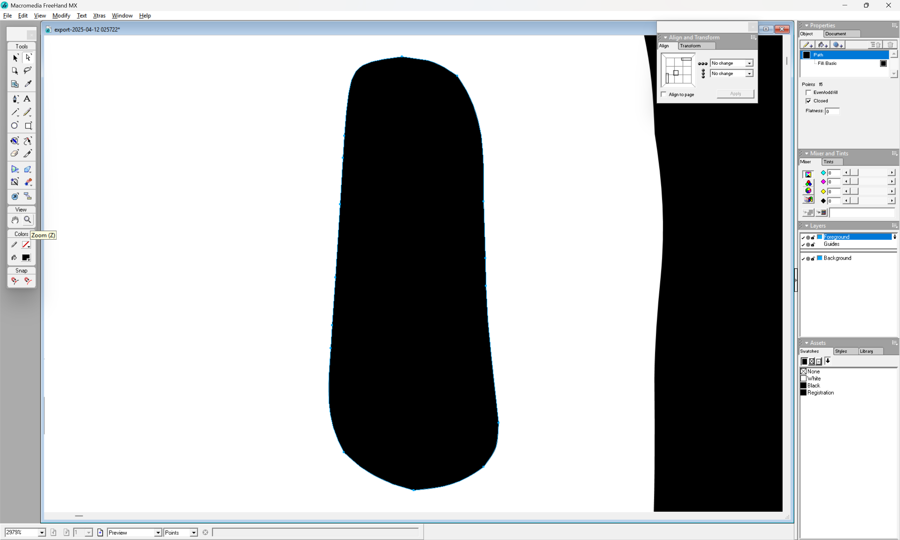

I would argue that the geometry can be optimized, at least to some degree:
15 nodes

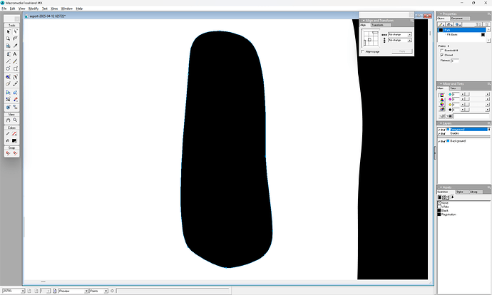

Simplify gets it down to not quite half that:

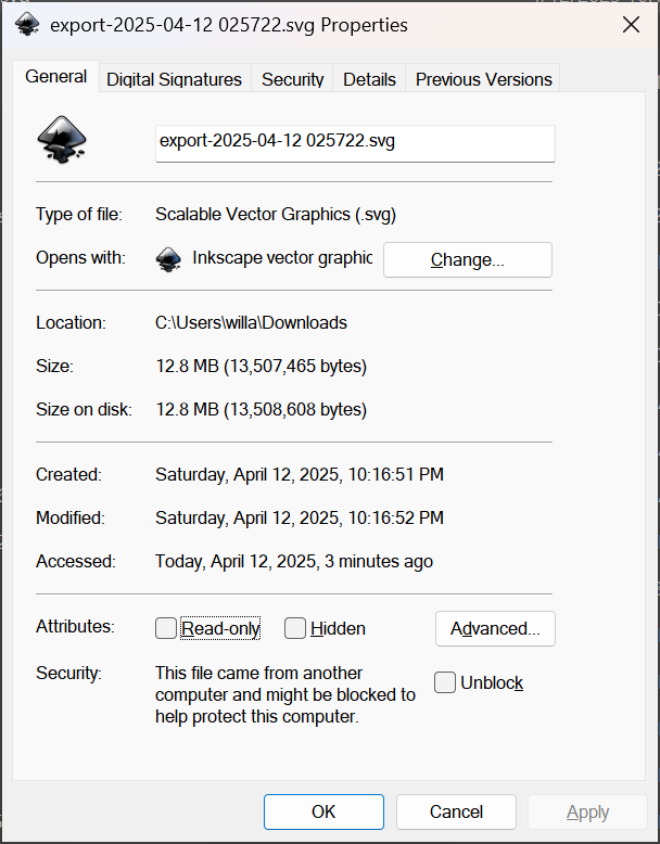

and overall the file went from almost 13MB:

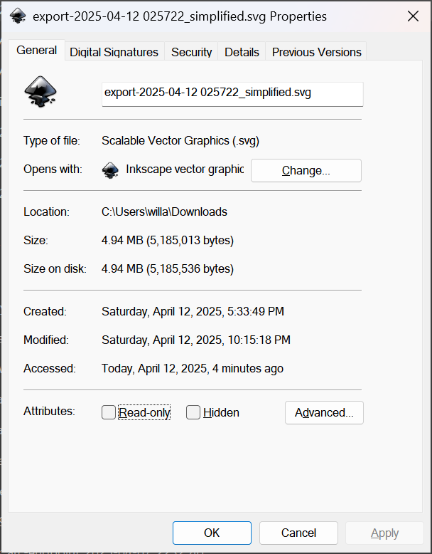

down to less than 5MB:
which may help a bit until the updated version mentioned is released.
