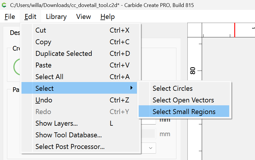

Other programs do have “Simplify” options:
so I usually export as an SVG and open the file in a suitable program and simplify there.
That’s exactly what I’m looking for!, How do I use select small regions?
but of course it was here the whole time! Thanks Will
