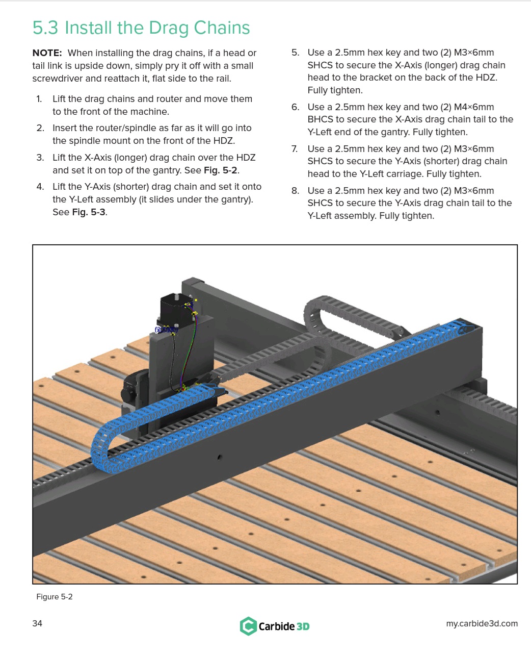

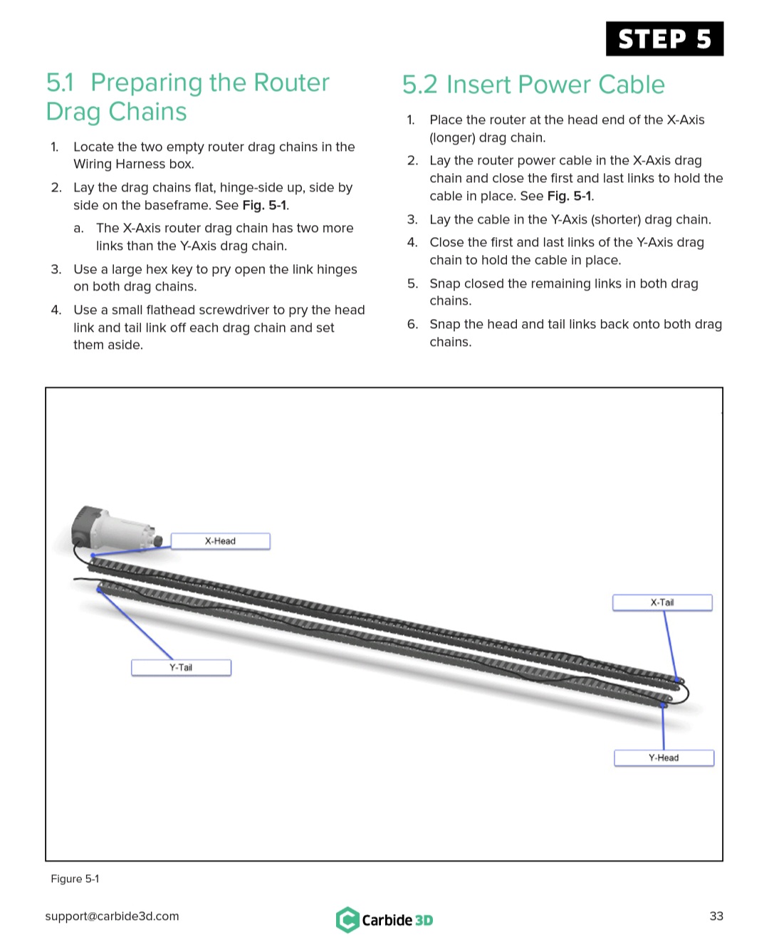

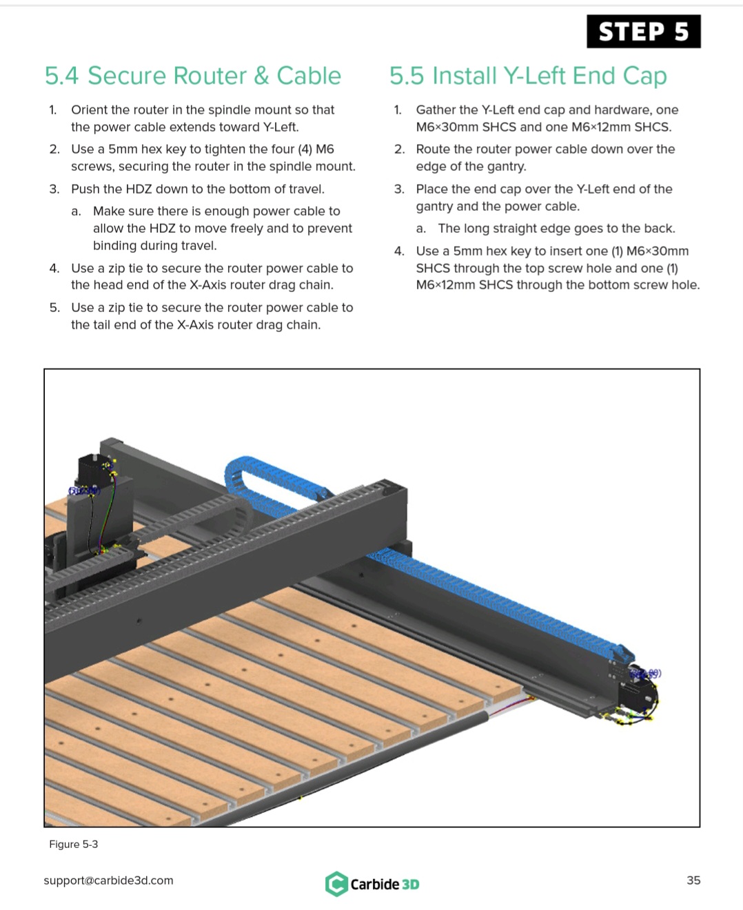

My drag chains have no cables in them. Assembly manual shows three cables in the drag chains. I have one long and one short gray cable, but they did not come inside drag chains. Am I misunderstanding something?
Not sure what unit you have.
I know with the S5, it came with two empty drag chain. They were installed on the x axis and y axis to house the cord for the router.

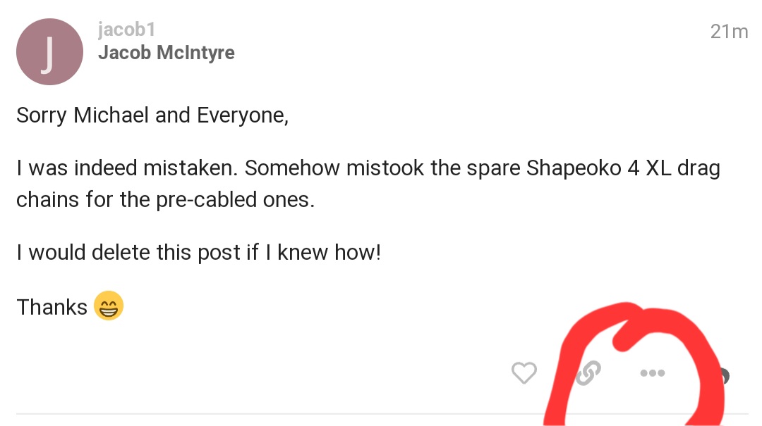

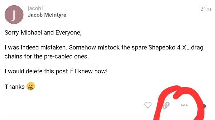

Sorry Michael and Everyone,
I was indeed mistaken. Somehow mistook the spare Shapeoko 4 XL drag chains for the pre-cabled ones.
I would delete this post if I knew how!
Thanks :grin:
