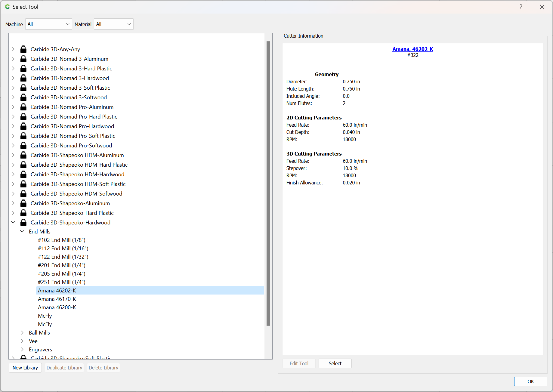

The Amana feeds and speeds are intended for heavy, industrial machines.
We have feeds and speeds for the tooling we sell, appropriate to our machines, in Carbide Create.
What about the Amana Package you sell on your website?
I understand that you have feeds and speeds for the carbide 3d endmill.
Thank you! I understand now.
