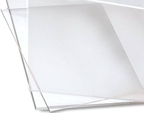

I purchased it on Amazon
I get all of my cast acrylic from estreetplastics. Almost half the price compared to Amazon. Great service and they deliver very fast. 24" by 48" 1/4" thick is about $38.99. Amazon is $54.05
https://www.estreetplastics.com/Clear-Plexiglass-Acrylic-Sheets-1-4-Thick-s/28.htm
if you are local to NOLA area you can get some cast acrylic sheets at Hub hobbies. just ask. Johnson plastics has / had some good pricing as well.
