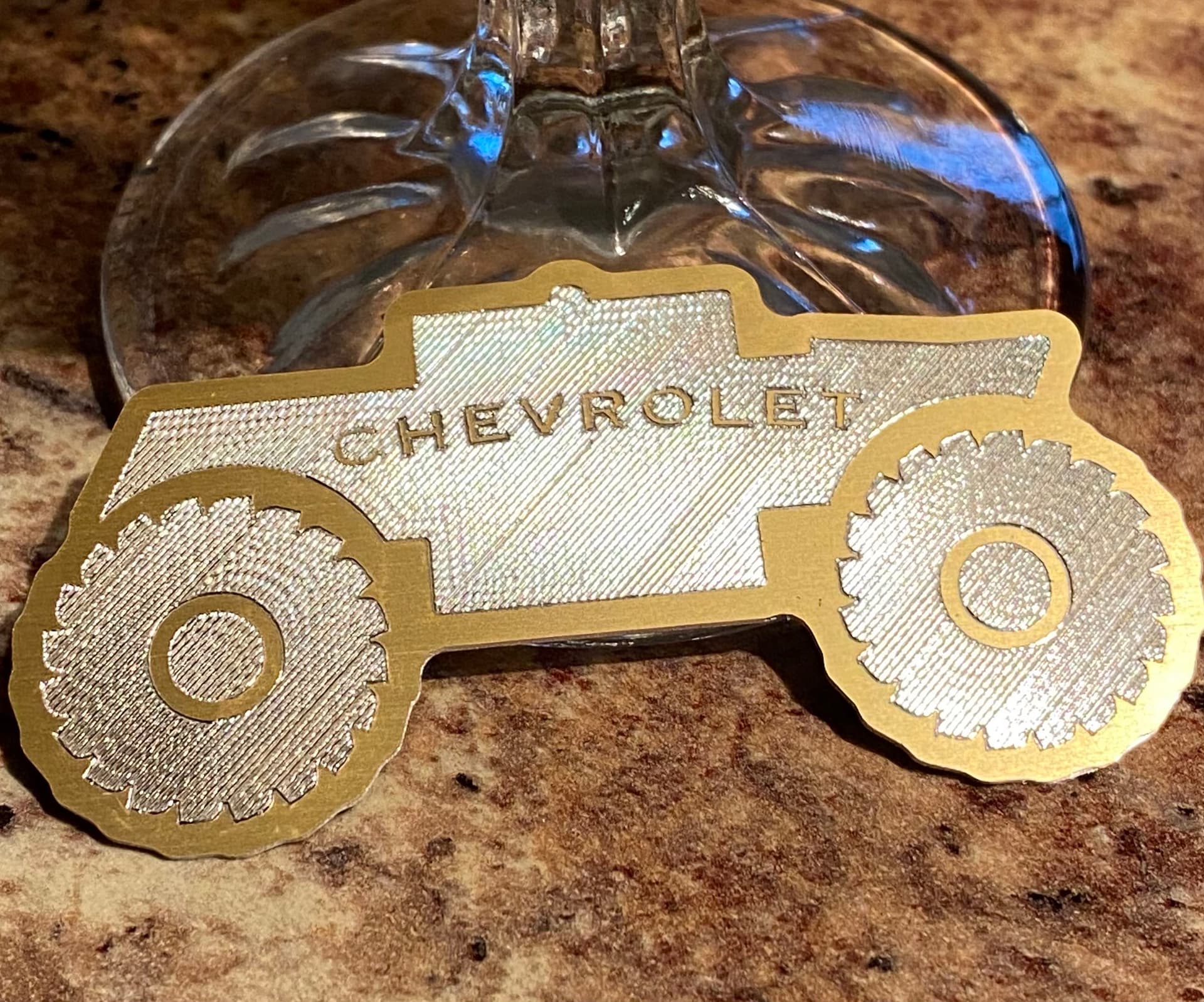

Yes, on coloured anodising, it left a really sparkly silvery finish which contrasted well.

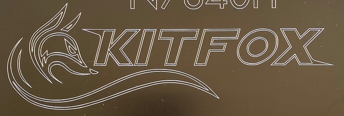

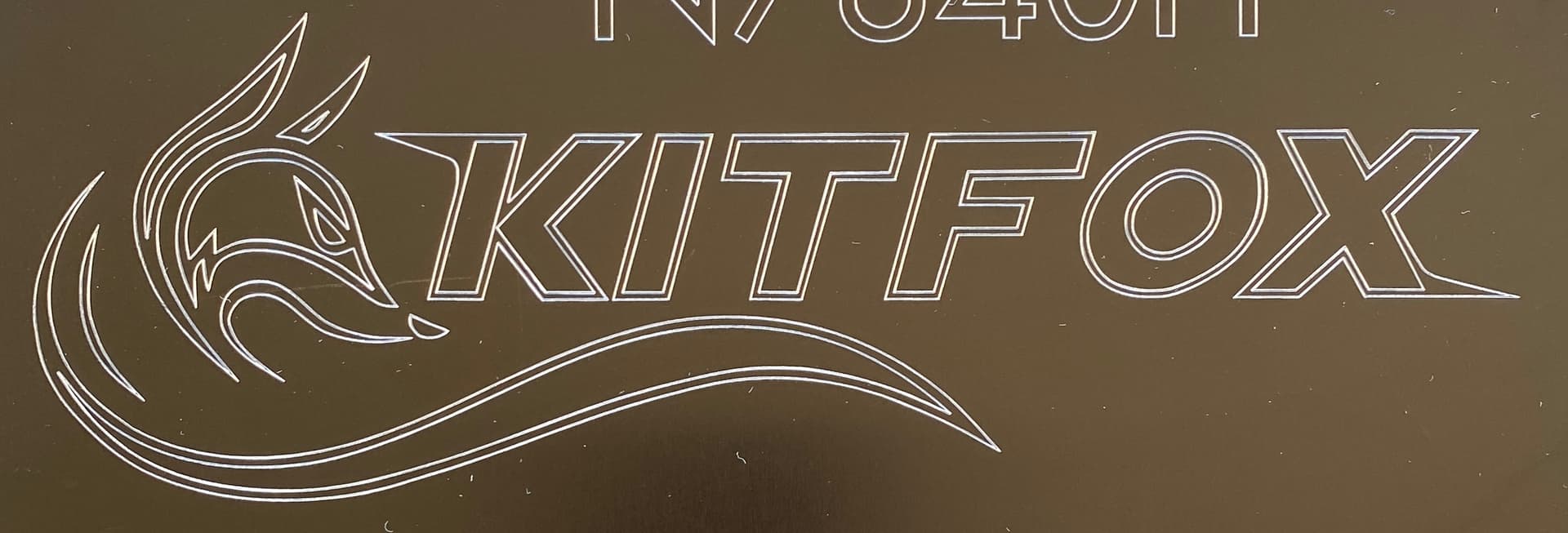

Diamond Drag on anodized aluminum works great. Here’s a sample on black, which is part of an instrument panel I made for a friend’s Kitfox airplane.

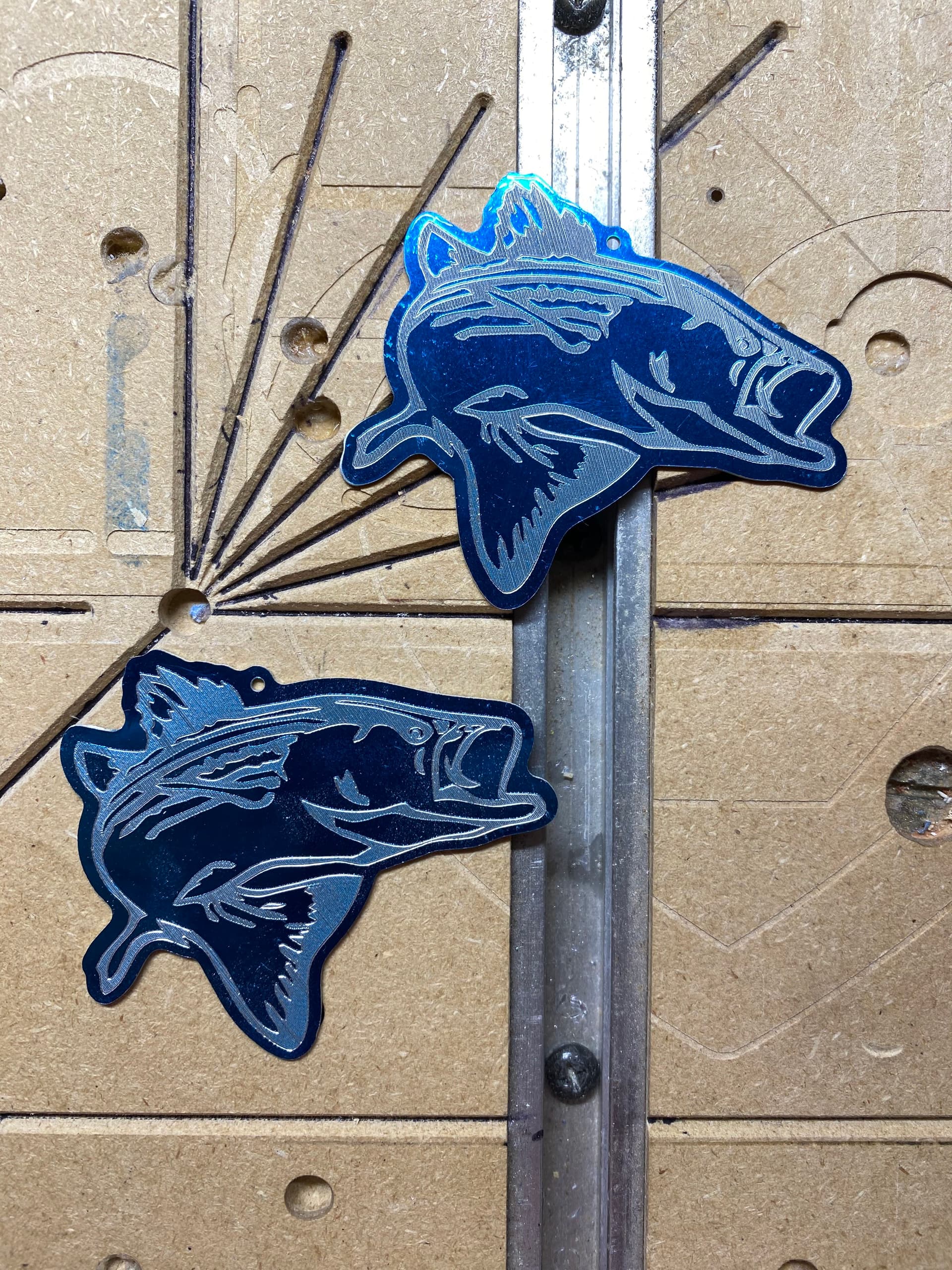

Where are you finding your anodized aluminum? Been looking at OnLineMetals good stuff but not enough choices when it come to colors. Thanks
Sorry for the delay in responding, it’s Bass chasing season. :fishing_pole_and_fish: The last ones I purchased are these. Ebay is a good source too.
