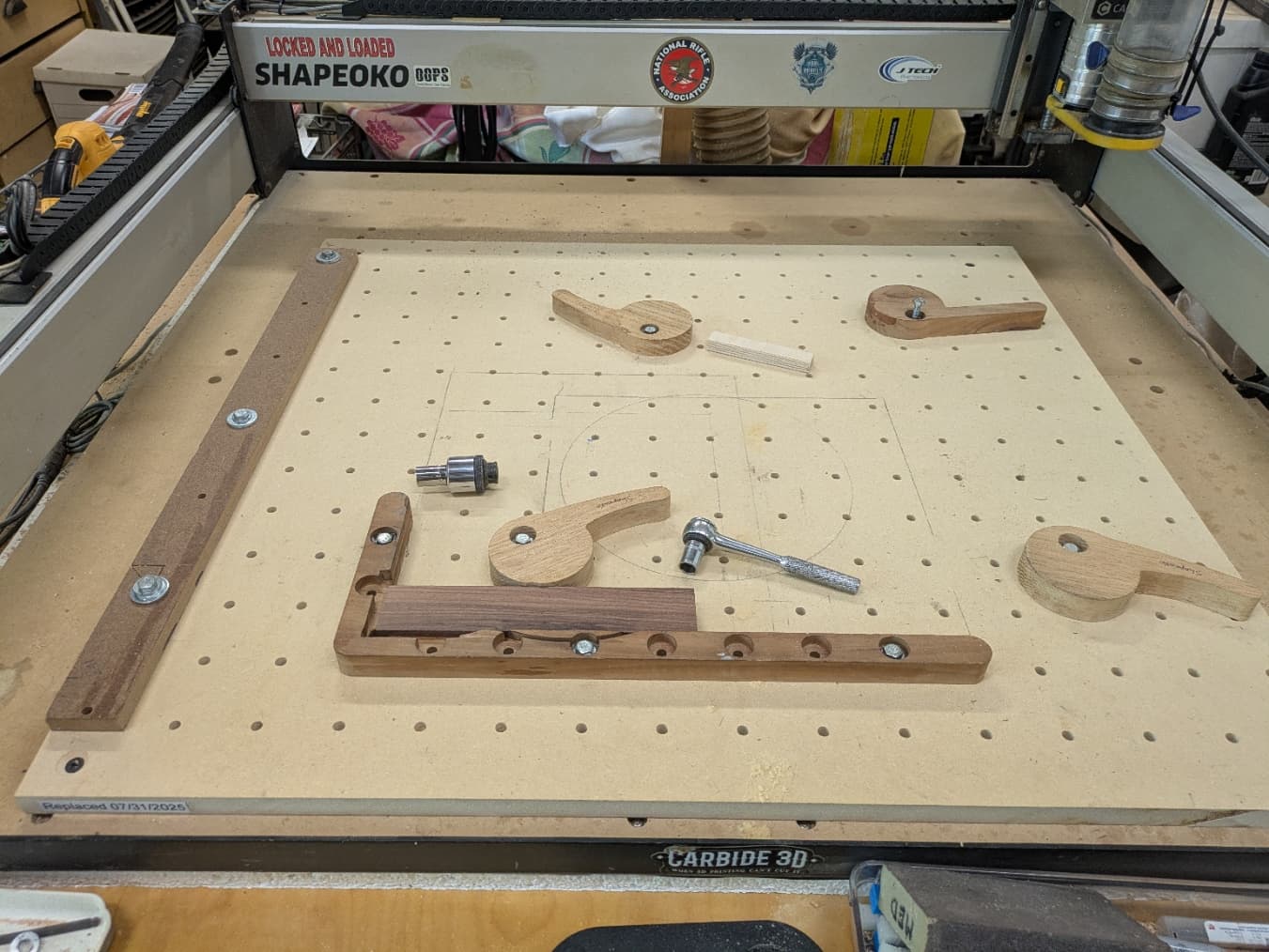

@gdon_2003 - Thank you. I like how you designed this. Do the tee nuts basically go into the slotted areas? Do you happen to have a pic of your spoilboard with the nuts/clamps? Thanks again!
Here is my SO3 XXL spoilboard. I use the long L bracket and the cam clamps. The piece on the left is my tiling fence. The L bracket is squared by jogging with a 1/4" bit. You can see pencil lines on the spoilboard that are when I use painters tape and super glue to hold projects. I put the piece on the L fence an mark the perimeter. Then I apply 2" painters tape to the spoilboard and the back of the project. I use Titebond Medium super glue. Wait about 10 minutes after you press the parts together. I apply the super glue in a wavy pattern. I have the 2" painters tape line up bottom and top (bottom of project.
The spoilboard was replaced in July 2025. You can see after a lot of projects my spoilboard is almost pristine. I use the bottom of material for just about everything so I dont get scaring of my spoilboard.
