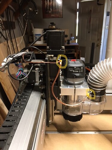

I ran braided copper ground wire tied it to Control board cover screw, through cable train up to Z-frame, through cable train over to Z assm. Question
How would I ground the Carbide spindle/router? If outter shell is grounded to Z asm, wouldn’t that work?
I replaced the cord on my Makita router for my SO3XXL so I could have a ground conductor which I ran out of the casing & attached to the router body via one of the casing bolts - also to put a longer cord on it.
The C3D router has a grounded cable which grounds the router housing I believe.
The Carbide Compact Router is double-insulated and this should not be defeated.
You can ground the metal housing — the usual way to do that is to connect it to the hose (I wrap a bit of metal tape around my dust shoe) and use a conductive hose connected to a vacuum designed for such a hose and which will ground that — if the vacuum doesn’t ground the hose, then connect the hose to ground at that end.

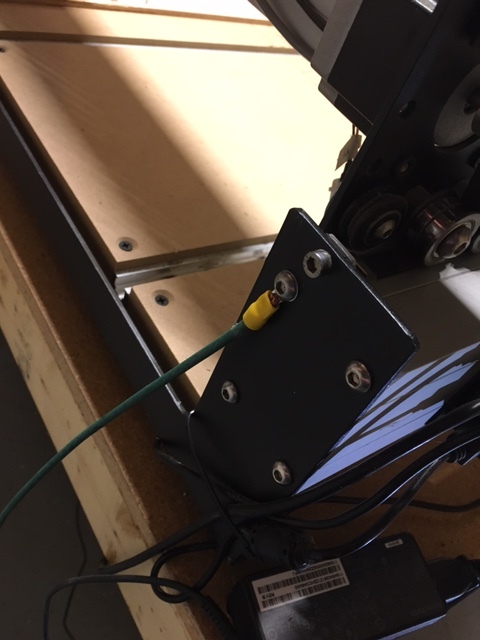

Update: I grounded everything to the machine frame, then grounded the frame to the outlet.Ran 3 jobs in a row, almost an hour each, with NO disconnects.
What I found> The Y rails both conduct to the black frame, but the X frame and Z assm are both isolated,
I ran braided copper from the Y frame wire train bracket screw, through train up to the X frame(black) Then through X Train to carriage assm(blk) Then to the Vac Hose. Grounded the frame. Meter now reads 0.006 ohms at highest point (Spindle frame)

C3d router is only 2 wire, but the body mounting conducts to the Z asm, so I grounded the Z asm, which also grounds the router body.
Yes, I realized that a few days after I wrote that response. I also have a ground wire that is connected to the router mount. Keeps my router, sweepy & vac hose all grounded quite well.

As you noted the X axis was running 10 ohms or so and the Z axis had zero continuity.
I grounded my SO pro 5 components. 1 ohm max across the machine including the wire in the vacuum hose.
