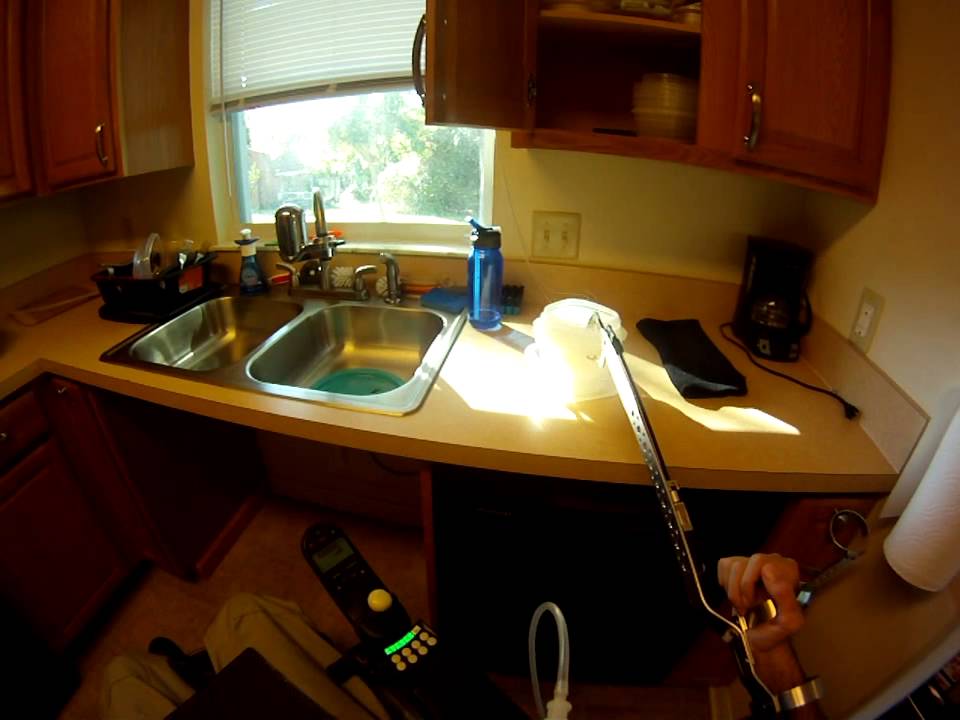

This is the Sip-n-Puff reacher I co developed for quadriplegics. I designed the motor driver board that controls the micro linear actuator that opens and closes the jaws.
That’s super cool! My aunt would have loved one of these if she was still alive. She had polio and was wheelchair-bound for the rest of her life.
