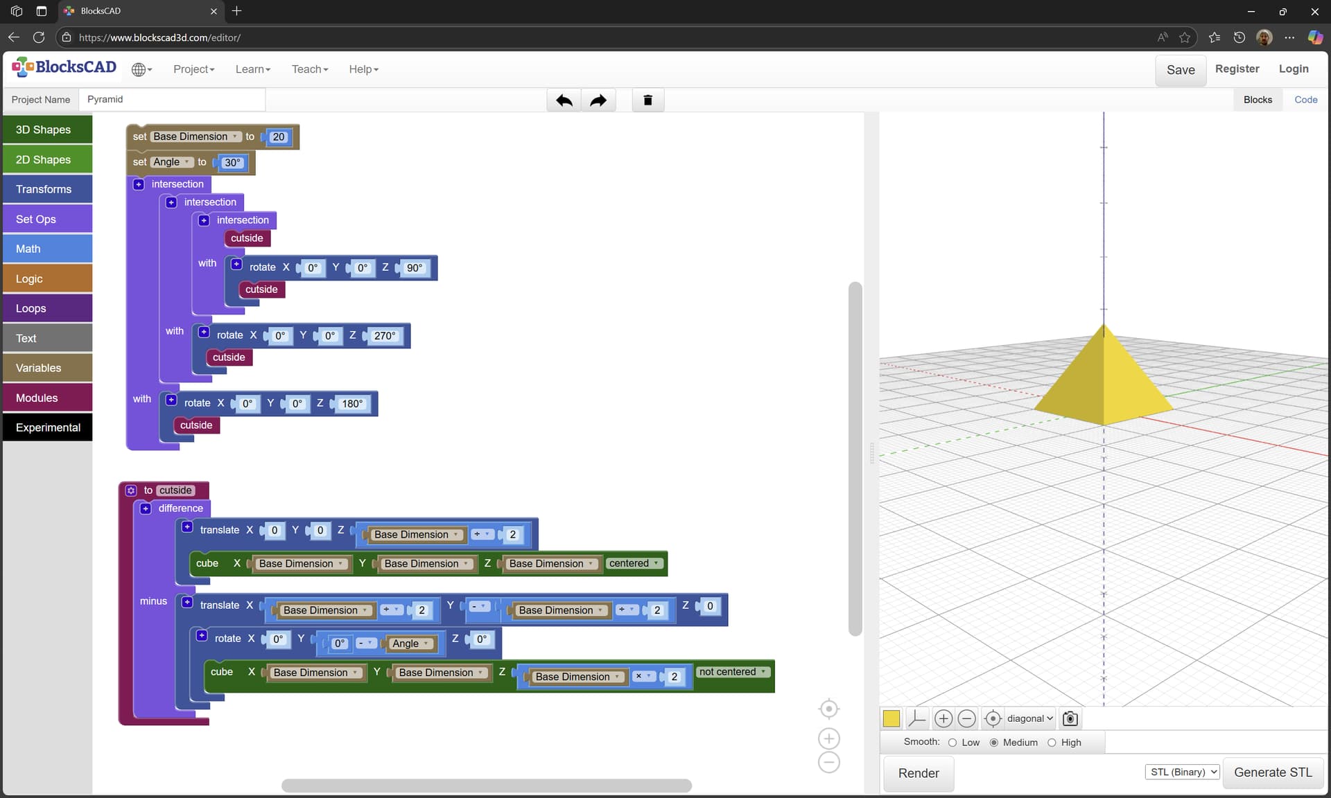

As folks may have noticed, I will frequently rough out designs using BlockSCAD:

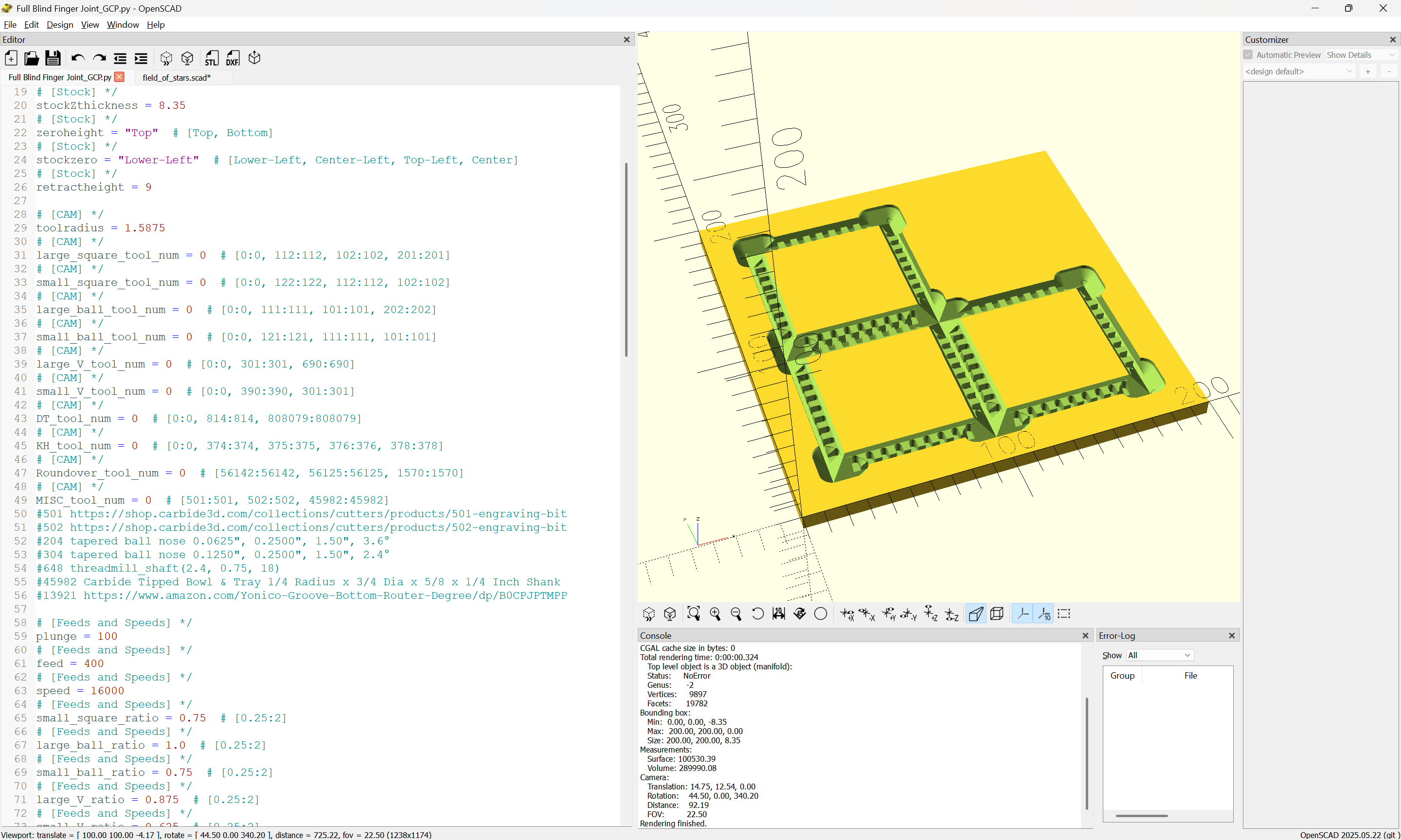

but I’ve been stymied by the default export to STL, which is fine for 3D printing and some CNC usages, but which hasn’t worked well for certain of my projects, so I’ve been working on a library which allows directly creating DXF (and G-code) from OpenSCAD in a fashion which matches/expresses tool movement:

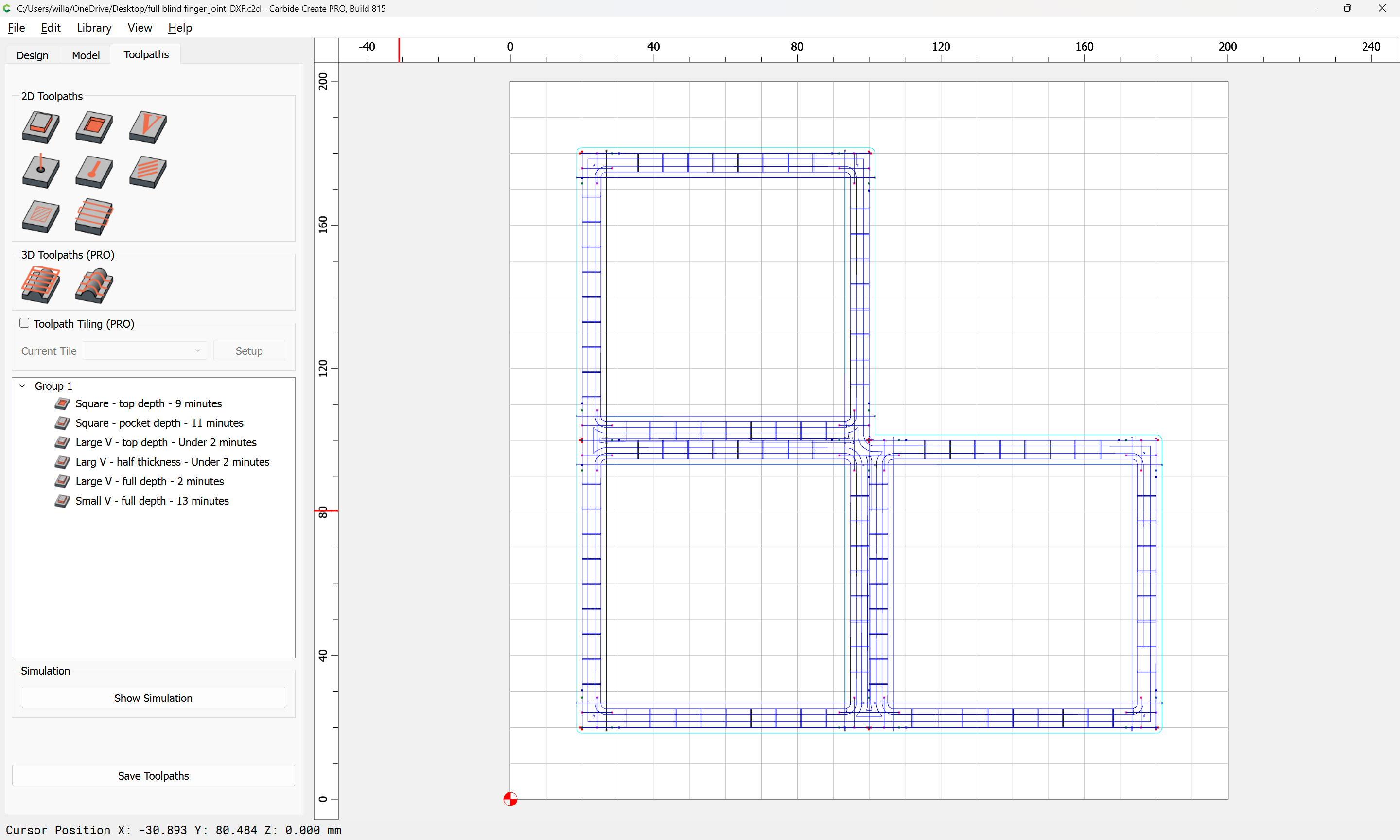

I am making DXFs so that they can be imported into Carbide Create — the idea is to make a 3D model using toolpaths:

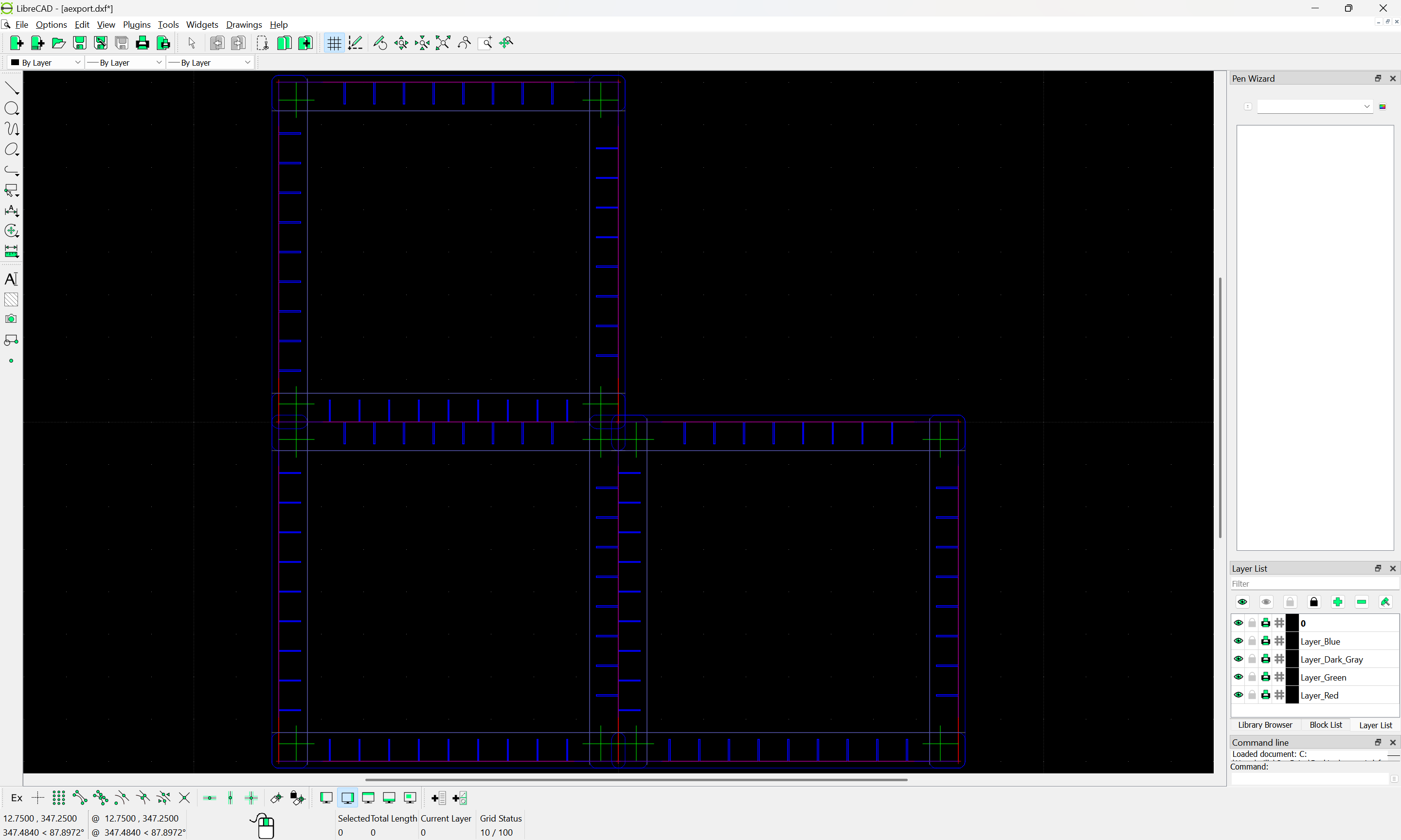

capture the toolpath, or outlines of their regions in a colour-coded DXF:

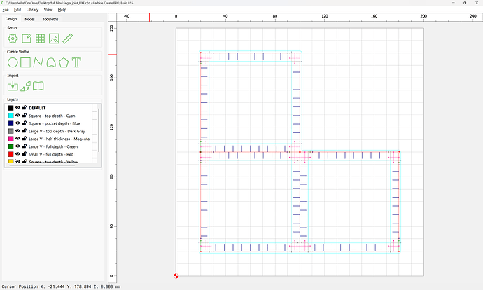

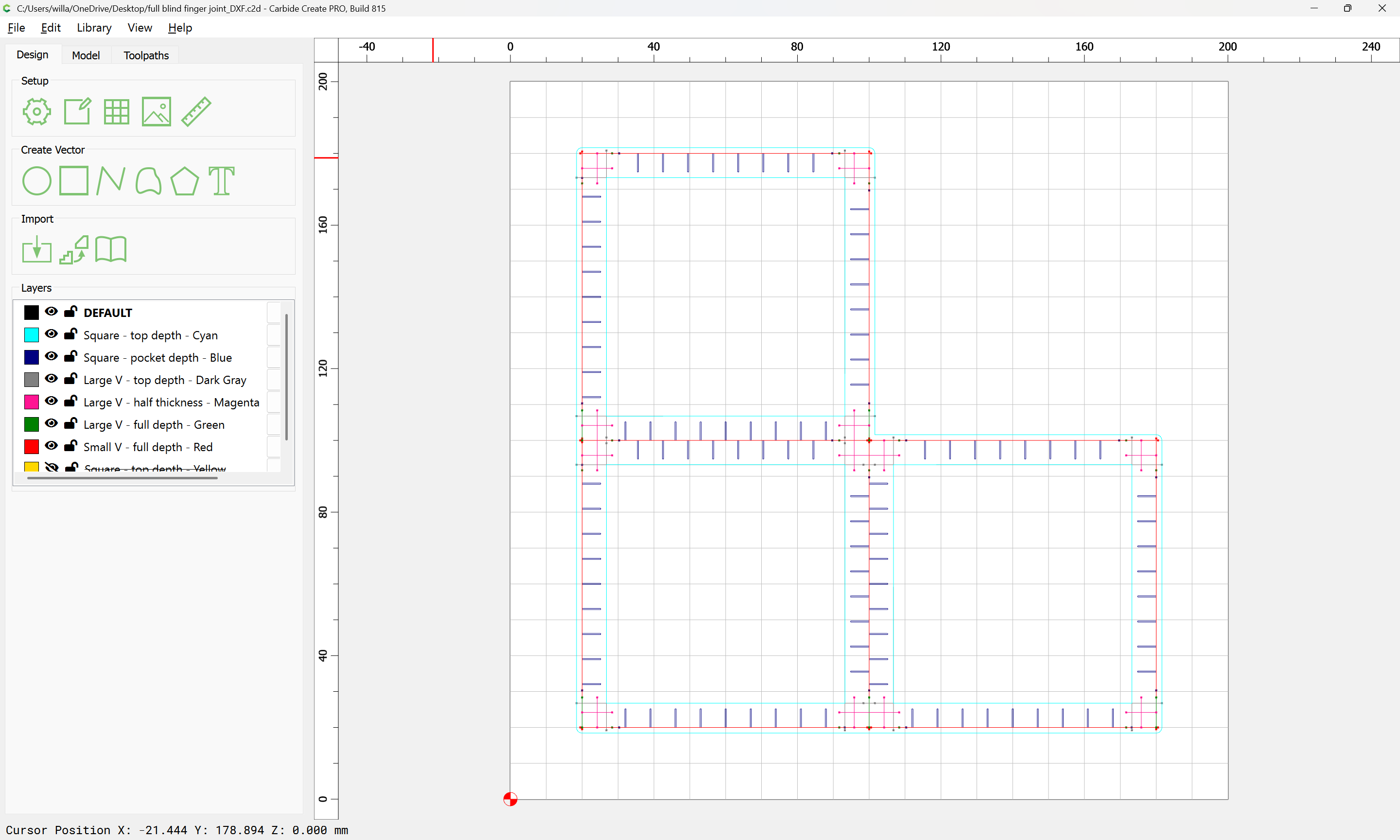

import the DXF into Carbide Create and assign the various elements to layers based on the colours from the DXF:

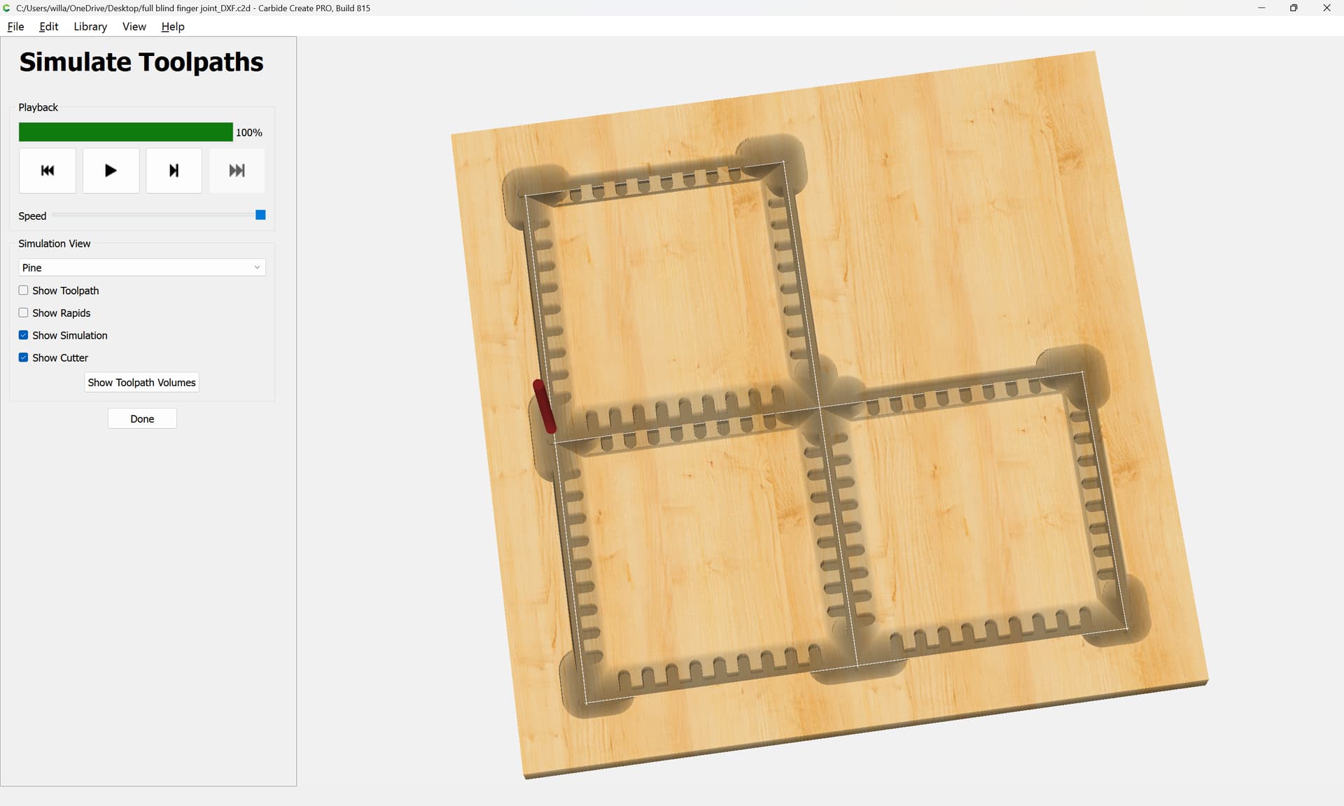

which with appropriate toolpaths associated with the layers:
cuts the design:
Ultimately, the vast majority of toolpaths are 2D routing (with rapids to move between heights/toolpaths).
