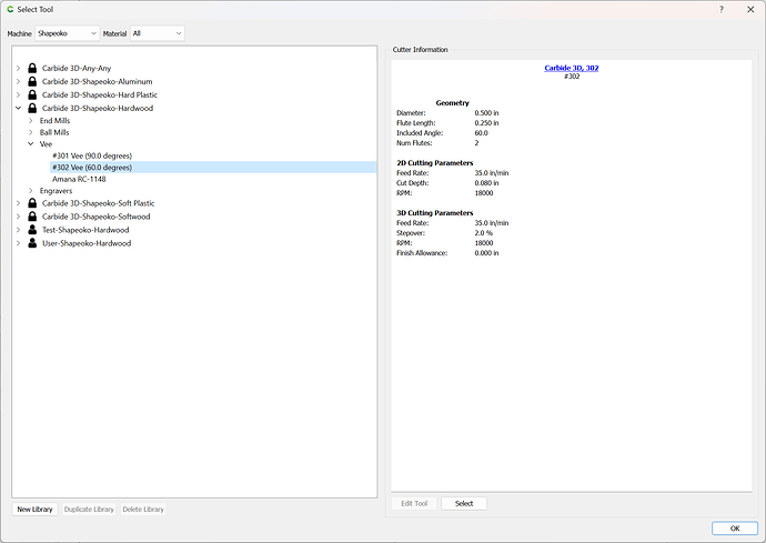

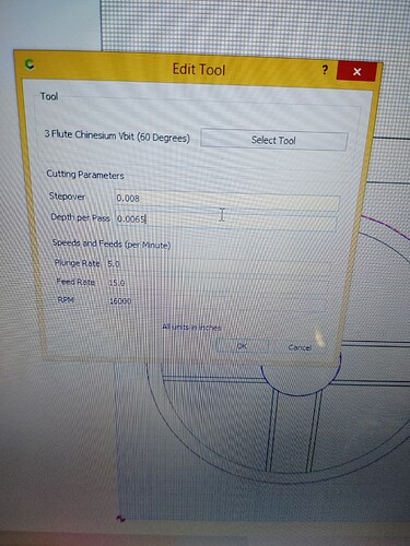

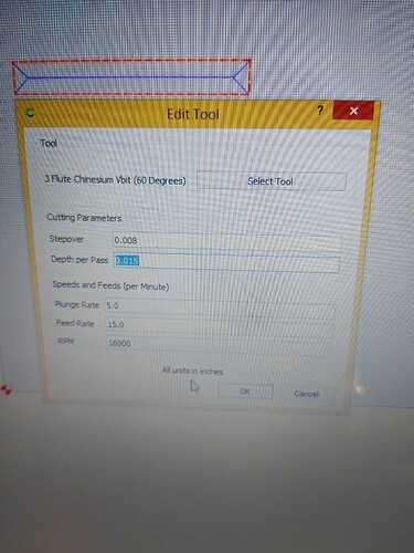

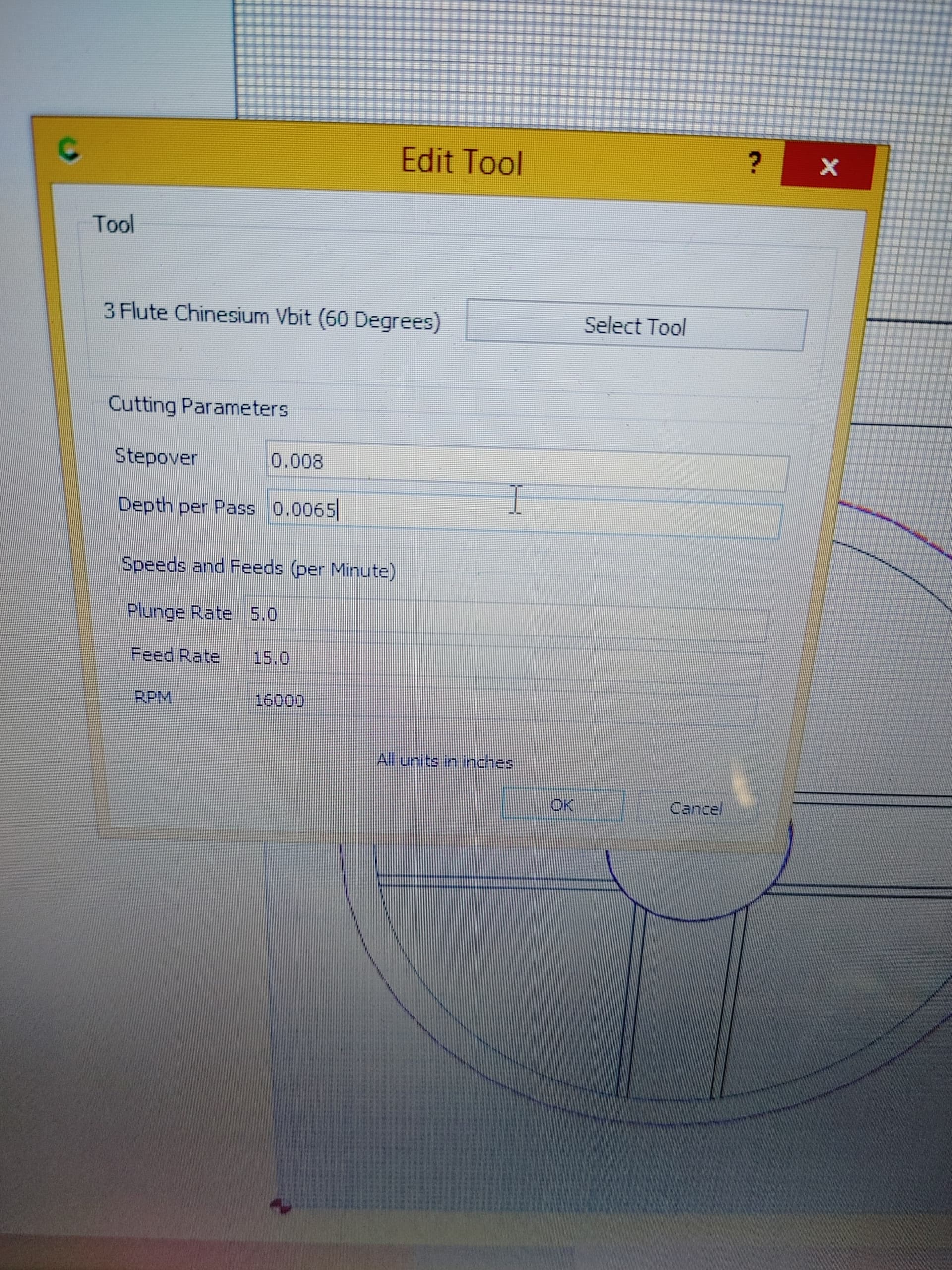

Would you mind sharing speeds and feeds for a 60 degree vbit? I’d need to add it to my tool library for both wood and aluminum. It’s this these ones here: Amazon.ca

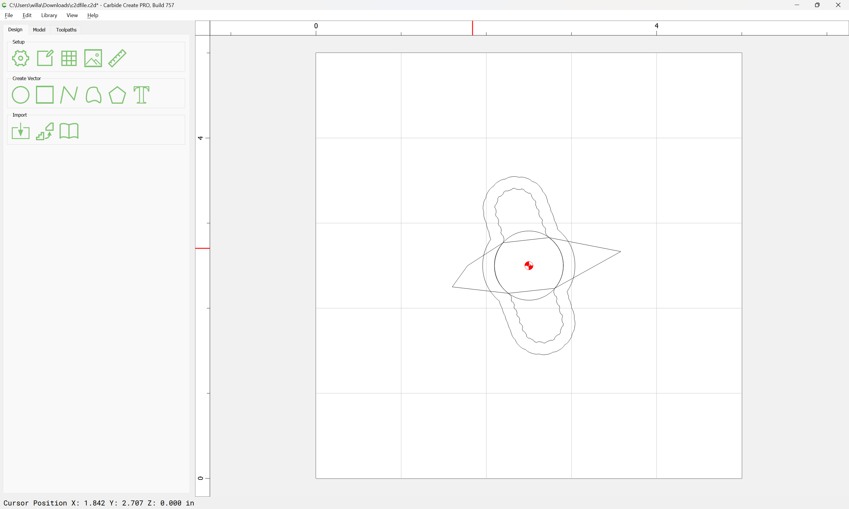

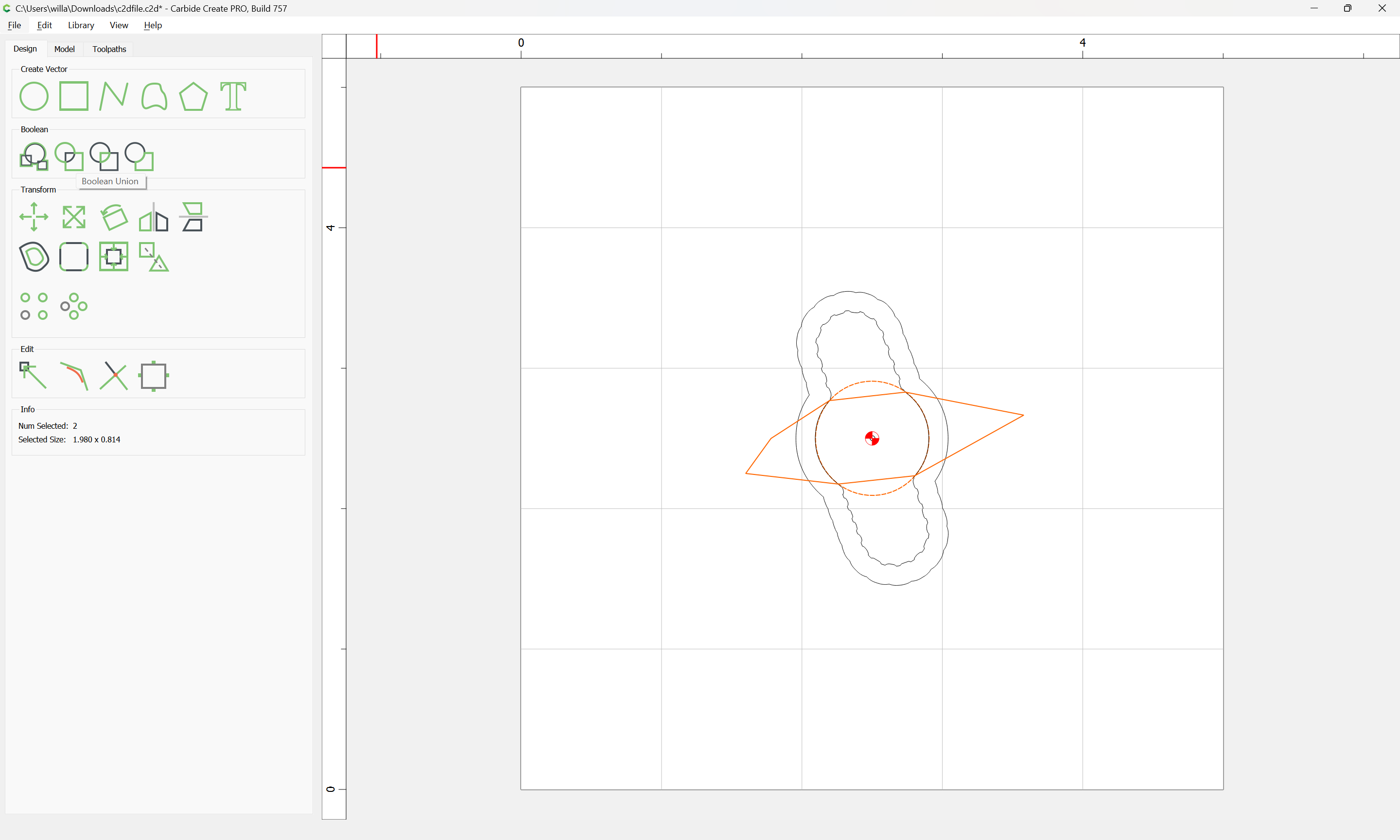

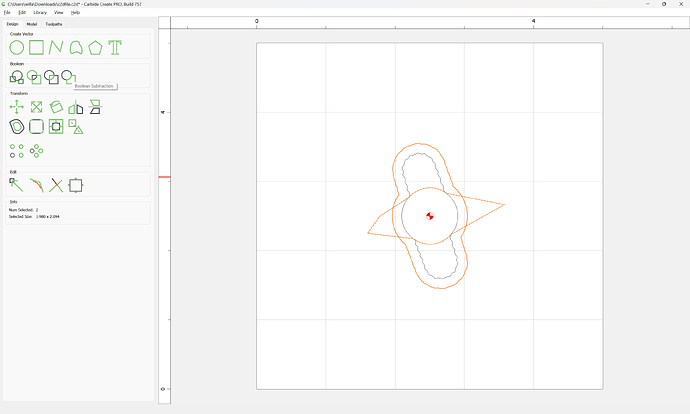

Machine a mirror imaged negative of this as a fixture, insert the part into it, then cut the first toolpath registered w/ the fixture to complete things.
What do you mean by first toolpath registered with the fixture?
I can predict I’m going to have issues zeroing the part once it’s in the fixture. Any ideas on the best way to proceed?
We have feeds and speeds for a 60 degree tool we sell for use in wood/plastics in Carbide Create:
Most V tooling is too delicate for aluminum, unless one avoids engaging the tip and only cuts using the edge.

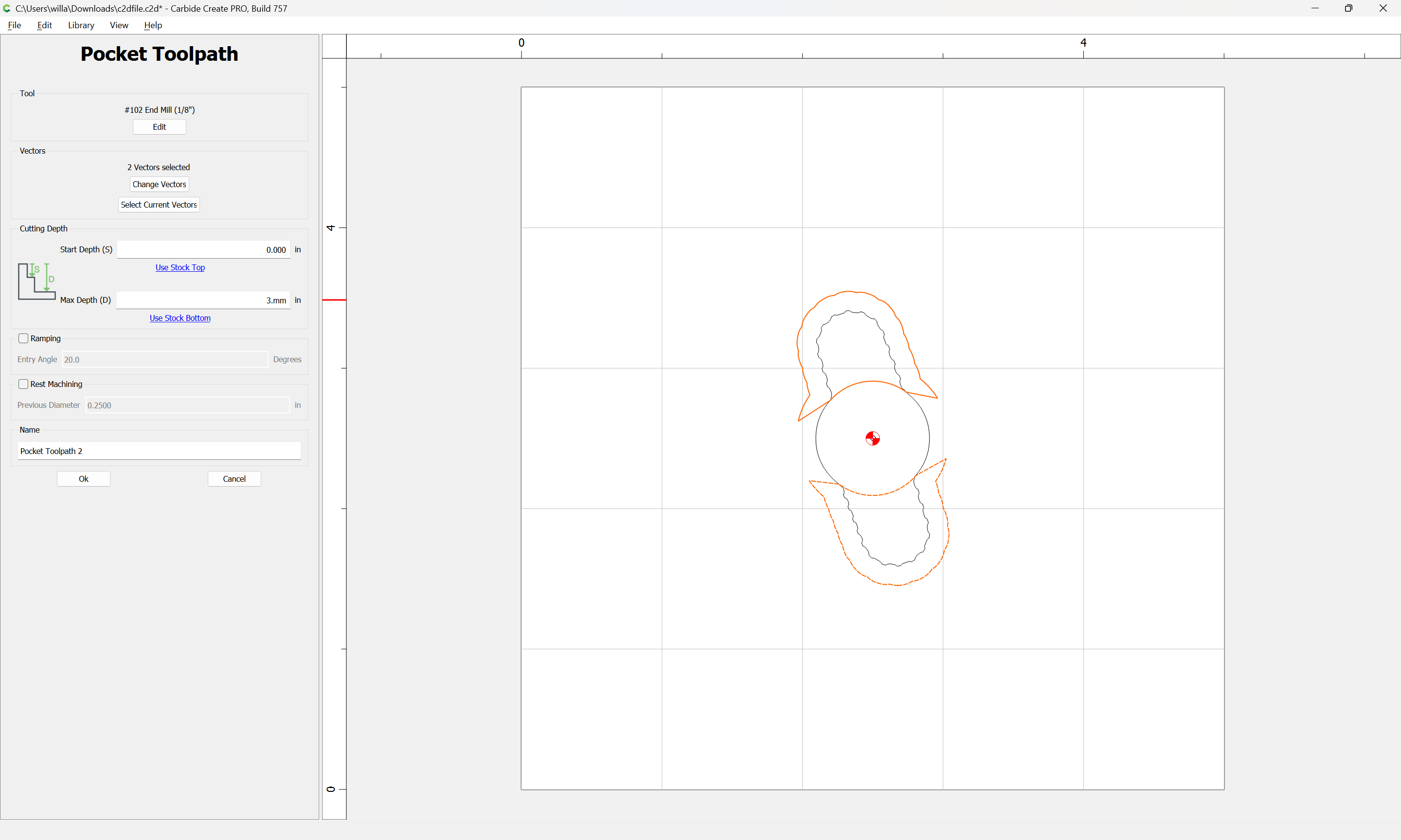

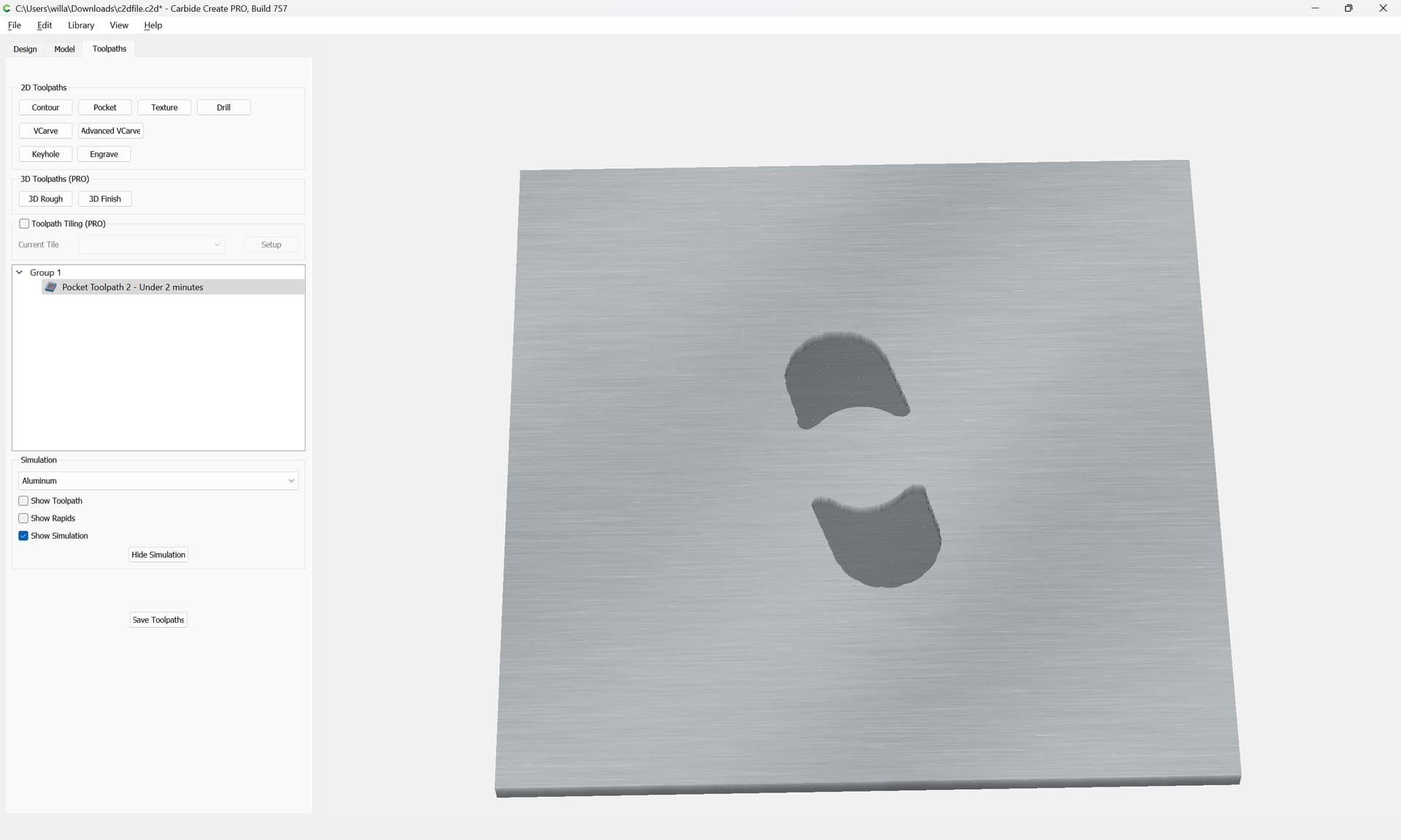

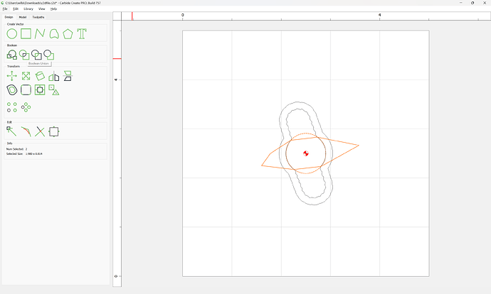

The idea is:
  • mount a piece of stock of a reasonable thickness (greater than 3mm)
  • make a greater than 3mm circular hole in it which is large enough for the circle to fit into:
  • cut that in a suitably stable piece of stock securely clamped in place
It may be helpful to make the origin the center:
With the stock in place, clamp the cut part in place so that it is secure.

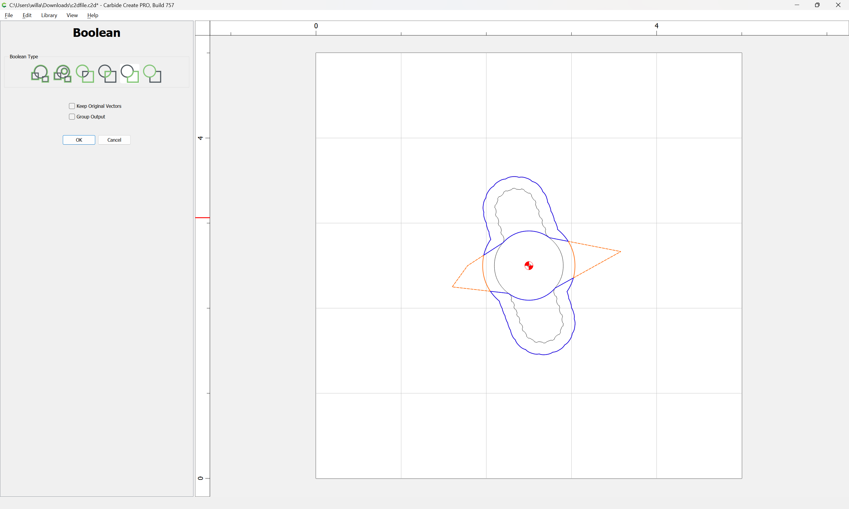

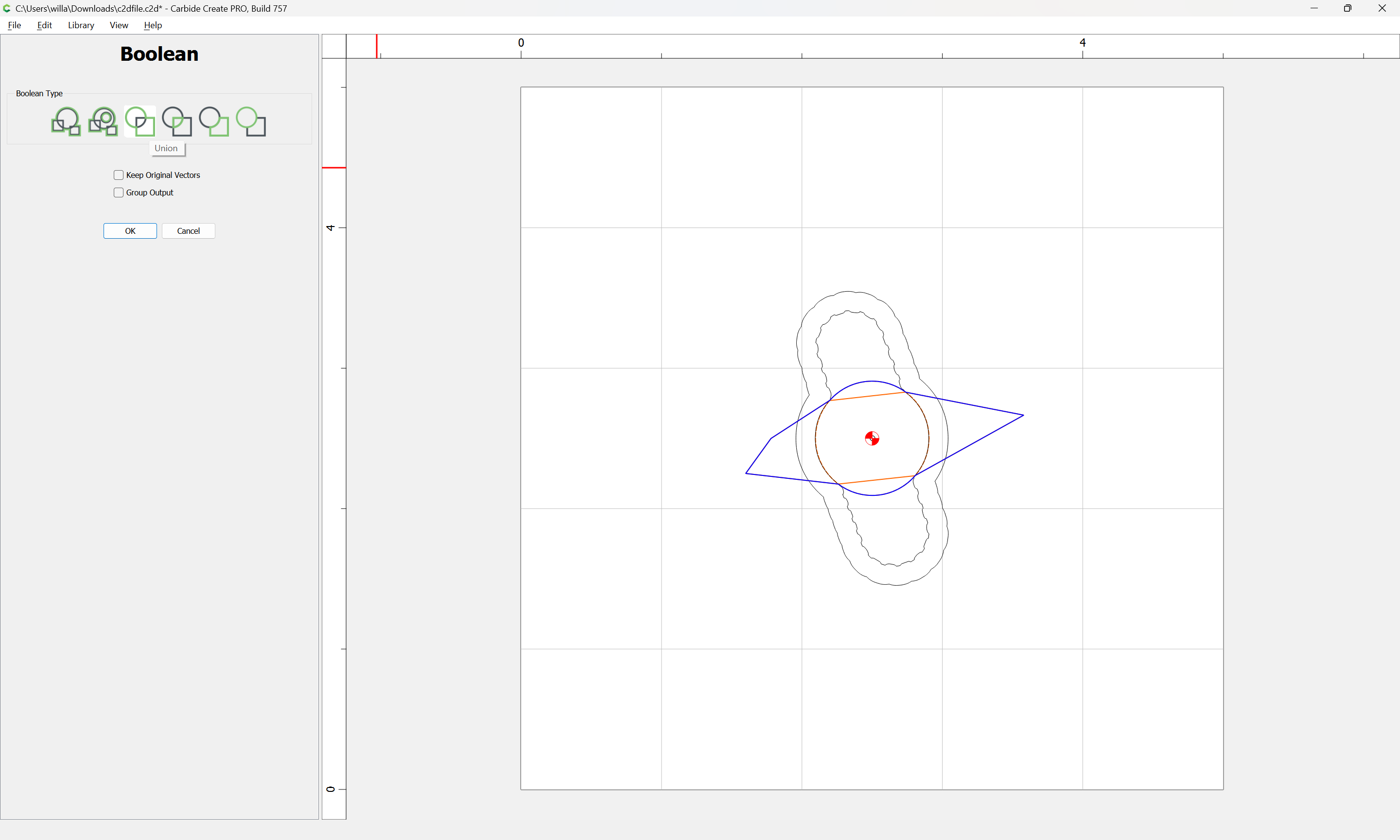

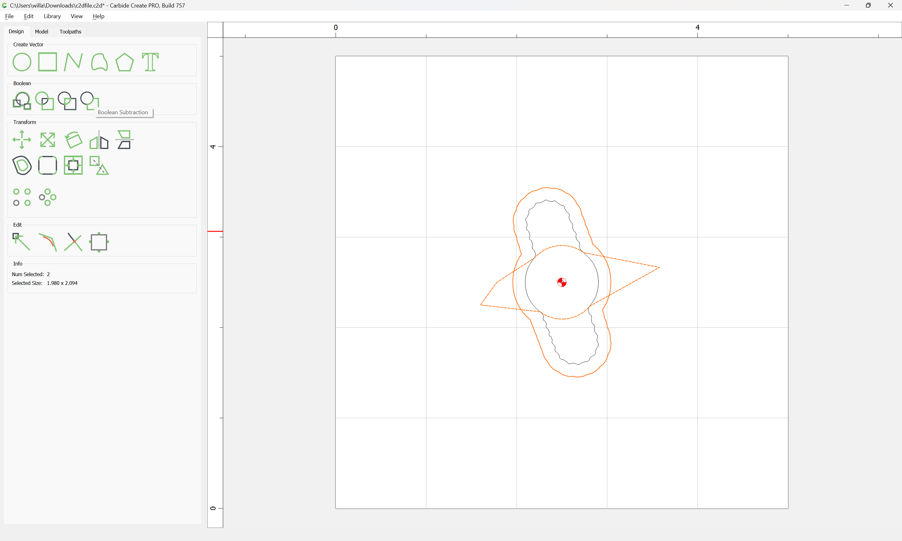

Set up a toolpath which uses a mirror image of the offset geometry and has the sides cut away so as to admit the clamps:

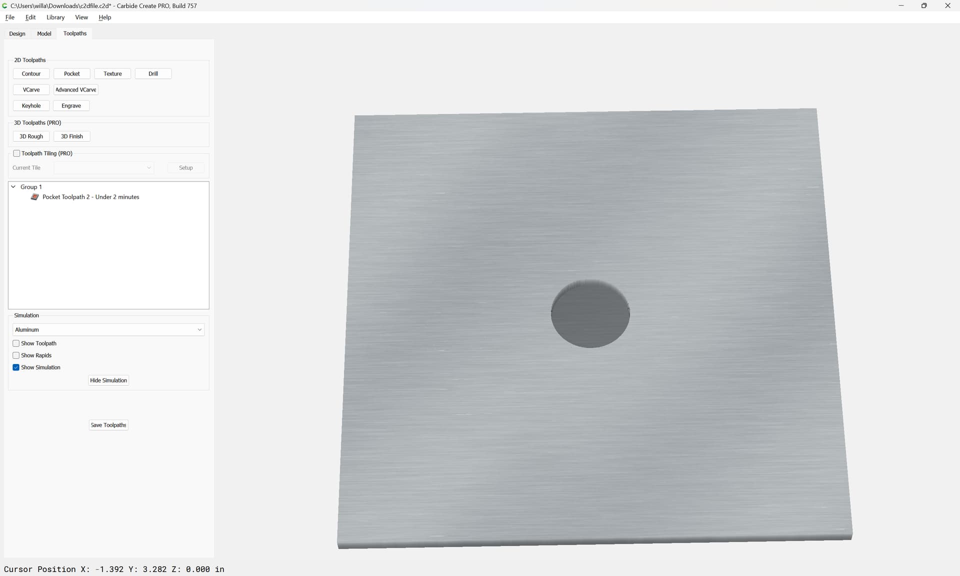

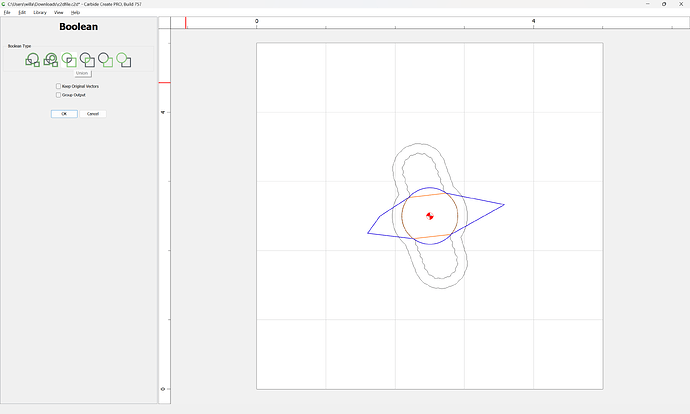

Then subtract this shape from the outline:
OK

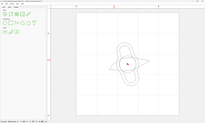

Assign a 3mm deep toolpath:

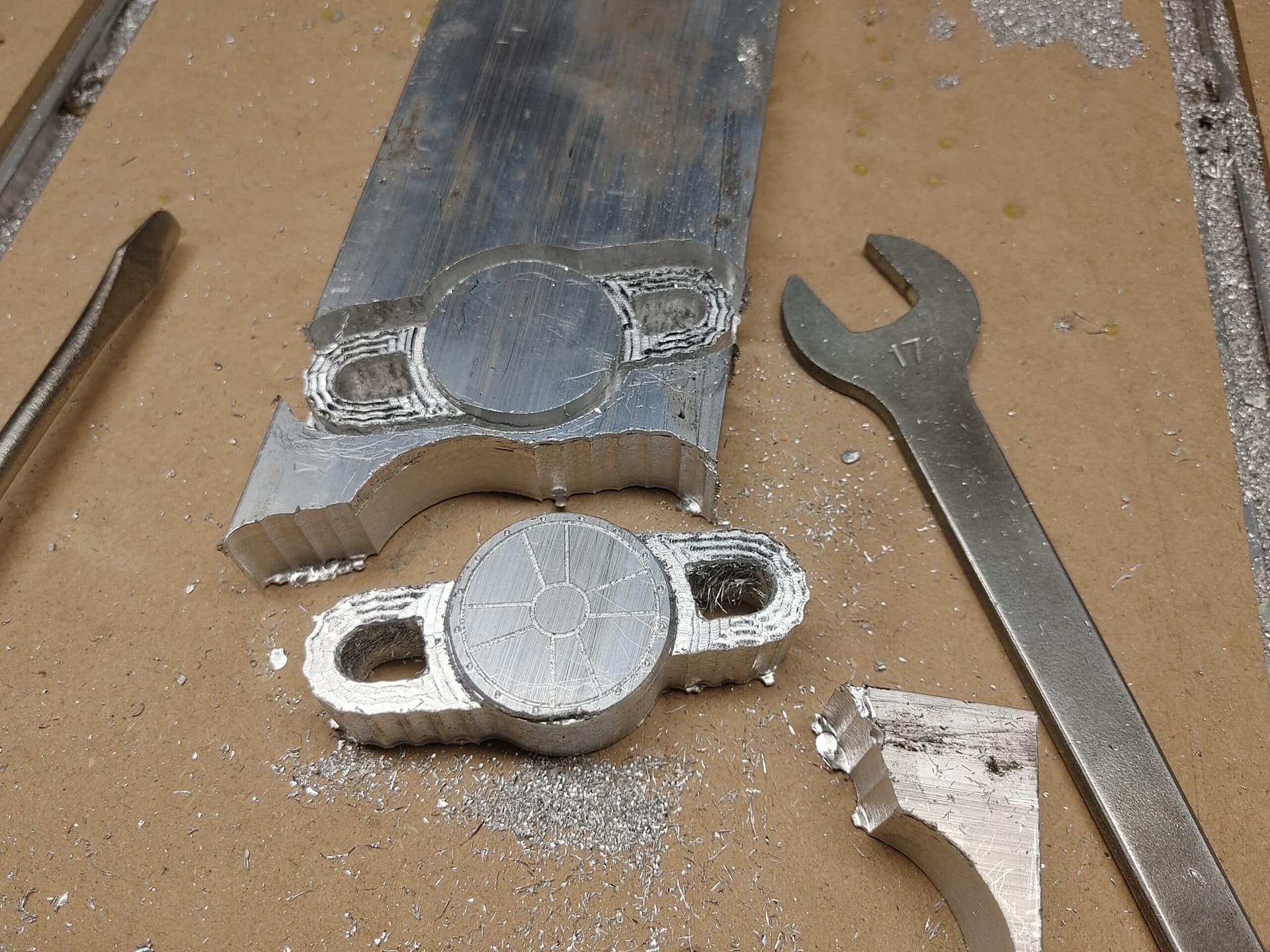

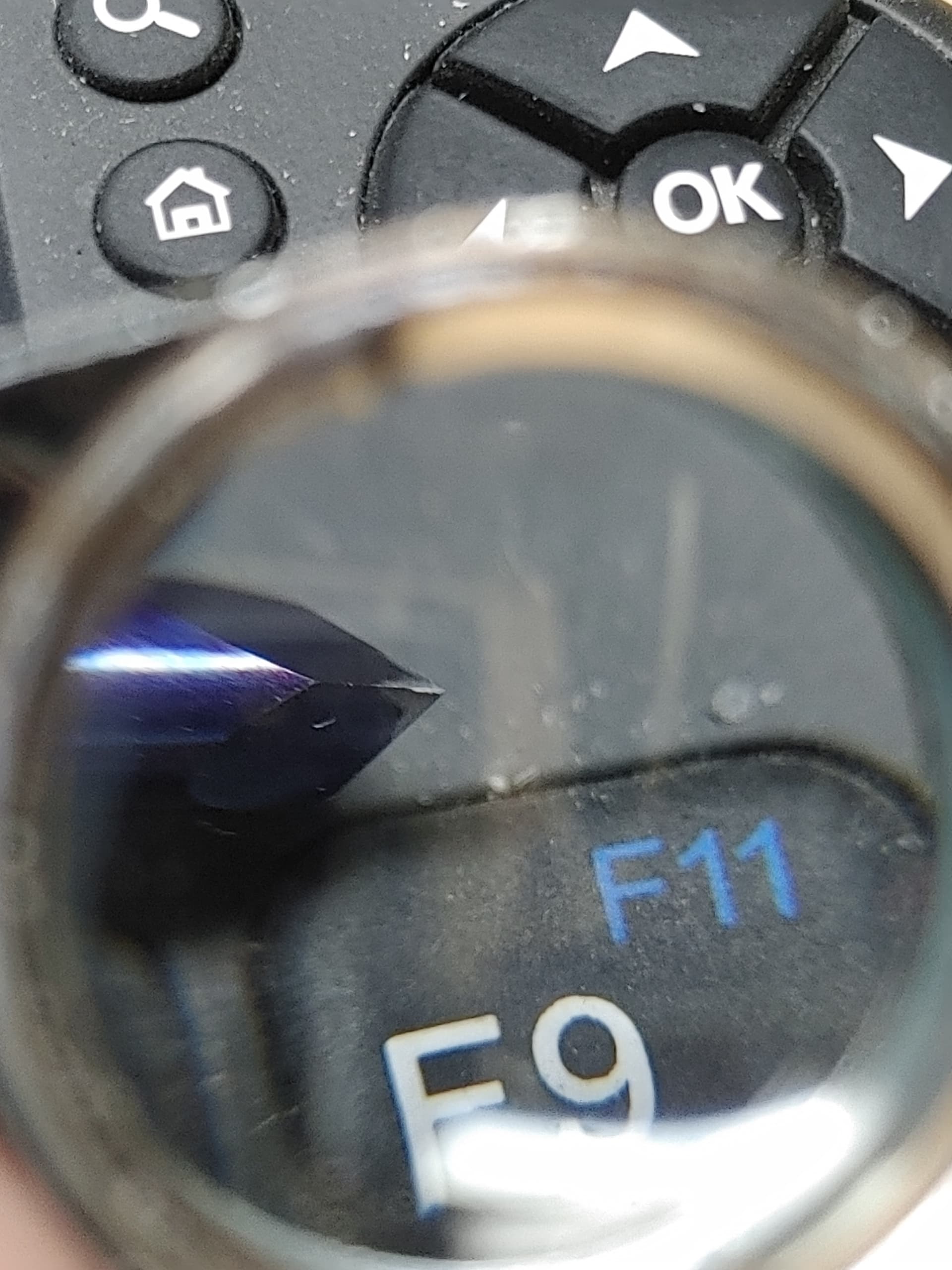

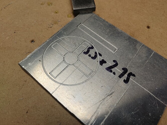

Today I just had a bit of time to play with the vbits. It’s important that I can get them to work with aluminum because pretty much everything I’ll be making and selling requires it.
I did some quick tests and have some promising things to share (attached).
The more conservative depth per pass seems a bit nicer on the machine (less noise). It’s not really making chips very well at that DOC but it seems to work anyway lol.
The bit seemed to hold up well after the small test. Whats seen in the image that looks like a rounded over edge is actually just aluminum that I was able to pick off. No heat on the bit at all.
I did an initial pass then a clean up pass to remove all the build up.

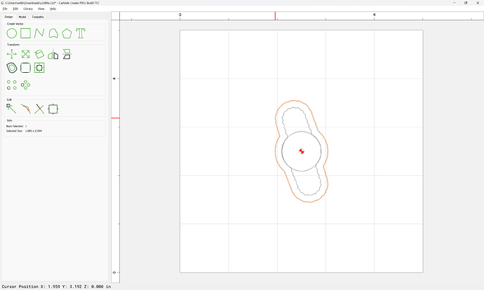

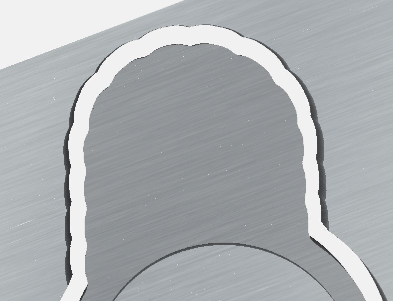

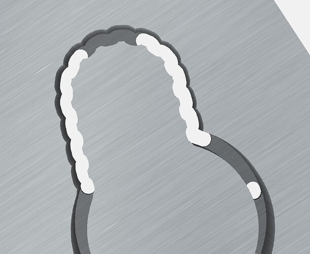

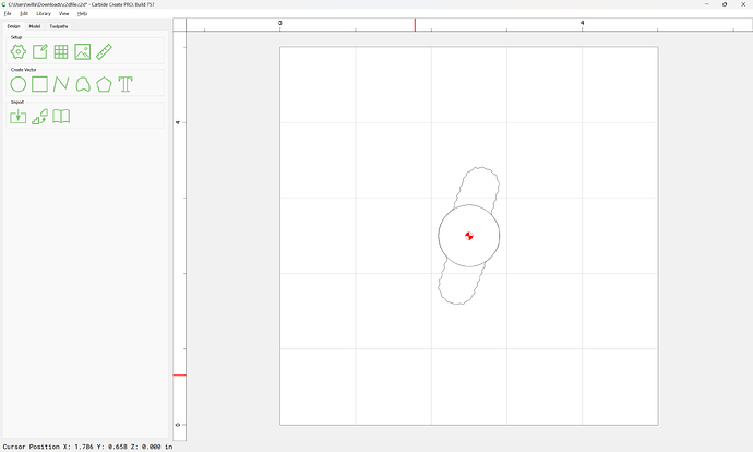

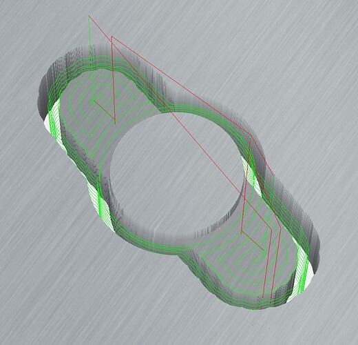

I’ve run into a problem and it’s a bit confusing. Been playing with it for a few hours and I’m not sure if there’s anything I can do to fix it.
When I create the offset at 0.125" (exact measurement of endmill) the edges of my design stay nice and sharp and crisp. When I add the 10% it starts to round over. That 10% is directly impacting the material being cut away from my edges leading to rounded grips (see attached image).
It seems there must be a solution to this but I’m unable to find it.
I assume the 10% is added to prevent slotting around the entire workpiece causing premature wear to the endmill. I could reduce it to 2-5% and the rounding would be less, but it’s still negatively impacting the design. Any solution to this?
10% also ensures that the calculation will be certain of admitting the tool.
Lets say I was trying to machine a clamp which is as precise as possible to the design, would it still be possible to use that technique?
