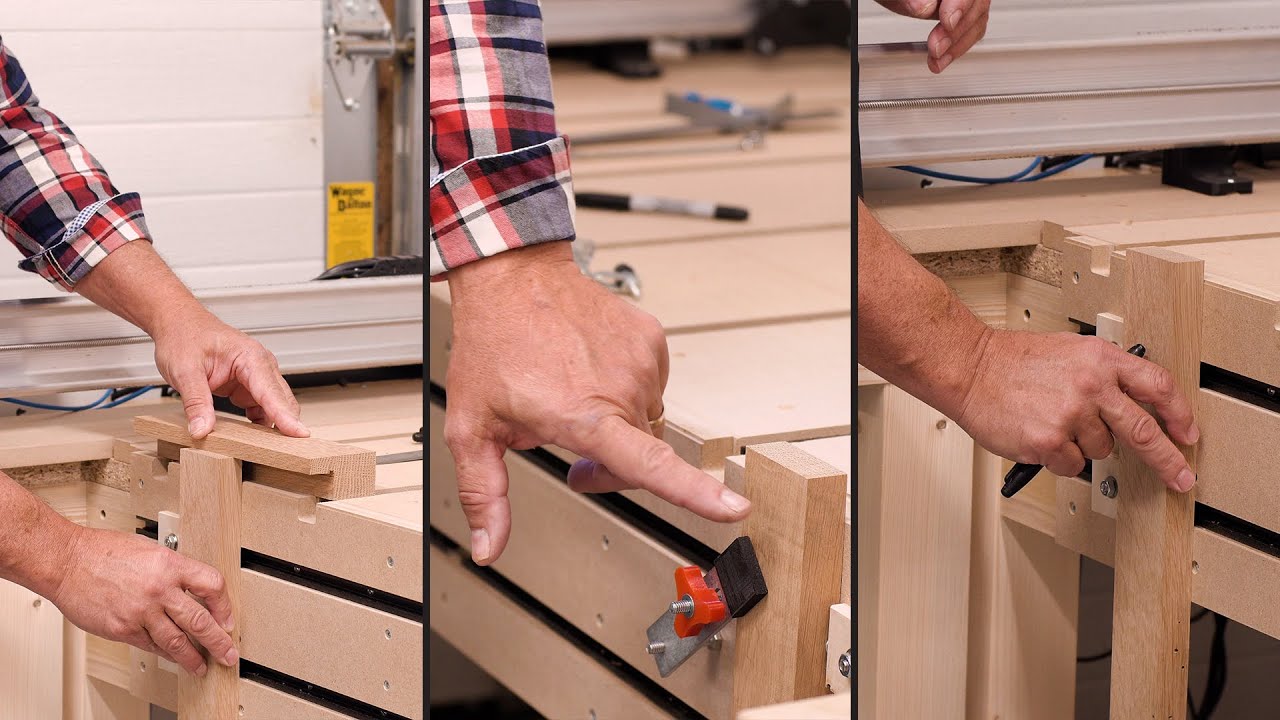

I’ve had a hard time finding good videos on vertical clamping on the CNC. There’s a few people on youtube with Avid cncs that have made ok videos, but this one I found from Scienci Labs has some really good information on workflow, and a simple way to build a front clamping setup. It’s a fairly recent video, and there should be more coming in the series.
