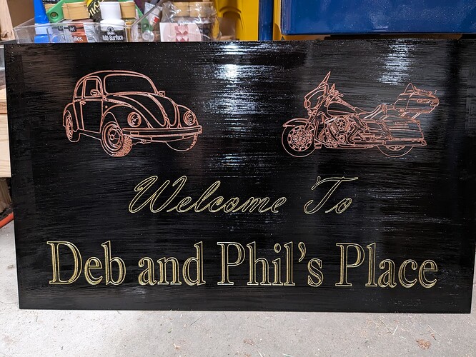

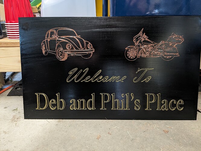

I made a couple of acrylic signs from 3mm cast acrylic. Black and White material. I am using MinWax polyacrylic to seal the acrylic paint.
Using a rattle can I got a lot of bumps.
Using a normal can and a foam brush, I am getting streaks, more like texture from the brush strokes. I had some bubbles, but multiple passes with the brush seemed to remove most of them.
Any words of wisdom ?
It’s not bad, just annoying.

I tried diluting the poly acrylic with distilled water. Eye balled a 10% water volume.
I sanded the first layer with 220 using a palm sander to take out the high spots. I had tried hand sanding 320 but that would have taken too long.
Liberally applied mixture. This was much easier to spread and remove bubble. I had a little more time.
The result is cloudy, but the texture is not too bad.
I am about to toss this one, but tomorrow I will try a buffing wheel, just for the experiment.
I tried 600 wet sanding. The debris is in the engraving, paint lost it’s luster.
I sanded the sealant off in spots.
