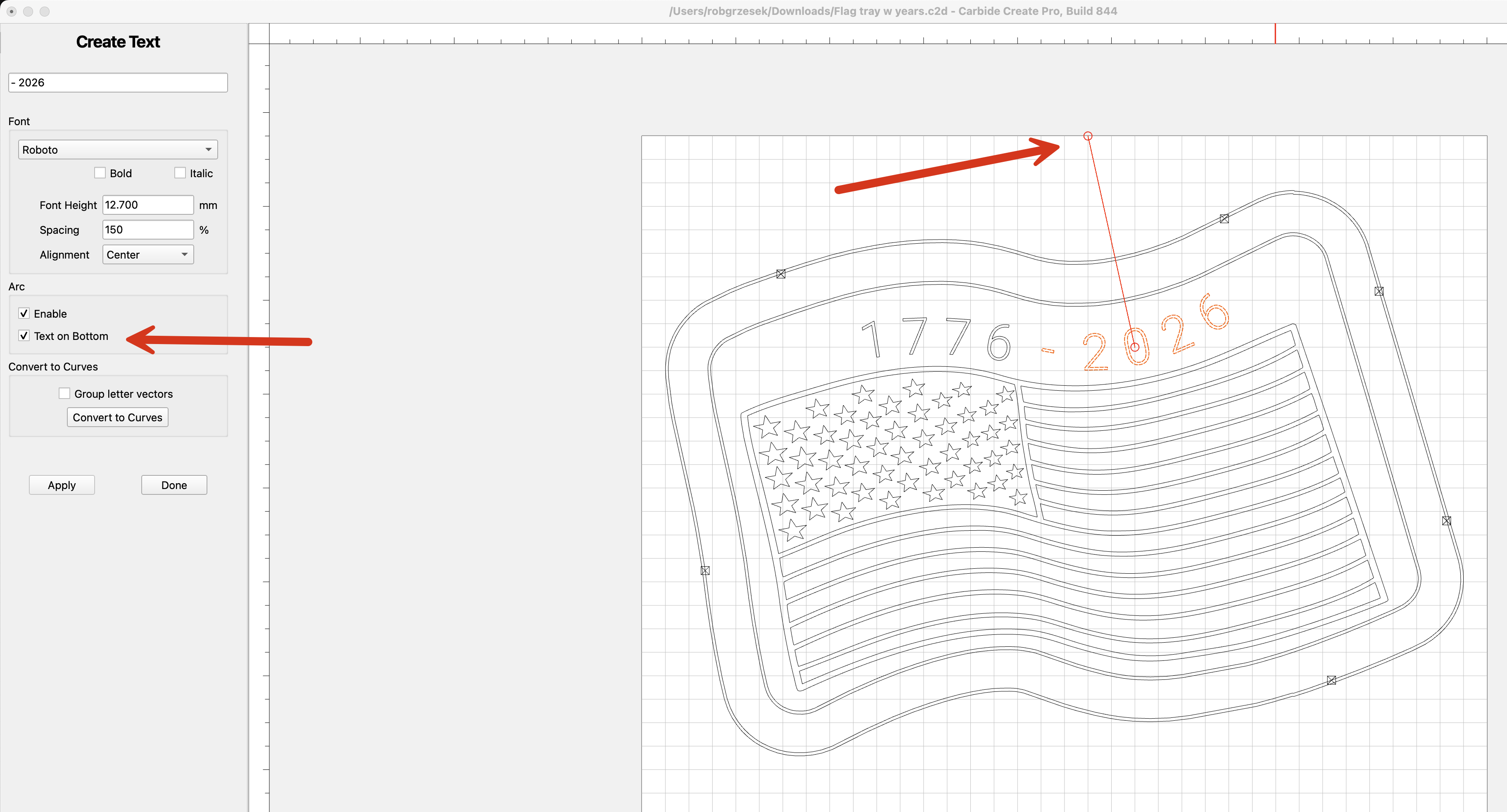

I am making a flag catchall that I would like to have the years 1776-2026 follow the arc of the flag. No problem with the 1776 but I cant seem to get the 2026 to arc the opposite direction. Any help would be appreciated. File is attached.
Flag tray w years.c2d (276 KB)

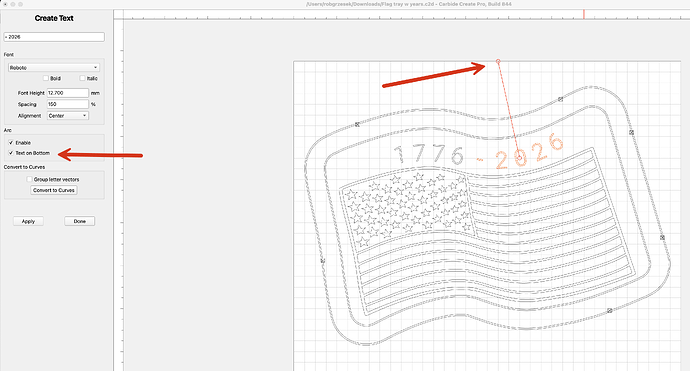

You’d need to click “Text on Bottom” and then move the center point above the text.
Ahhh, thank you, that was the one option I did not try. Problem fixed. Much appreciated.
