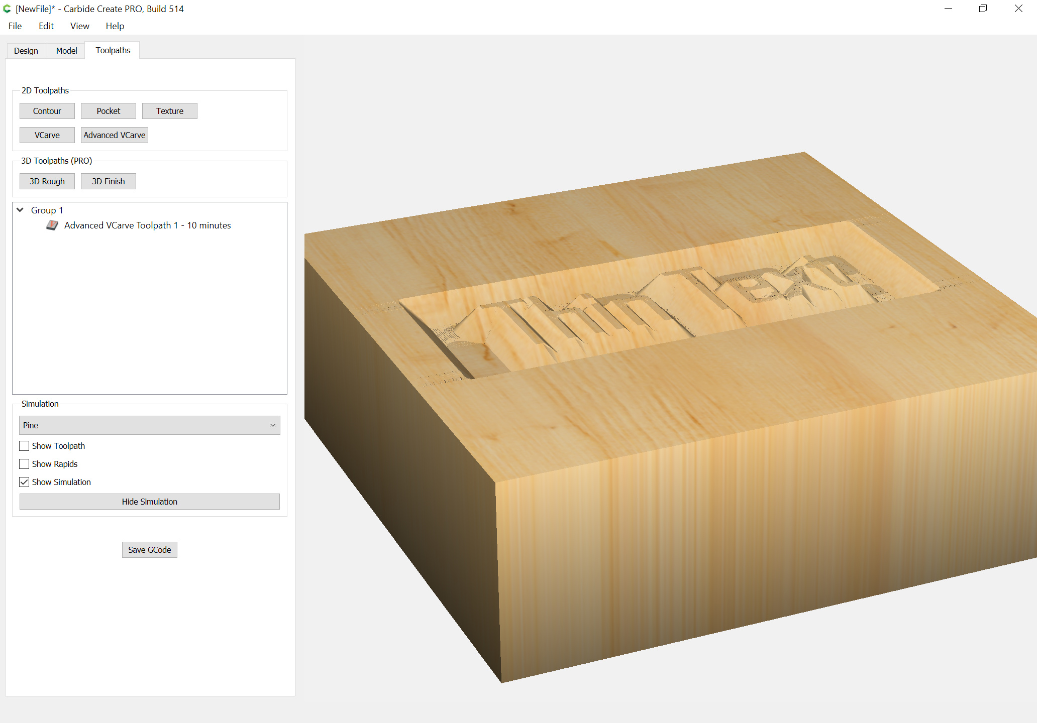

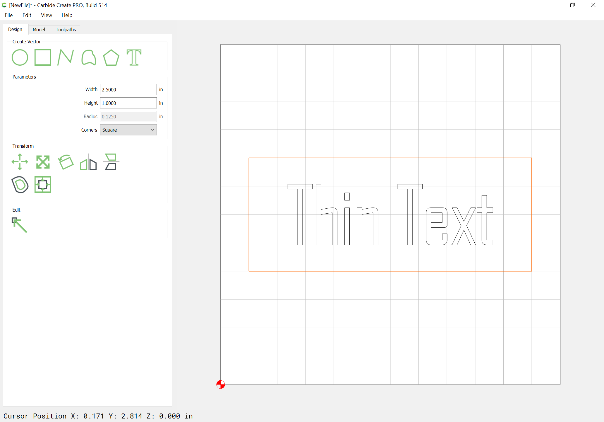

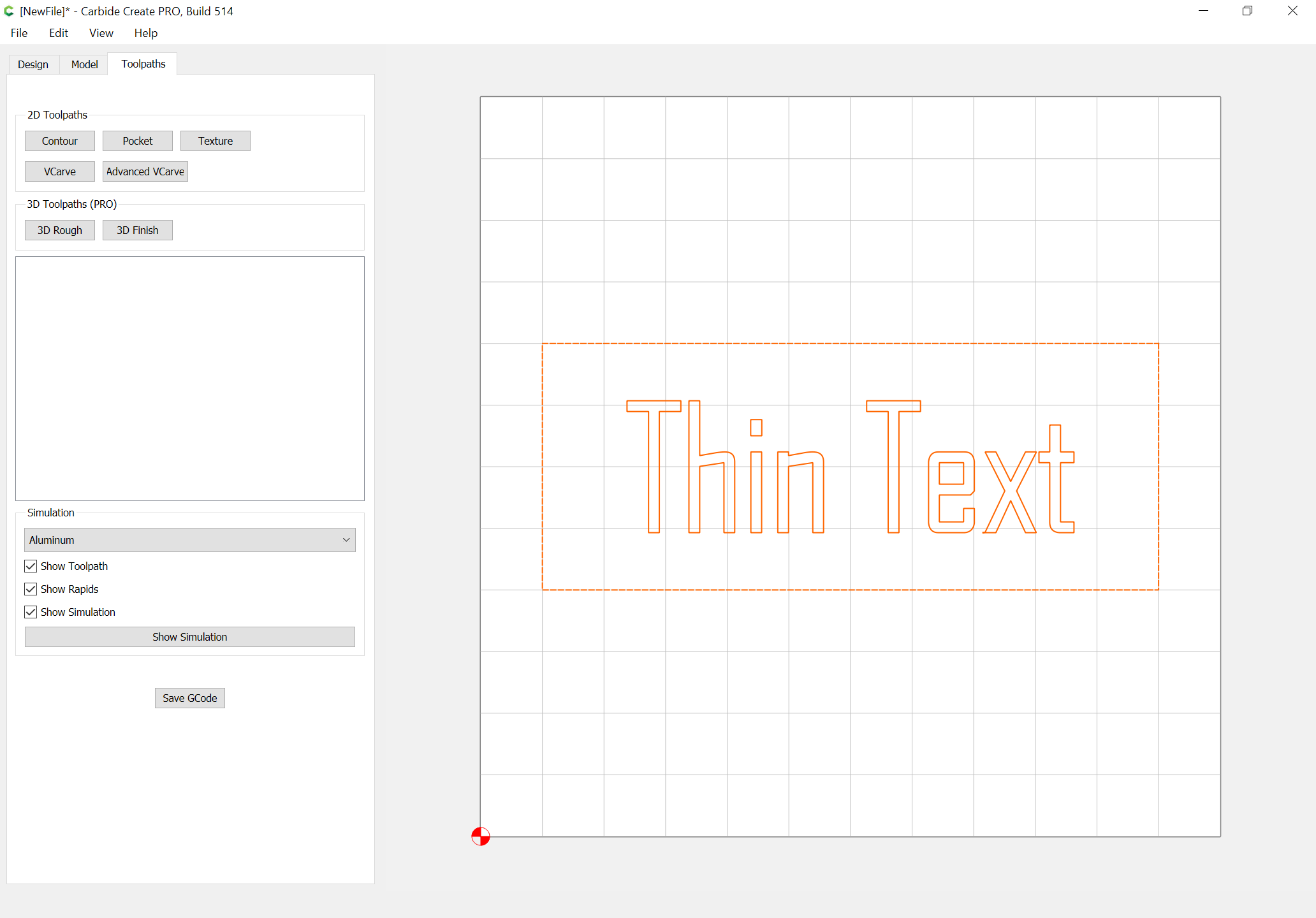

Draw the shape you want around the text:
select it and the text:

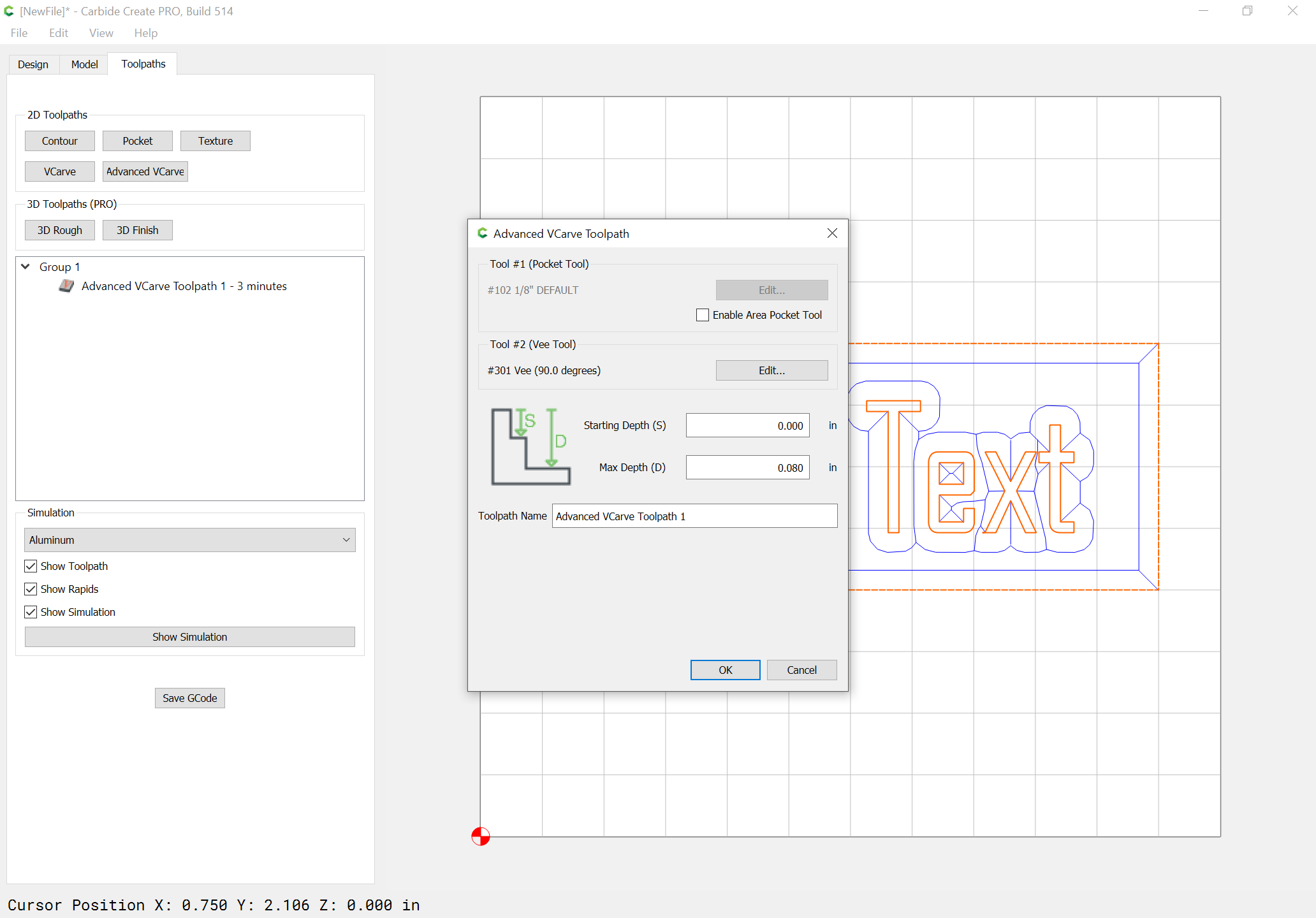

Select Advanced VCarve:
Enable Pocket clearing:
Will this give me a complete cutout of the words or does it keep material as a background?
If you set it to cut all the way through it can cut out:
