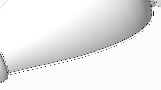

Artefact from 3D finish with 0.25in round endmill
Hi, i need help please (sorry for my english!) i need to make half table legs and when 3D finishing with my round endmill, the Z stop at hight 0 (botthom/back of legs) and let a half round of 0.0625 radius. Even with a pass CONTOUR after, ther will be a 0.011 lips remain!
How can we tell the Gcode generator to go lower until the round radius of the endmill is done ??? Thank’s
Model the design thicker by the radius of the tool.
