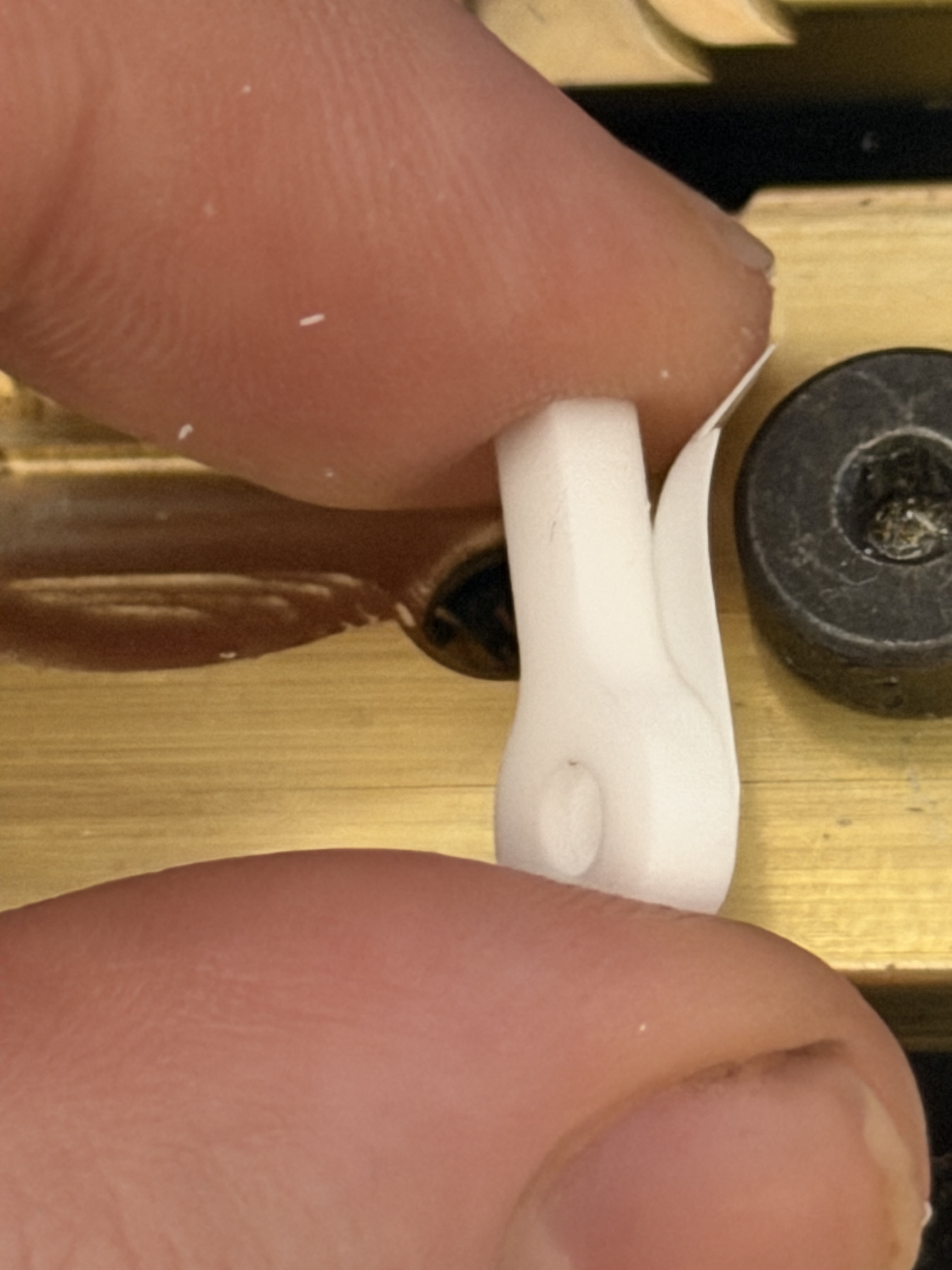

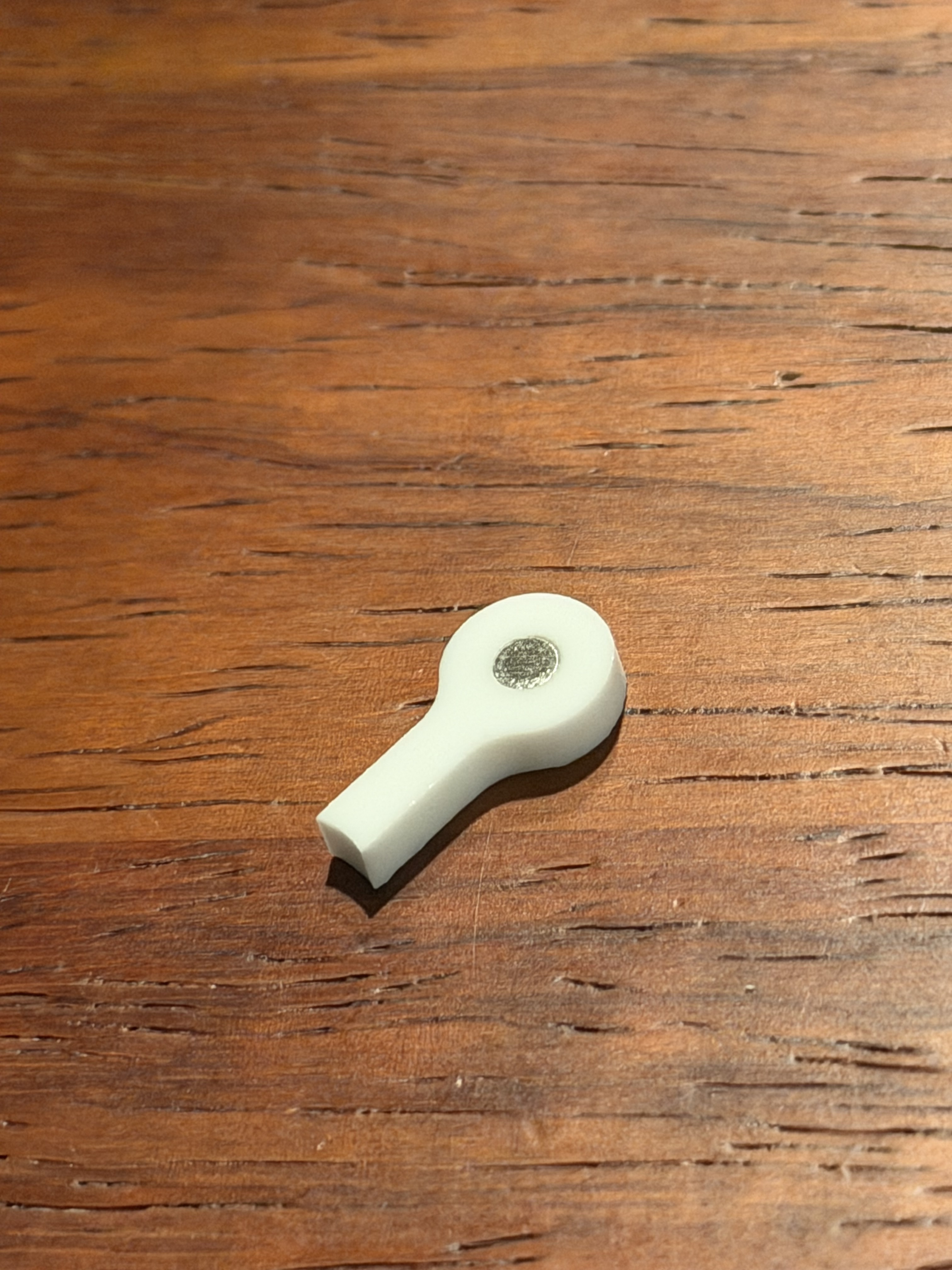

In my limited testing, it’s pretty straightforward. Though I’ve only tested with opaque acrylic so far.
This is what I ended up testing:
Acrylic cement
https://a.co/d/0hAS7IS4
Syringes
https://a.co/d/0fFDo9QE
(I should have bought the 50 pack. These are going to be pretty useful I think)
Tip pack
https://a.co/d/071eHCSn
(Only the absolute thinnest blunt tips are useful for this water thin adhesive)
Cheap mills for practicing acrylic cutting
https://a.co/d/0anY2RV2
(Pretty decent for the cost it seems. Silly sharp which is great for plastics)
Acrylic test pack
https://a.co/d/04bwLyMm
(Rather expensive but seems consistent in thickness, high quality, cast, and sized for my nomad :sweat_smile: fine for prototyping and probably small light boxes)

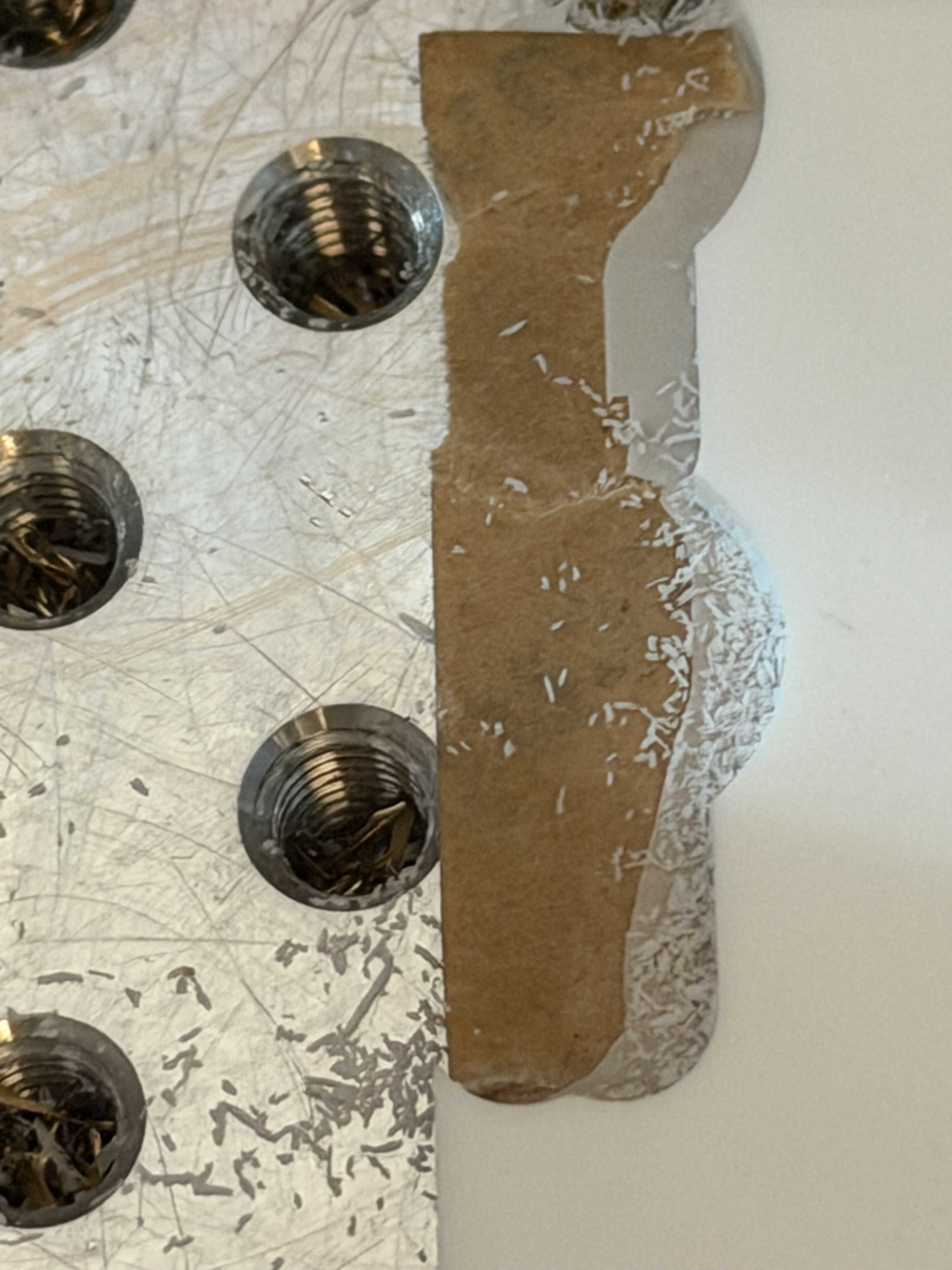

I ended up cutting at full depth, full width,18000rpm, .004in fz
Left about 0.1mm of onion skin and kept the bottom protective paper on. This kept all adhesive off of the tool and the onion skin shears off pretty cleanly. I’ll probably cut a little closer from now on though.
The cutting forces are so low I’d wager most any work holding is fine.
