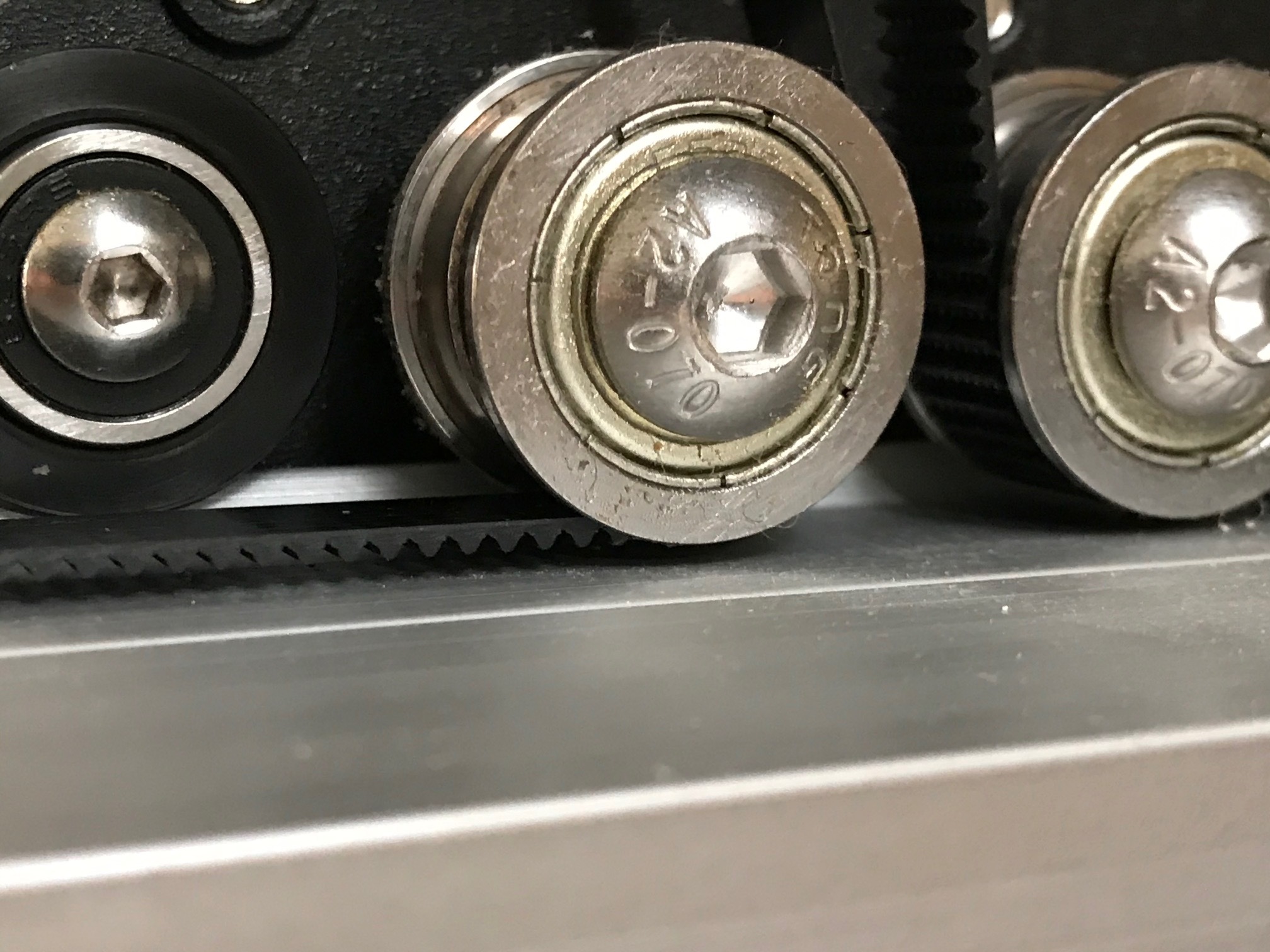

Hi Everyone,I have come to a halt in assembling the belts on the Y axis due to the fact that when I tuck 2 inches around the clamp on the back end of the y axis the 2 inches that is doubled up will not allow the gantry to travel over it to go full distance, it jams on that area.The gap between the idler and the rail is 2 mm and the thickness of the belt is 3mm when doubled up.I can see two options to solve this, one smaller ID idler bearings or move the idlers up 2 mm,not a practical idea though.The other option would be to have a ver short tuck over of the belt on those back clips??Would this cause a problemHave been onto the support team and they have kindly sent replacement y assemblies out but still the same issue.

Hi Brian,I have the mechanics all pulled to pieces at the moment,here is a photo which really does not show the issue but the y axis on both sides will not ride up and over the doubled up belt towards the buckle,I think I have to shorten the belt to only have half an inch coming out from the buckle so as to get the homing switches to work.Here is the photo of the y axis stopped at the double up.

here is the photo
I see the top and bottom teeth do not engage completely, is that just on that specific picture or do they look like that when the gantry is far from the plates too ?

Hi Julien,that photo is me trying to get the idler over the belts which were just free standing after I pulled the machine to bits again,I think forcing the idler at the doubled up belt has pushed the top belt out a little.Looks like Scott has the solution I need to go.The half inch from the buckle looks like it should hold.I will use the tape for all the other ends as I noticed when I did them It spread out.
Thanks for posting the picture, Graham. I wanted to see what Julien had commented on, how the folded over belts were in mesh. Also, how the tension brackets looked. Anyways…

Hi Brian,just at the rear as it is a confined area,with the belt at a 2 inch overlap,the pulley as I call it has to ride over it to get to the back homing switch.The front has a lot more area.An interesting point I doubled up the belt and put it on the X axis and the carriage goes over it no problems,just an extra 1 mm gap difference in idler to rail difference.
