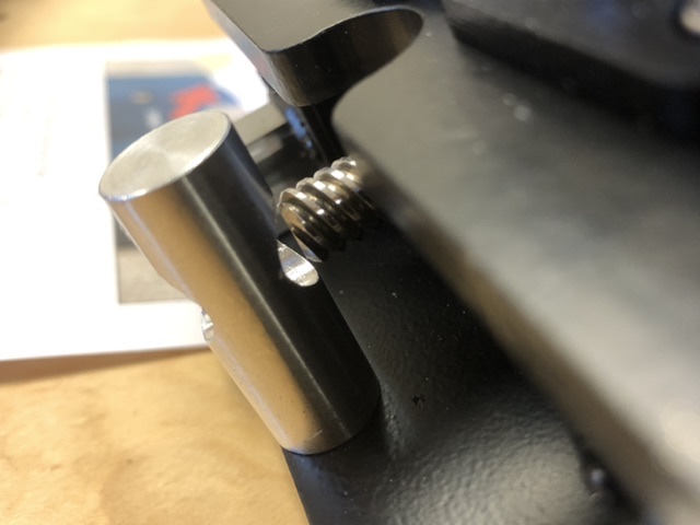

Second question - on the Z-Plus should the screw go into the bottom limit barrel nut thing or be separate?
I lined mine up so it could pass through it easily.
The hole is only there to ease fitment, it’s nice to have it lined up as @rcamber has, but it doesn’t necessarily have to touch.
