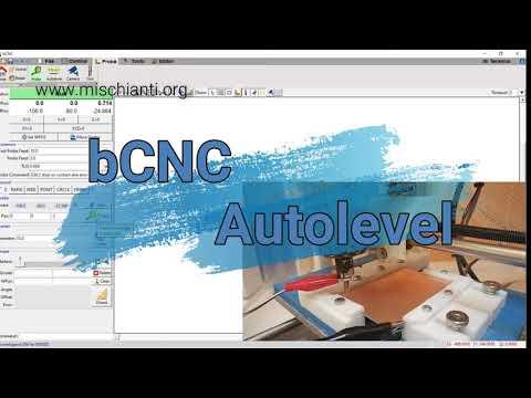

Carvera has auto prob leveling. Is that something carbide 3d can do with software for the Nomad machines? I imagine with a touch probe and software it can be done. Plus that would help keep pace with a competitor. That would be incredibly helpful for me.
This feature is available in various 3rd party opensource tools such as:

I do up to 0.006 inch engraving on precut soft metals. If the metal has a slight bow my engraving will just touch the metal and if slightly high I can break the tip off the tapered carbide engraving bit.
I suspect a feature like that is quite ambitious for Carbide Motion. But you never know, can’t hurt to ask.
In the meantime, can you come up with a clamping system that holds the material flat? Setting your Z height closer to the engraving, like in the center of the part rather than the corner might help if the cup/bow isn’t too extreme.
