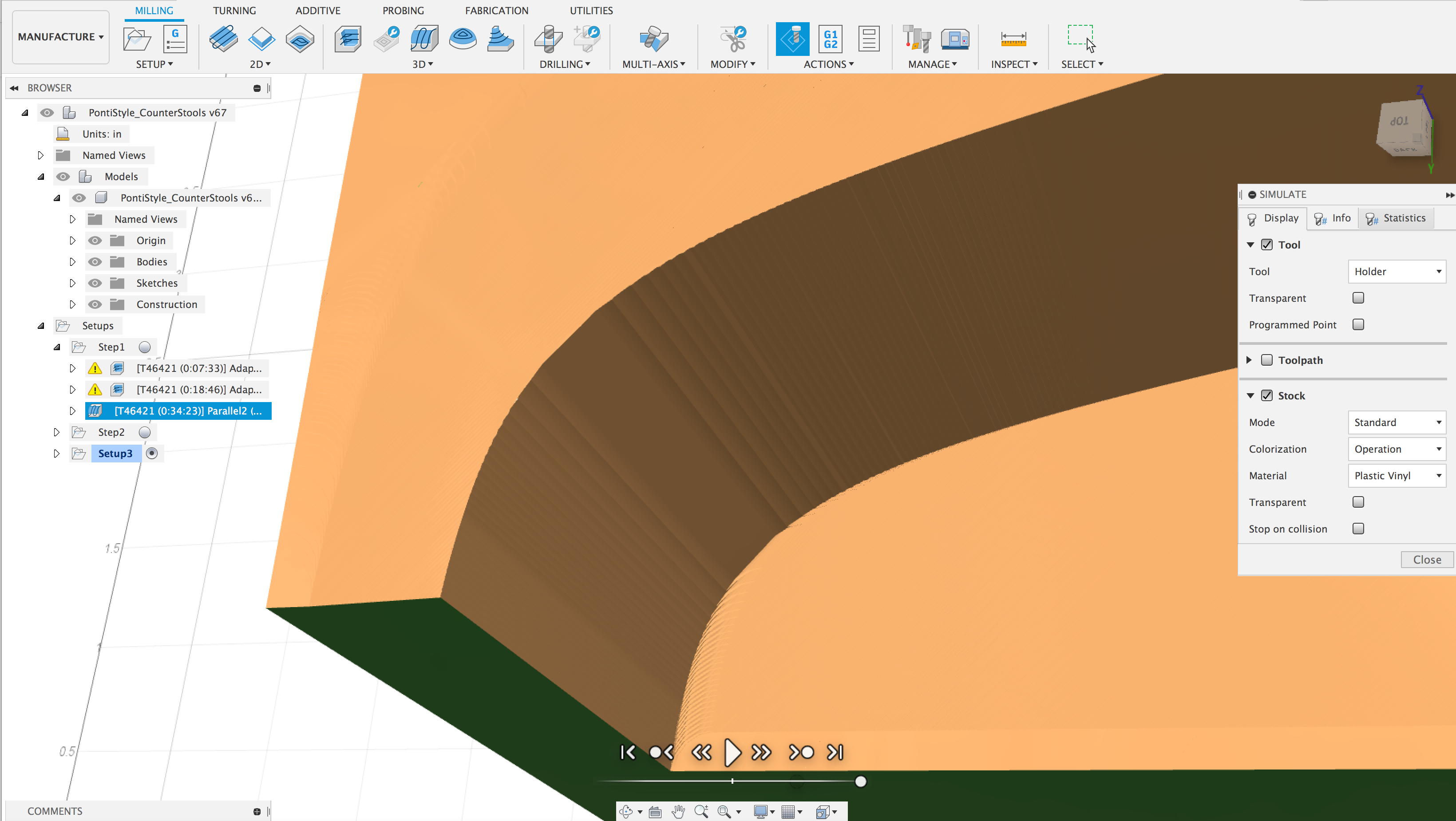

Actually, almost all good the 1st setups parallel pass has done this twice now. But only on the right side. :man_shrugging:t3:
Left is okay?
Looks good!
If you use a 2d contour referenced off the top edge before using your finishing toolpath it shouldn’t hit any high load areas. Vertical walls like that are tough.
What does your simulation show?
Shows that this radius’ed section of the vertical wall is being skipped by the toolpath, but only on the right side.
