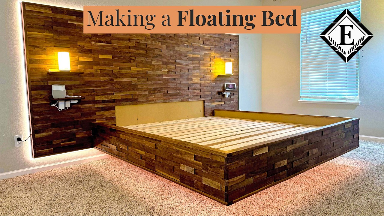

While I was fixing those issues, I decided to take some time and check off a honey due with a Cali king floating bed frame with a custom head board.
I used all my walnut scraps and the frame was made from my old work bench from the old house. Just have the skirts left with the walnut panels. :rofl:

I also finished up the bed build, that turned out pretty comfy…
