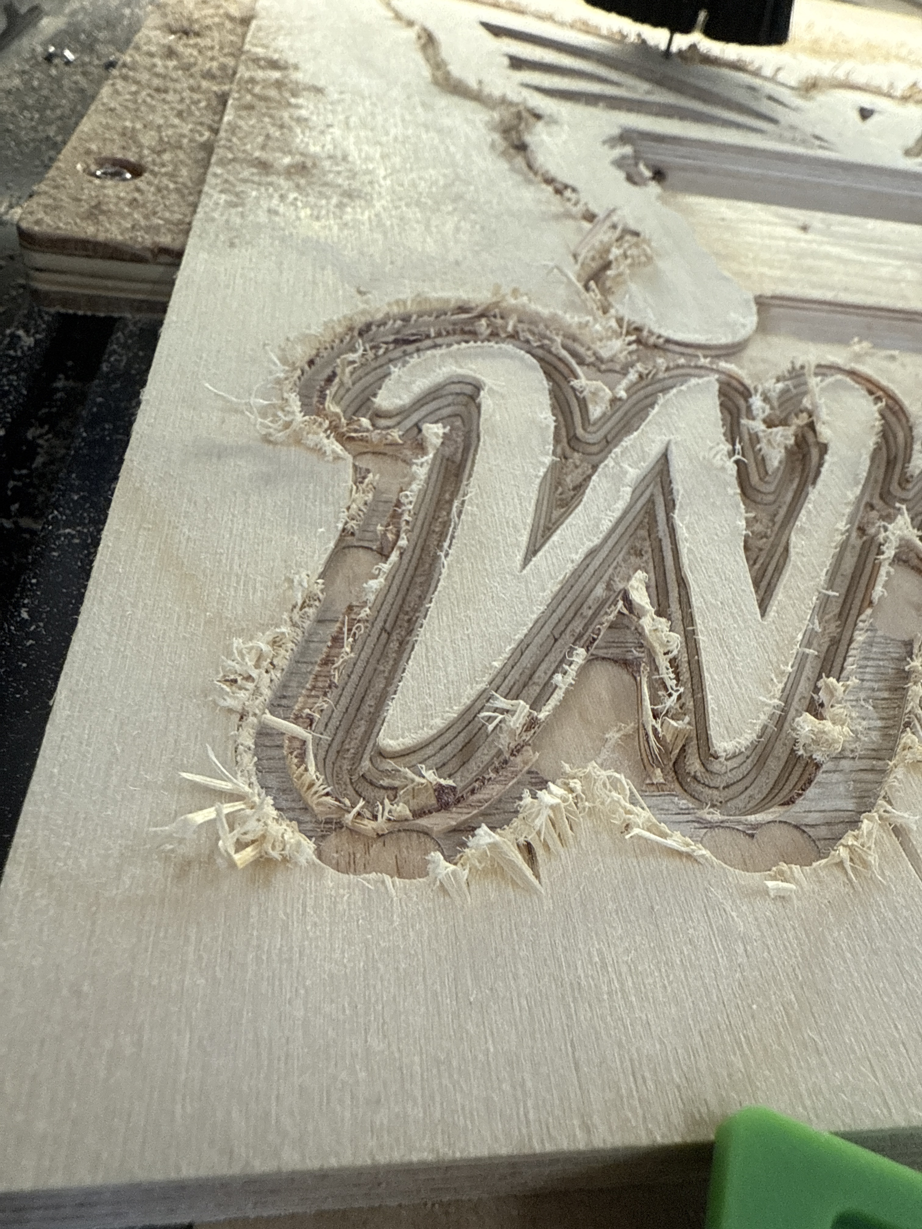

Bad “tear out” wrong bit or dull?
So wrong bit?
Dull bit?
Feed rate?
Just looking for some educated opinions.
Nomad tools #102 square .125 .5”loc 2fl 1.5 OAL
Should have put that in my post.
my guess is dull tool. post your feeds and speeds?
What kind of plywood is that? I’ve had similar results when running a test cut in a piece of scrap plywood that was laying around my garage.
Upcut mills will have a hard time making clean cuts on plywood. I personally would cut straight to trying a downcut or compression bit.
Definitely need a downcut bit - at least to run around the outside perimeter of the letter carve.
But the only part of cutting plywood sheet material to use up-cut on is the last layer against the CNC bed - hence why compression bits are often used.

That seems really bad regardless of the tool and material type. You also have a ton of deflection. I’d check that nothing is able to move. Make sure the material is rigidly held down and that you can’t move the spindle/router around by hand (with it off).
Another thing that I’ve seen that does this if it’s a spindle is the spindle spinning backwards. So if you have a spindle make sure that it’s spinning the right direction.
Plunge 18
Feed 60
Rpm 18000
1/2 Birch plywood.
Spindle rotation? Heck to fast to see. Old eyes. Just plugged it in

Where you using a flat end mill with a Vcarve tool path? I ask due tot corner points on several of the pockets on the wings.
That’s fairly slow. That works out to only a 0.0017" chipload (Feed / RPM / Flutes). I’d normally have people run a minimum of a 0.002" chipload (72 IPM at 18K RPM) in that material. We regularly have customers run at a 5% chipload with 2 flute 1/8" shank tools. That’s a 0.00625" chipload or 225 IPM at 18K RPM. Not saying I’d run that as it will depend on the tool, material, and machine. But you shouldn’t be even close to a limit there.
Might run into deflection issues depending on the pass depth. I wouldn’t expect to see this much with that feed and speed though. How deep are you going per pass?
If you can, I’d run a higher RPM. The higher the surface speed (RPM) the more shear the tool has and that can help clean up the cut in soft materials. You can go too high on this but for 1/8" even just 800 SFM is over 24K RPM. You also need to increase your feed proportionally to maintain the chipload or you could lose any benefit.
Just turn the spindle on and off. You should be able to tell what direction it’s spinning as it slows down.
What did you have to do to get it cleaner? If it was lower the feed by a ton I’d say either an EXTREMELY dull tool or incorrect spindle direction.

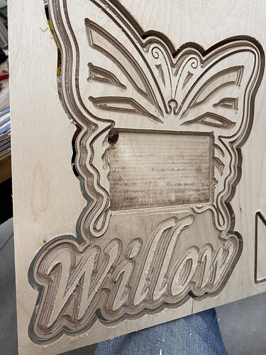

I don’t know how I got the corner points I thought it might have been how it was drawn…
but it looks like I might of,
[Processing: willow.c2d…]
I ended cleaning it up with another vbit and also used end mill to help give it some depth. May not be able to recreate the finial project. but I think it turn out pretty good. Going to paint it different colors. its for my granddaughter.
