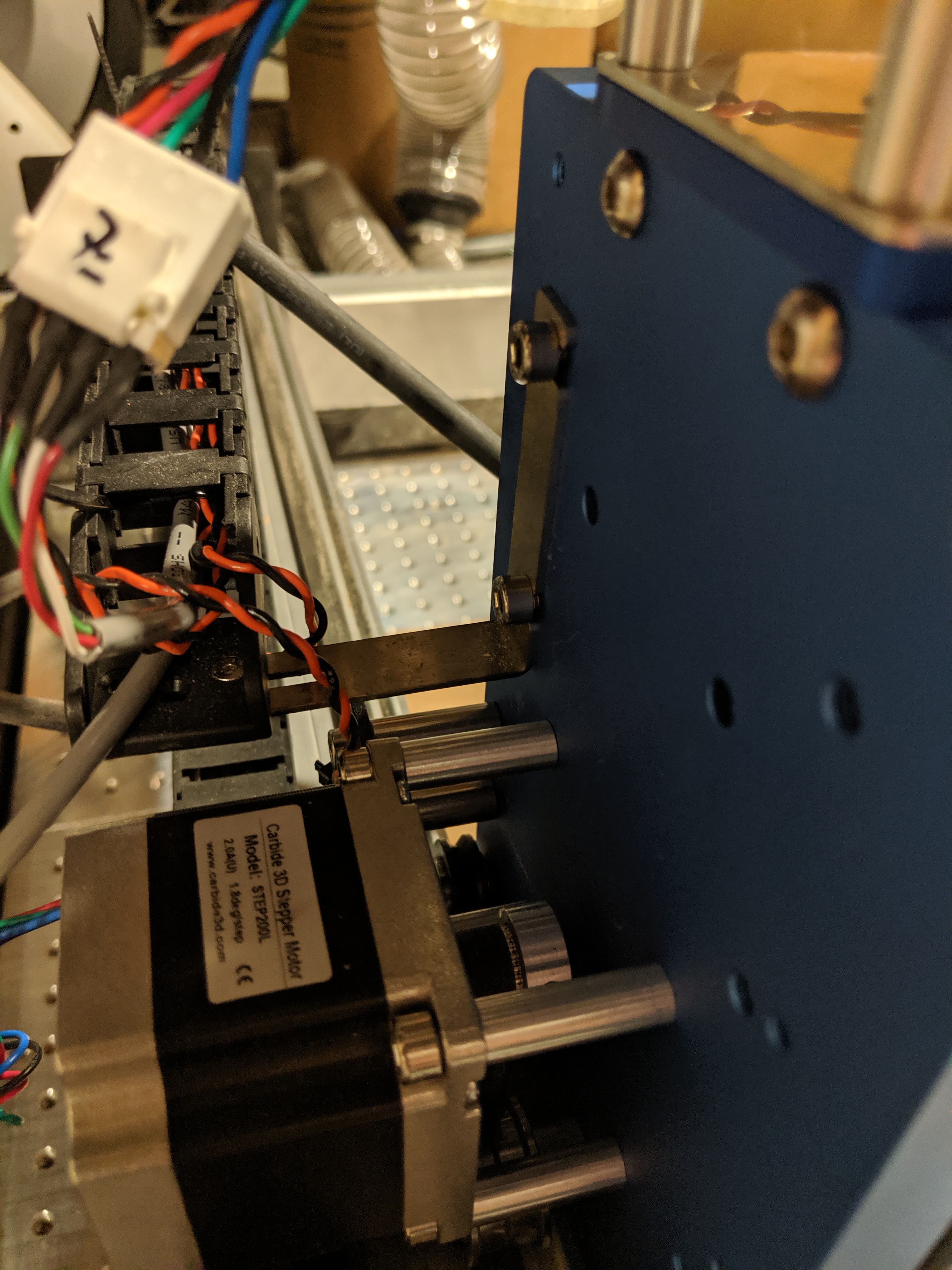

Can i reinstall my limit switch where is suppose to go on the HDZ
Get in touch with support and we’ll get it worked out for you.

mostly (but not entirely) through the assembly, few things the instructions should be edited for:
- the bottom vwheel assembly, the nuts are on the other side of the plate; it’s a bit of a wiggle, and the document does not say this… easy edit to avoid confusion
- the plate for the Z axis limit switches is not in the picture of the document.
- for the Z-limit switch , the doc says “using your existing hardware” but the screw of the original hardware is not the right screw. The package has a replacement screw included that is shorter and that one does fit.
- the document does not say when you need to put the X belt back through the pulleys over the motor… doing it at the end is not a gret place to do it (had to disassemble one of the pulleys and wiggle it through)
