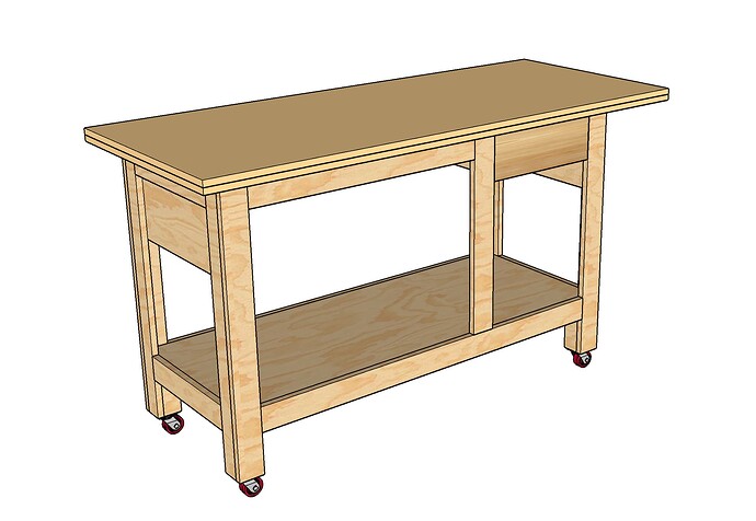

Just bought the Shapeoko 5 Pro 4x4, so it hasn’t arrived yet. Preparing to make a custom table for it. What is the dimension from the table surface to the top of the bed surface of the cnc? (bottom of material, trying to align with existing nearby work surface.)
From the bottom of the machine base frame members to the top of the T-track surface is ~43mm.

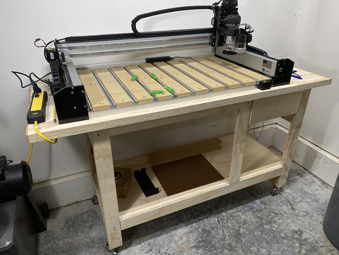

I built a custom table my SPro XL. Do you know how to use SketchUp? If so, let me know; I’ll send you the file.
Table came out great.
