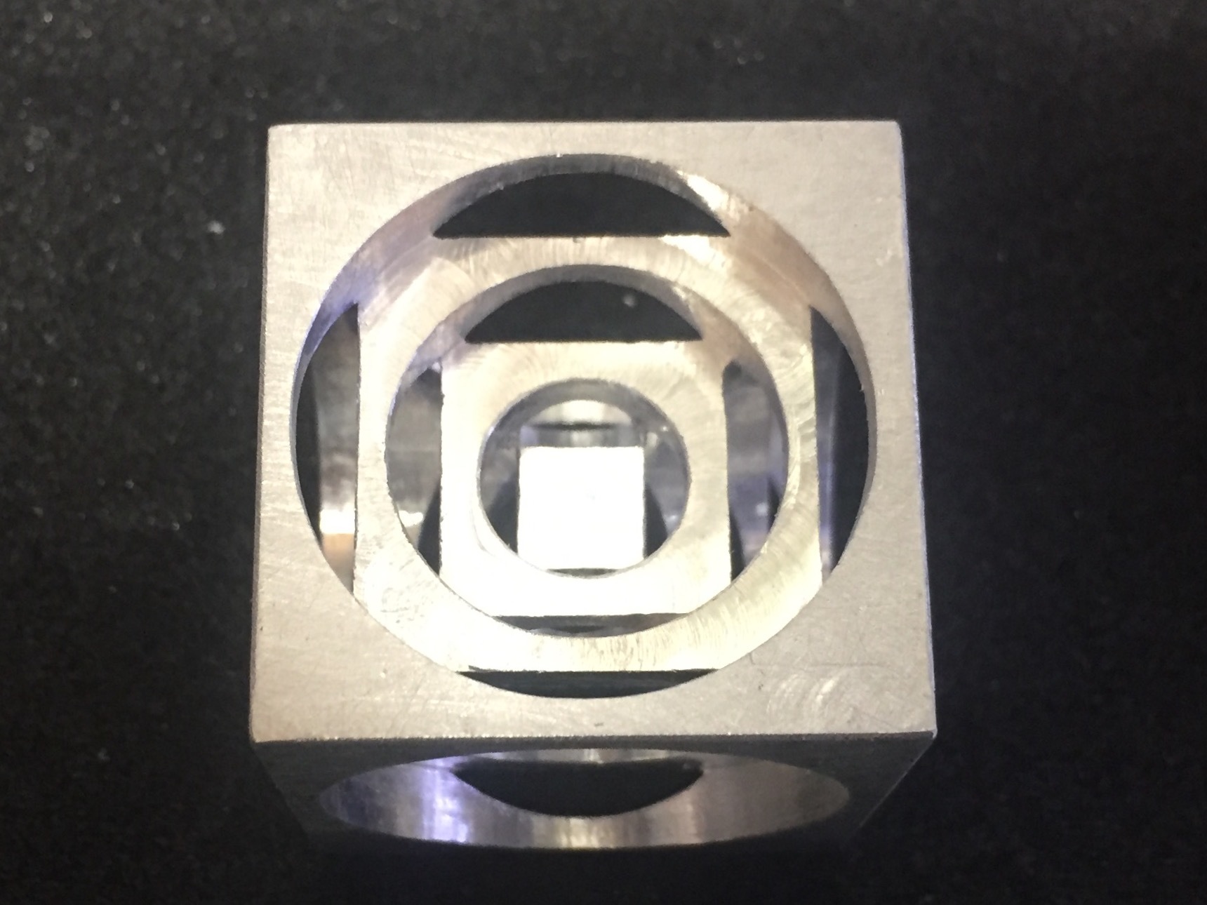

Today’s fun useless project

@RichCournoyer nice turners cube!
