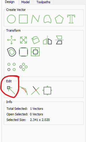

You can covert the text to curves and edit them. I just used a random text but how I did it was to put a circle below the text and dragged the nodes to the circle. Once you have what you are looking for delete the circle or put it on a layer as a reference.
so you made the circle first?
i tried doing this on inkscape but it was messing with the shape of the letters too much
This was done in carbide create. Pick your text and size it for your project. There is an option when you create the text to convert them to curves.
After that draw your circle to get the desired radius. Position it in the center of the “I”
Double click on each letter to select and click edit
Drag the node to the circle. On straight lines you can add additional nodes to create more of a radius if need be.
