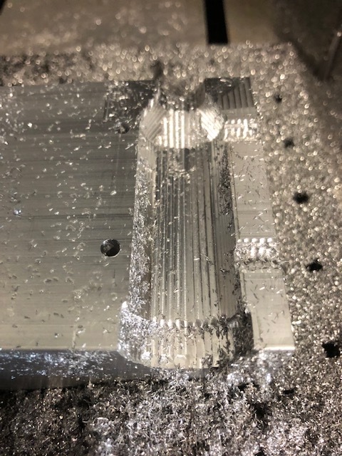

New guy here. I’ve modelled the part below in fusion, saved as stl, imported to Meshcam, done a roughing and 3D finishing pass and the part is not mirror finished, it’s actually quite bad but I know I’ve not set it up properly - still learning (it’s for a two part mold and needs to be a very good finish)
My question is, can Meshcam give me a mirror finish with the right tools and also can the nomad cut a mirror finish - is it within its capabilities? If so, I would appreciate some help in using the correct bits and tool path creation.
Which tools and settings did you use for this cut ?
To optimize finish you will need to look into using finishing passes with ball endmills, not much stock to remove after roughing, and mainly using a tiny stepover, potentially with several finishing passes at an angle from each other. I don’t own MeshCam so I can’t provide more specific advice, I’m sure the Metal Nomaders will chime in.
That looks exactly what I want. I just used 101 and 102 tools but I’m sure they are not the right finishing tools. I’m happy to spend a good amount on tooling, ideally just need someone to tell me what I need and help with tool path creating etc. There is so much info online and it’s quite a challenge picking the bits I need Specifically for specific application.
I would really appreciate if some could take my stl file and create the necessary tool paths and tell me which tools are needed, I can then build on that for my other molds.

parallel finishing was not the best and he used “3D scallop” for best rest. In MeshCam, the closest would be to use the Waterline finishing strategy I think? Out of curiosity I downloaded MeshCam trial version and waterline looks like this:
Your #101 1/8" ball endmill should be just fine for running a finishing toolpaths in your case.
Maybe try something around those guidelines, and report ?
It might be worth generating your tool paths in Fusion to have more control over the finishing pass. I’m sure Vince has better recommendations, but I usually try and remove .05mm for better finish pass. Also air blast would help.

You’ll want to do roughing, semi finishing and a finish pass.
Also a Marvgro pro tip - match your chipload with your stepover. It creates a symmetrical surface, this will create a very good finish.

It looks like your stepover on the finishing path is way too large. For as smooth of finish as possible you’ll want to have your stepover at less than 8% of the tool diameter. That would be my 2 cents…

And to add to this, make sure you properly account for chip thinning (resource 2 that has lots of annoying popups), otherwise you’ll end up rubbing, which will make things worse.
Just to add my 2 cents here, there’s only so far you can get on any machine. Most molds need some level of polishing, very often by hand. Even with a high-end vmc designed for cutting molds. There’s a Facebook group called small scale plastic injection molding (I think that’s it, or something close). They had a thread recently about polishing molds. Didn’t seem too complicated.
