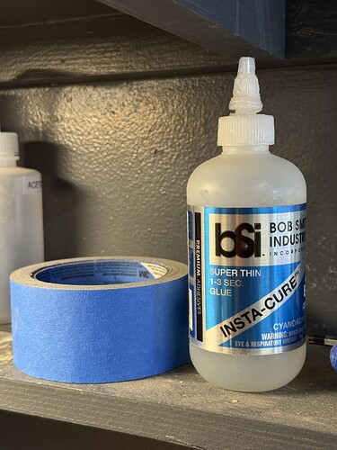

Blue tape and CA have been my go-to for years.
Specifically:
I’ve cut everything from guitar bodies and necks to earrings and gears using glue and tape.
I have both thick and thin CA. I prefer the thin because it sets almost instantly, no messy spray required.
