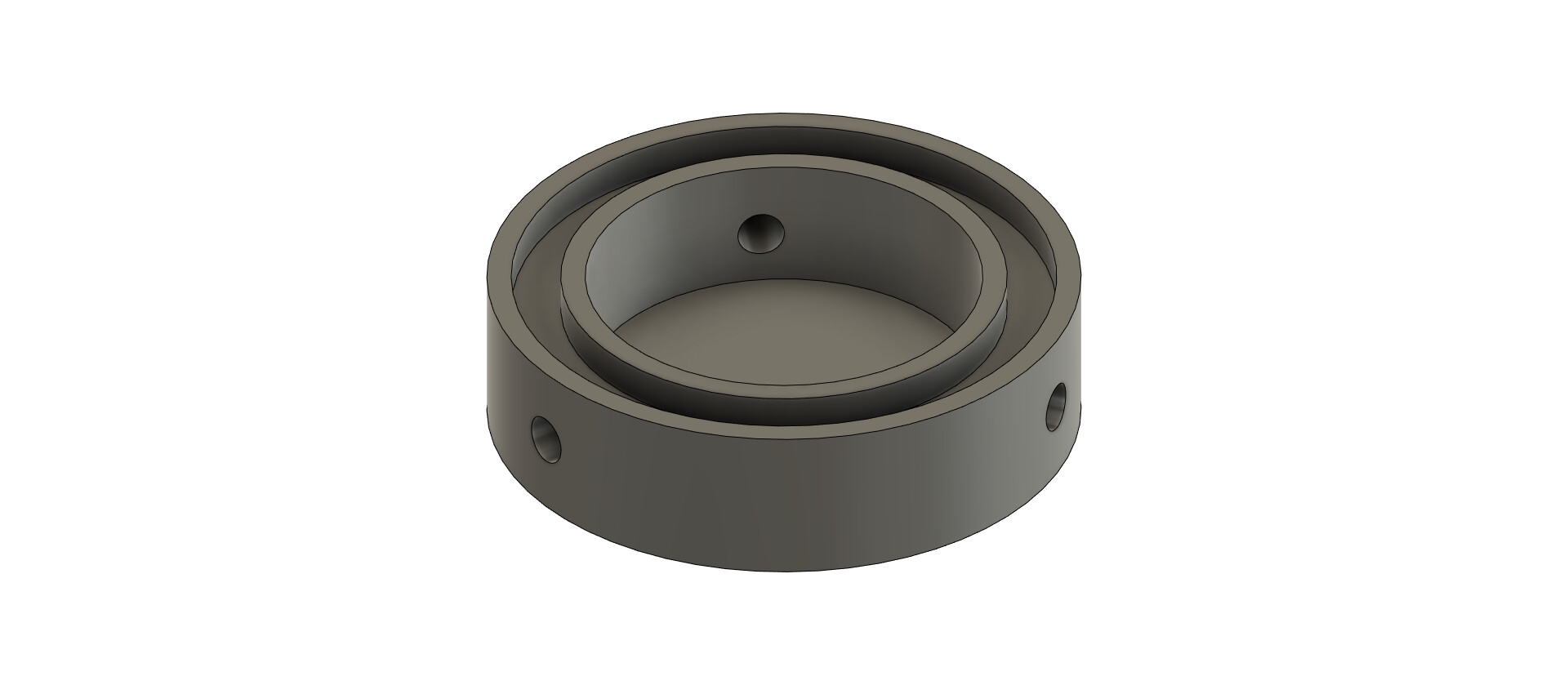

Here is a screen pic of my most recent pod I create on Fusion 360. I don’t use outer tabs for screws/bolts and I’ve decreased the diameter. I drill a center hole (.25") later for the T-bolts. For sure I’ll post here my Fusion 360 file that’s ready to be Sliced in the slicer of your choice. Let me leave you here some features of it so you’ll know it it’s something you want.
After couple prototypes this one is my go to. It’s 3" outer diameter, .8" height. The seal channel takes any common 1/4" x 1/4" foam seal. I use inexpensive material off Amazon that has a peel back on one side; weather seal? The holes are a tapered fit. Tape the holes inside or out as needed. Link the pods in a chain if you want. I use 1/4" tubing. I guess you can use most any 1/4" flexible tubing. I use polyethlene from home depot. I tried several different designs where threaded in some push lok fittings and then tried a couple different dimensions of a tapered hole. It’s seals perfect and detaches easy, no fittings needed.
I move them around to secure my wood for v-carving. But I recently moved to cutting materials as well and it couldn’t be easier. 1 or 2 (or more) under my material inside of my cut path, tape down my tubing if they are rubbing my stock and make the cut.
VacuumPod.stl (93.8 KB)
The .stl file here is straight off Fusion 360. I don’t know why the emblem/icon is a V-Carve image. I don’t use or have V-Carve but they get saved with that image, hum. Anyway, the file goes right to Slicer software from Prusa for me with no problems. I’m sure it will slice on any common 3d printer slicer software. I’ve printed it with PLA and PETG, it won’t matter. I also don’t select “support” in the holes. You’re friend with a 3d printer will know about support material.

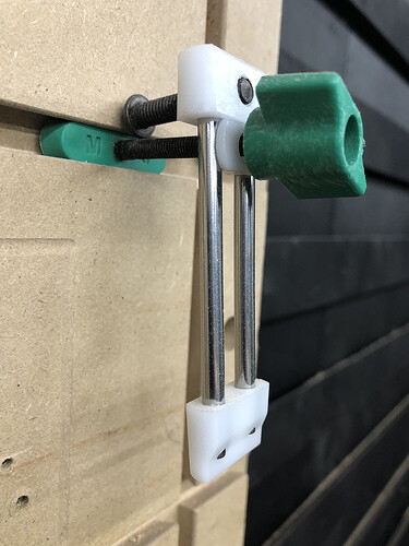

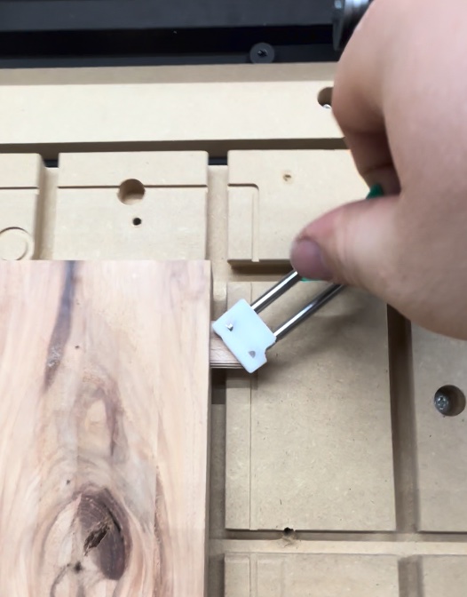

Something that’s worked well for me is a combination of the oops clamps and the Micrjig matchfit system. The standard bolts will reach about 2 inches so you would either need longer hardware to reach the full 3 inches, or something else I’ve done is sink a domino in the side of the workpiece and then clamp to that. Hopefully the photos help you see what I mean.

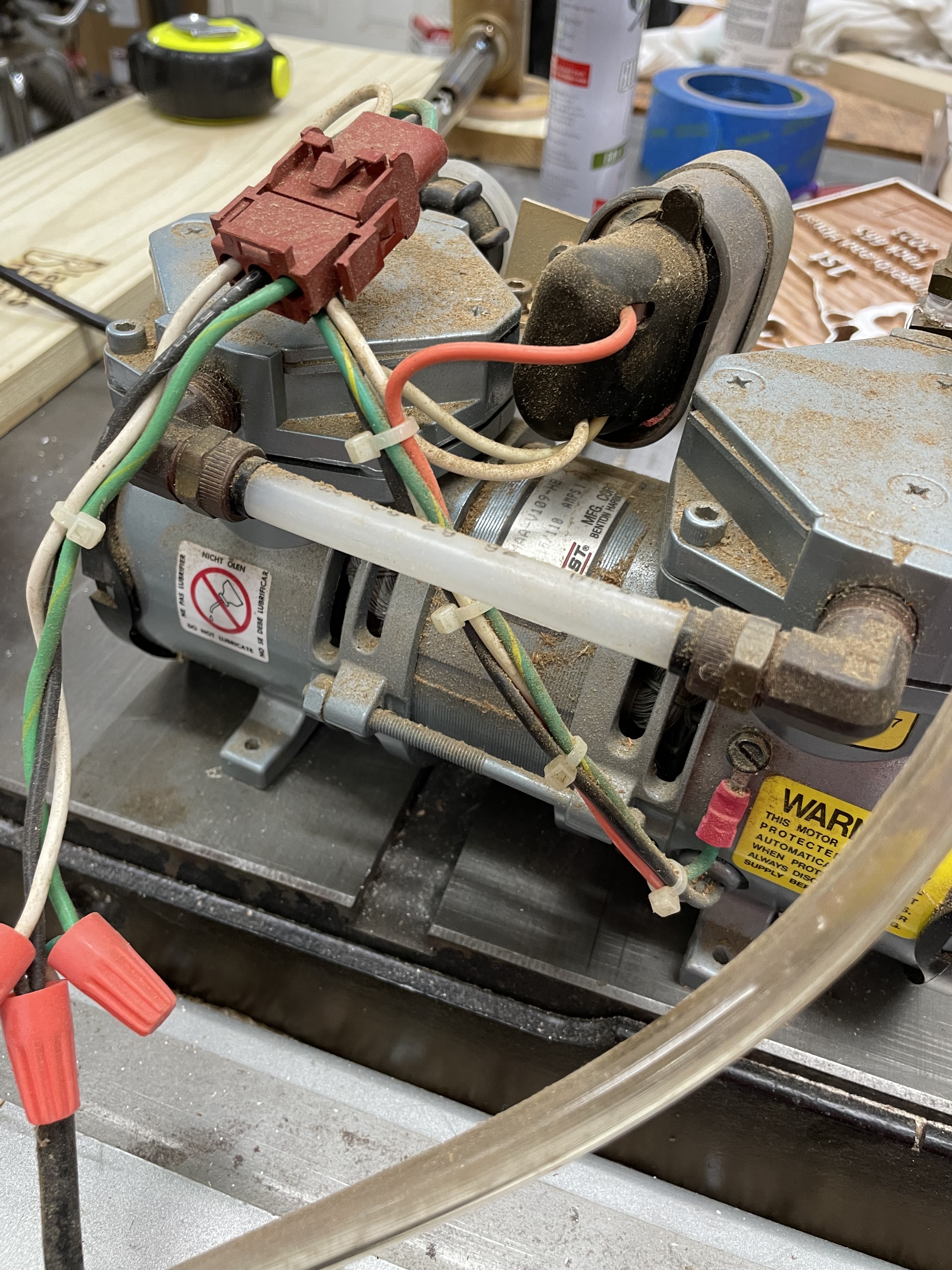

I fired up that pump I mentioned. I wasn’t impressed with the power but I don’t really know what to expect.
I guess this is one of the ones you don’t recommend.
It could be worn. Or the finger test that we all do is not a good representation. When it pulls over a large area. That force is distributed over that area.

I don’t see most using a reservoir tank for vacuum. That way your fixture always sees a more constant vacuum. Its also a good way to test a pump’s capability and allows a less capable pump to work better.
PS. I’ve used an old obsolete 20 lb. propane tank.
That Gast pump ( and that PN# in particular) has plenty of Hg, might lack the cfm to power more then 1 tightly sealed vac pod, might be plenty. It’s a diaphragm pump and won’t product oil smoke, that’s good. Gast pumps last many many hours in lab use. I doubt a woodworker could wear one out.

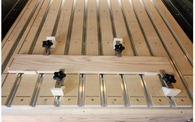

I bought the ones mentioned above and I got tire of messing with the allen wrenches. I wanted to just tie something down without tools. You can see what I did in an article that I wrote about that. Here is a link to what I wrote: HERE
Here is a picture of how it worked out.
I’ve made the holddowns out of Walnut, Ash, and Oak. I would think any hardwood would work.
