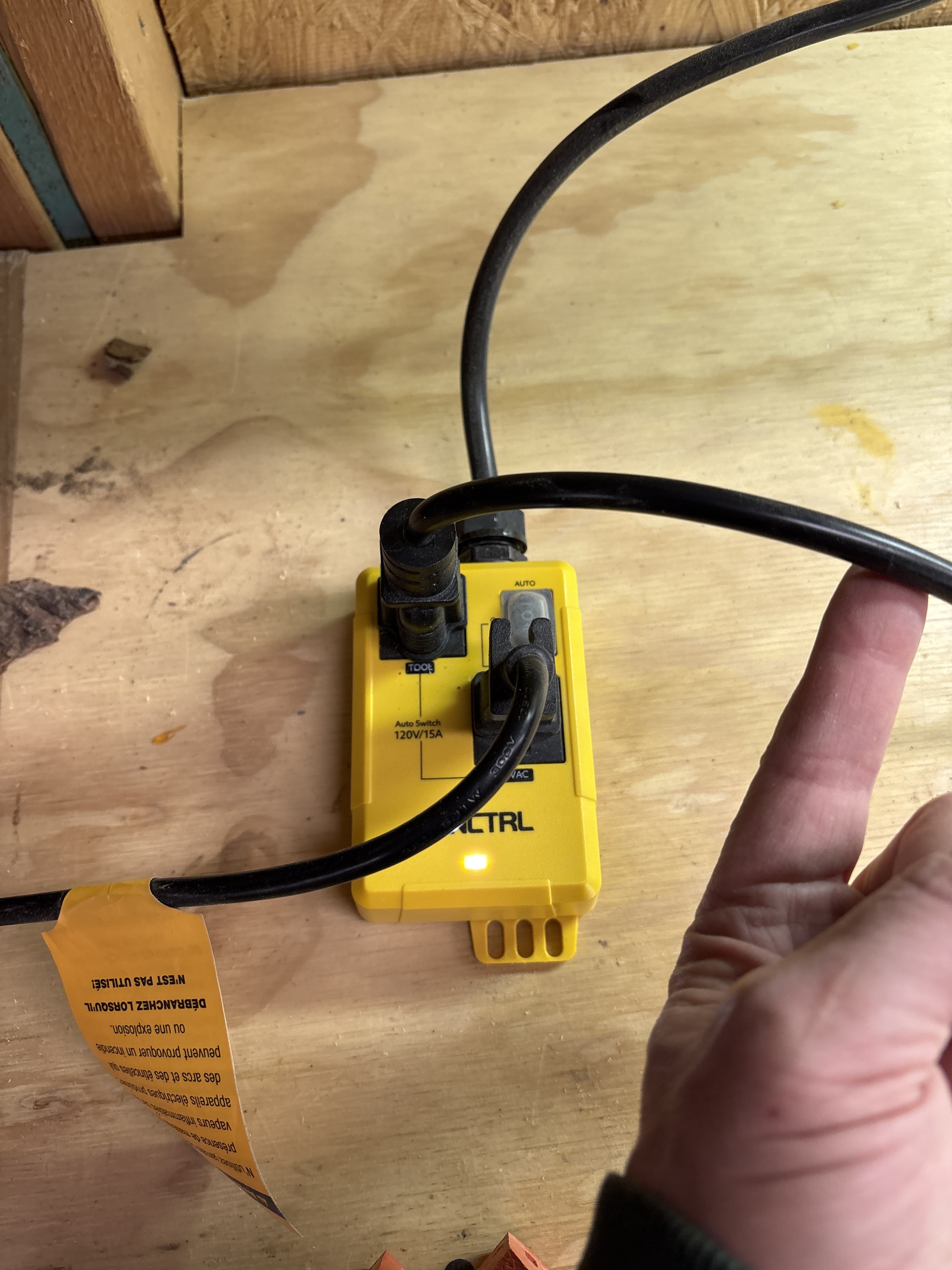

Had a the dewalt stealthsonic with a Home Depot dust stopper pro on my shapeoko 5 pro for almost 2 years now and love it. Have it on a vacuum switch so as soon as the spindle turns on the vacuum turns on. It’s quiet and efficient
This is exactly what I bought, but would you please explain to me how did you connect it to the spindle so it turns on and off with it?
See:
https://carbide3d.com/hub/faq/controlling-a-vacuum-with-your-shapeoko/
Thank you so much William, this is very helpful. You guys are the best. :smiley:

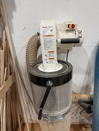

I just use the cheapest grizzly wall mount and split it off with a Y so I can use a separate hose and brush for cleaning up areas of the machine and I have an overhead hose that hangs down to sweepy.

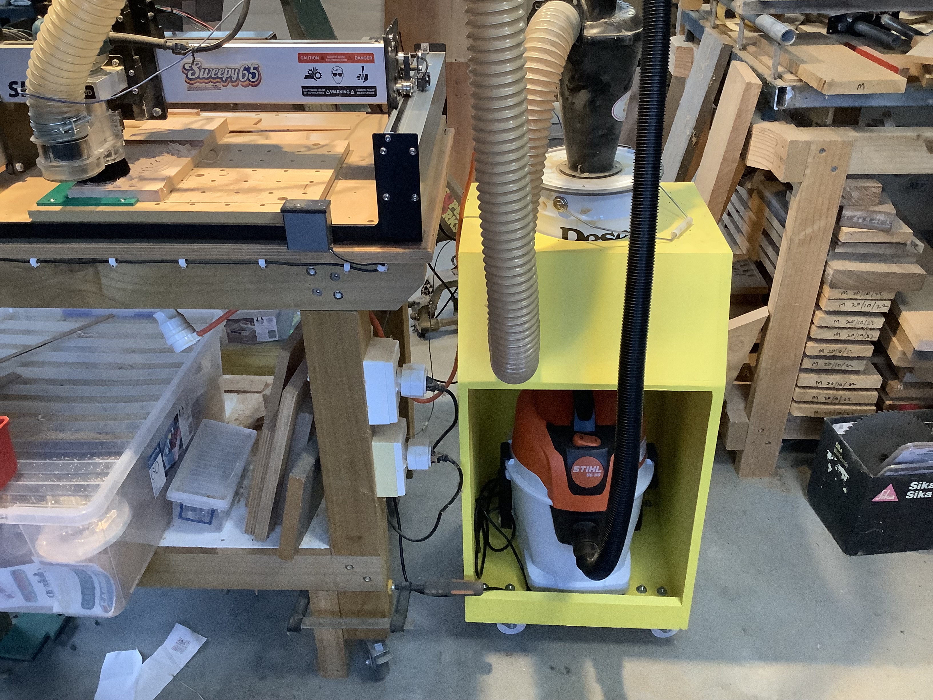

I am finally up and running,thanks to Gary I have done a cabinet of sorts for the vacuum,I can not get the de Walt one where I am,and ended up taking home a Sthil vacuum to try for an hour and wow it has very good suction and is quite compared to my Ryobi,I am surprised.Today I have just finished a 2.5 carving and survived that very well
