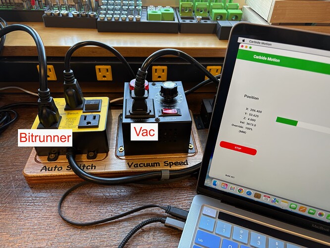

I use the Dewalt Steathsonic 5 gal with the Duststopper Pro. The 5 gal works just fine as the Duststopper gets 99.9% of the dust so the filter bag/filter on the vac stay pretty much new. I see a lot of folks have mentioned similar as a budget friendly/compact setup and would not have duplicated except I have one small modification. Next to the Shapeoko I added the auto switch AND a voltage regulator. For most jobs I only run the vacuum at about 35-40 volts. The vacuum runs super quiet and the exhaust way cooler than when run at full voltage and extended runtimes. This is important in my tiny 12x15 shop. Dust collection with this setup and Sweepy is excellent.
Thank you of r your advice, I set up the DeWalt Steathsonic 12 G, with the Duststopper pro, I also added an auto switch, same brand as yours with only 2 plugs, but the auto switch worked only for the first project, then died, so now I am turning on the vacuum manually when I run my machine. I don’t want to keep purchasing more automatic switches and get again the same problem.

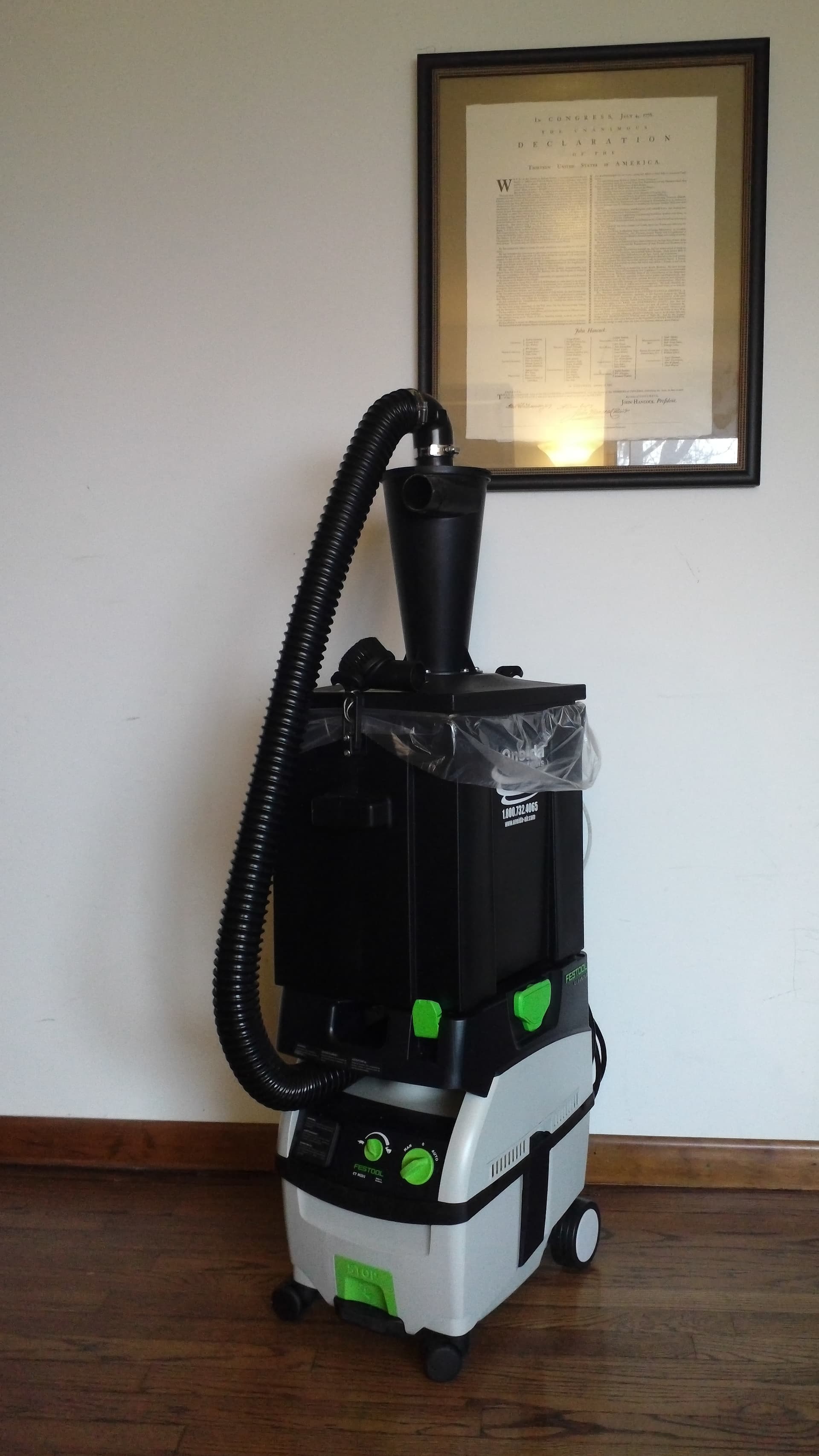

Well, if you’re willing to “buy once, cry once”, I can advocate for a Festool vacuum — esp. if you can find an older model, pre-Bluetooth (or if they are making a low-end model which doesn’t have that feature) — mine just has a selector switch and a speed dial, and when set to “Auto” will turn on automatically when it senses the current draw and arrange for a slight delay so that the vacuum and the spindle spin up separately.
Would you please send me the link or brand name so I can search for a similar one?
I have a Festool CT Midi:
w/ an Oneida Ultimate Dust Deputy:
but the model I have has been updated to:
https://www.festoolusa.com/products/dust-extractors/compact-dust-extractors/578512---ct-midi-i-hepa-us
which adds Bluetooth and so forth, which are all complications I am glad to avoid.
That said, please check w/ the manufacturer of the failed part — they should have a warranty.
