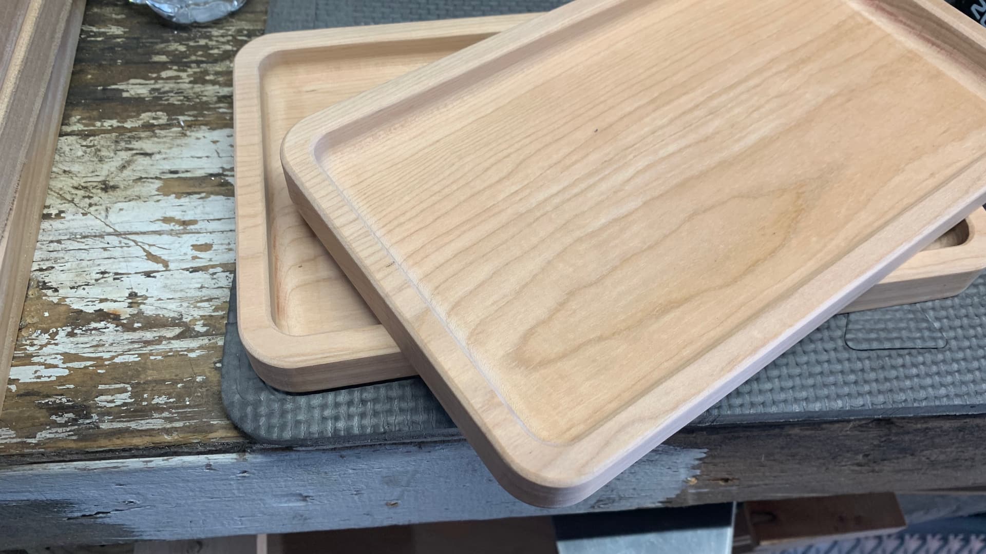

I’ve been making a fair number of trays lately, and have played with bowl bits, round bits, and 1/4" bits. Speed wise the 1/4" can definitely remove the material the most efficiently. My current trays are 3 bits, a 1/4" Compression bit. a Bowl bit to eliminate a lot of sanding, and an 30deg bit for sloped inside walls (a little extra detail)

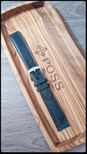

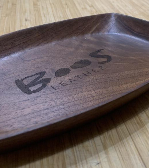

this one was a 3D milling operation (do not recommend if speed is your focus haha)
I used a 2L Inc. 3-flute, 0.25" cutter with a 1.25" cutter length to make a bowl out of ash (which is pretty darn hard). I cut almost the full 1.25" depth interior of a bowl out of a solid piece of 8/4 lumber. Worked well for task bur I’ve only used it for the one bowl so I can’t speak to its longevity. I use 2L end mills for aluminum and those do hold up very well.
The 2L part number is: PWE3-250-1C1.25 which is on their site.
@Dooryard those look great.
