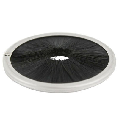

However: there is one thing: the spindle mounted dust shoe closes the system to the top, there is no way air can enter the suction space.
That is different with a Z-independent system. The bit / collet nut / spindle-unit dives through the upper closure, the acrylic “collar”. PwnCNC offer different diameters. The wide one is wide enough that the spindle easily can pass for bit setting and to dive into thick stock. Then the “roof” of the sucking space is tight enough that the air only enters through the curtain, and can be caught with the exhaust. BUT! with the bit / collet nut barely diving deep during the first rounds that opening is very wide, so that air enters through the roof of the sucking space, rather pushing chips to the ground instead of catching it to the exhaust. I hope I could explain what I mean. It does not help that the spindle -or router, they do it the same way- blows its air downwards, so that the chips are pushed to the curtain from the inside, and if the air that is sucked towards the exhaust is not strong enough there because the most air comes from the ceiling the chips stay where they are, in the cut or on the stock.
I think the suction of the vacuum is ok, I am as happy as I could be with that combo as you describe it. I am not sure whether the spindle air blow is to blame for the poor performance, since trying to replace my spindle with a water cooled is too much money and work for me, and I am also convinced that the effect of the poor tightening of the “roof” of the sucking space has the most effect on the not really convincing system for thick stock.
To be clear: for cuts where one can use the smaller roof opening for stock not that thick, up to 1/2-3/4", the whole thing works like a charm. So the boot system is just fine. If one could invent a kind of a variable top opening towards the spindle: lets see it. I think of a kind of a circular brush construction or a elastic kind of a silicone collar or something like that.

I think of something like that:
don’t know where to get.
Maybe here:
or
The problem is that those sell in bulk on most websites.
Bryan, a neighbor had a dust system for concrete drilling what he, retired contractor, does not need any more so I took out the circular brush, 7cm in diameter, and glued it onto the acrylic piece of the dust shoe:
https://photos.app.goo.gl/f75ot7jpV2WYuiyf7
So works fine, the spindle can dive deep for pin measurement, and the brush keeps secondary air out. As you can see in the project image the chips are removed nicely. (the idea to make an end grain cutting board with just a horse head appears not the best choice at Saratoga Springs aka Race City at a second thought… :slight_smile: )
Oh wow, thank you very much for the information, guess I’m gonna end adapting this solution :slight_smile:
