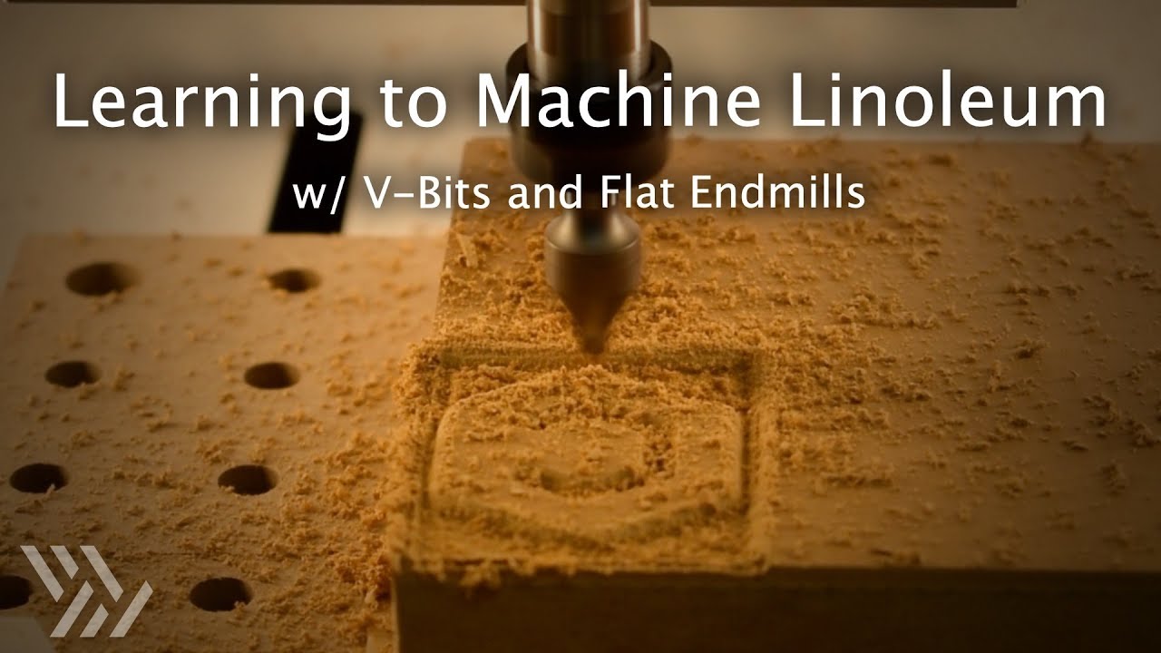

Rubber can be difficult to cut (folks have mentioned freezing it and keeping it cold with dry ice while cutting) — perhaps a linoleum block?
Oh…continue please about this linoleum block
70ipm, 70 plunge rate, .03 doc [Redirecting...]
Carbide 3D Shapeoko 3 (Linoleum)
  • DOC: 0.76 mm
  • RPM: 17000 (Dial setting: Dewalt: 1, Makita: 2.75)
  • Tool: 1/4" #201 square or #202 ball
  • Feed: 1905 mm/min
  • Plunge: 889 mm/min
