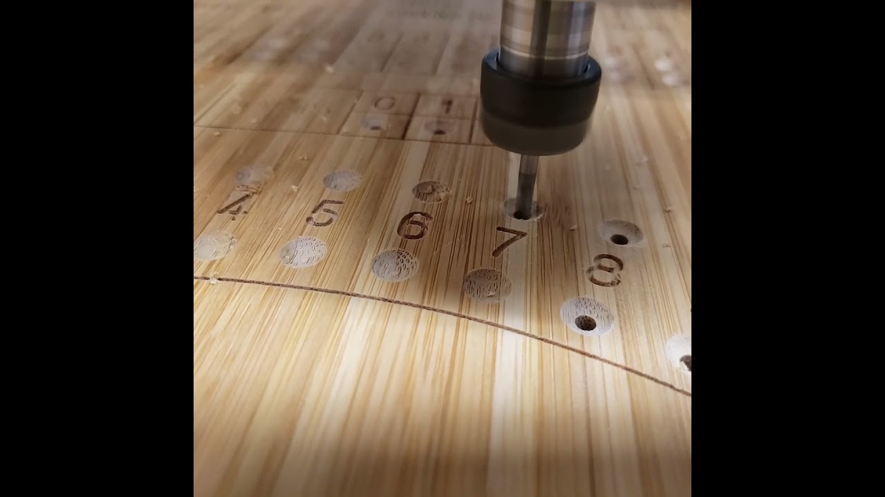

I tried something similar a few years ago. My conclusion was that running a little hot on RPMs isn’t a big deal as long as you don’t stop moving. Peck drilling isn’t a bad idea either.
Here’s peck drilling with a 0.125" carbide PC Board drill into bamboo.
